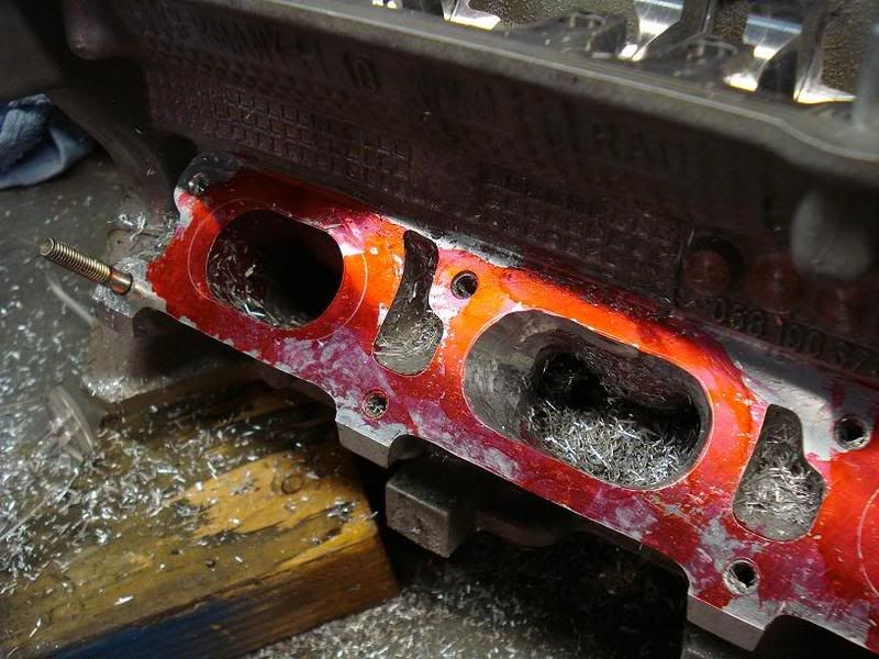

be VERY careful rob when doing this.
see this for notes as to why: http://badger-5.com/bin/5v-installation-note-supertech.pdf

No worries Alex, hope all went well. Just doing the exhaust as they are an identified weak point, if I'm pulling it all apart I might as well eliminate another weakness. Porting will be very mild, just cleaning up really but want to port-match to the SEM for a cleaner flow into the port.
http://i17.photobucket.com/albums/b99/infinityman/porthead6.jpg
