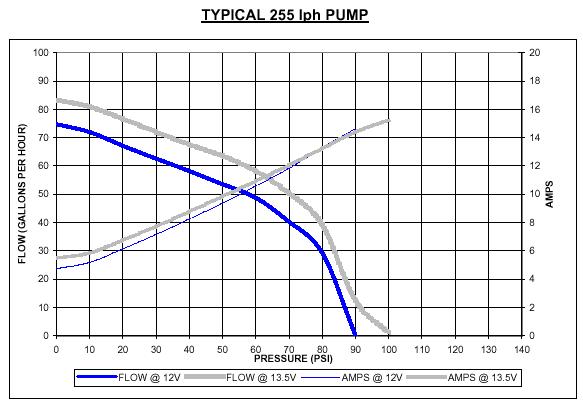

Fuel dellivery curves for pumps are pressure vs flow. With an inline you'll roughly split the pressure evenly between the pumps if the pumps have the same rating. If the inline is higher rated, it'll take on more of the pressure load.
Look at the graph below, and look at fuel delivery at 1.5 bar vs fuel delivery at 3 bar. Your car is running fuel pressure at fpr+boost, so 5-6 bar. Look at the difference in flow between 5 bar and 2.5 (72.5bl vs 36.25lb). Huge isn't it.
Now you need 132l/hr (550cc*60*4) if your injectors are flat out, so if your in tank pump provides no pressure, the lower spec walbro pump at 6 bar will still flow enough.
Unfortunately for me at 6 bar and 152l/hr requirement, its decidedly marhginal hence why I now have 1 in tank and 1 in line 255l/h pumps.

Hi John, thanks for the info. I can't see that graph as I'm on my iPhone, I'll sign in again later.
EDIT: Hehe... i went and got my laptop and i still cant see it. Can anyone else see that, is it just me?
