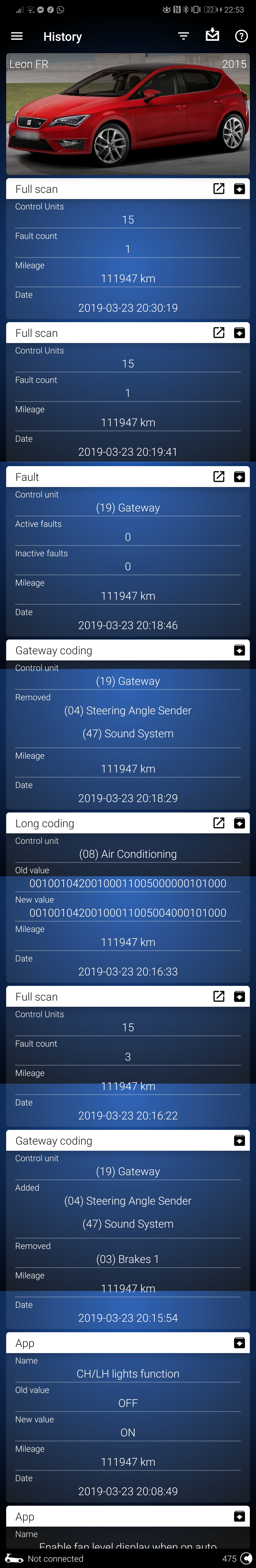

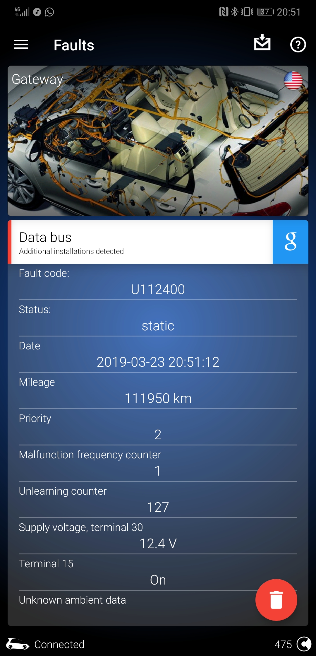

Does anyone know how I can sort this fault (U112400)?
Deleted member 103408
Have you made any changes to the car or the control units on your car.
Also did you add or take out any control units from the list that OBD11 Showed.
You should be able to see this in your history file.
if you go to the upside down triangle at the top of the screen you can filter the output to Gateway Coding.
Looking at the above you appear to have deleted 03 Brakes which I certainly have on my car so add that back in and if that does not work you can do the filter as above.

Myles Ackland
Mar 23, 2019
South West
Yes it was the brakes, didn't see I had removed them. You are a legend. Thanks mate
