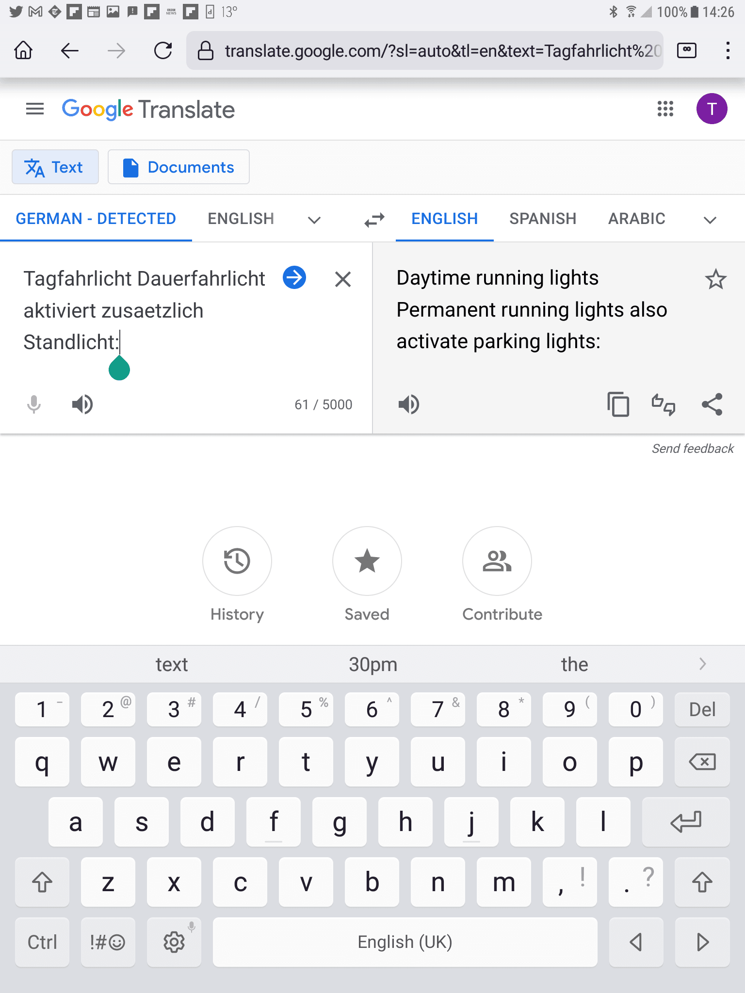

daft question what are coast to coast lights ?
Its just the rear LED taillight bar. Correct me if I'm wrong but I understand as standard the full rear LED will only illuminate end to end when the main headlights are also switched on / when the car is locked/unlocked. Otherwise if its just the DRLs on then the rear taillight LED is switched off. Was asking if its possible to use OBDEleven to force the rear light bar to be always on (so you can have the rear LED illuminated even during the day with just DRLs on).
Alex_gregory_uk
Magnetic Tech Grey Cupra Formentor V2 Manual
Mar 14, 2015
40
14
York
It is possible and I've enabled it using OBDEleven. Rear light bar is on all the time now. It's called Scandanavian DRL in OBDEleven.
