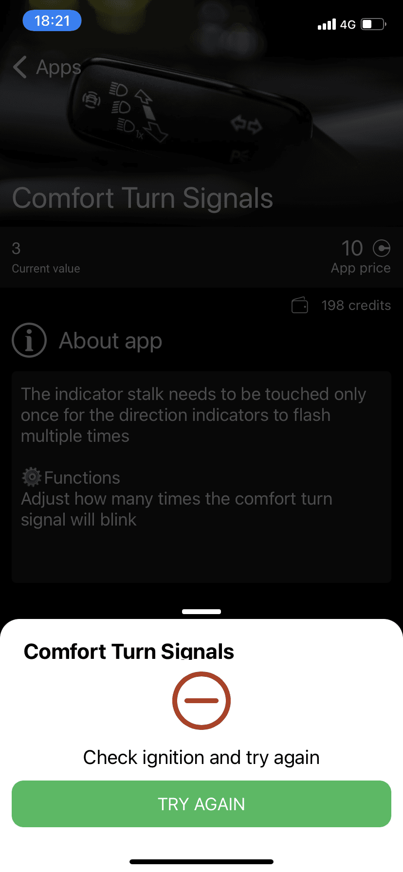

I got this error message.
Anyone knows why?
Tell
Full Member
this app was created by a cupra leon owner, comfort turn indicator on the seat leon cannot be changed in any way. if you want I'll tell you where you can find and modify them by hand without using the app ... but you won't be able to modify it anyway
