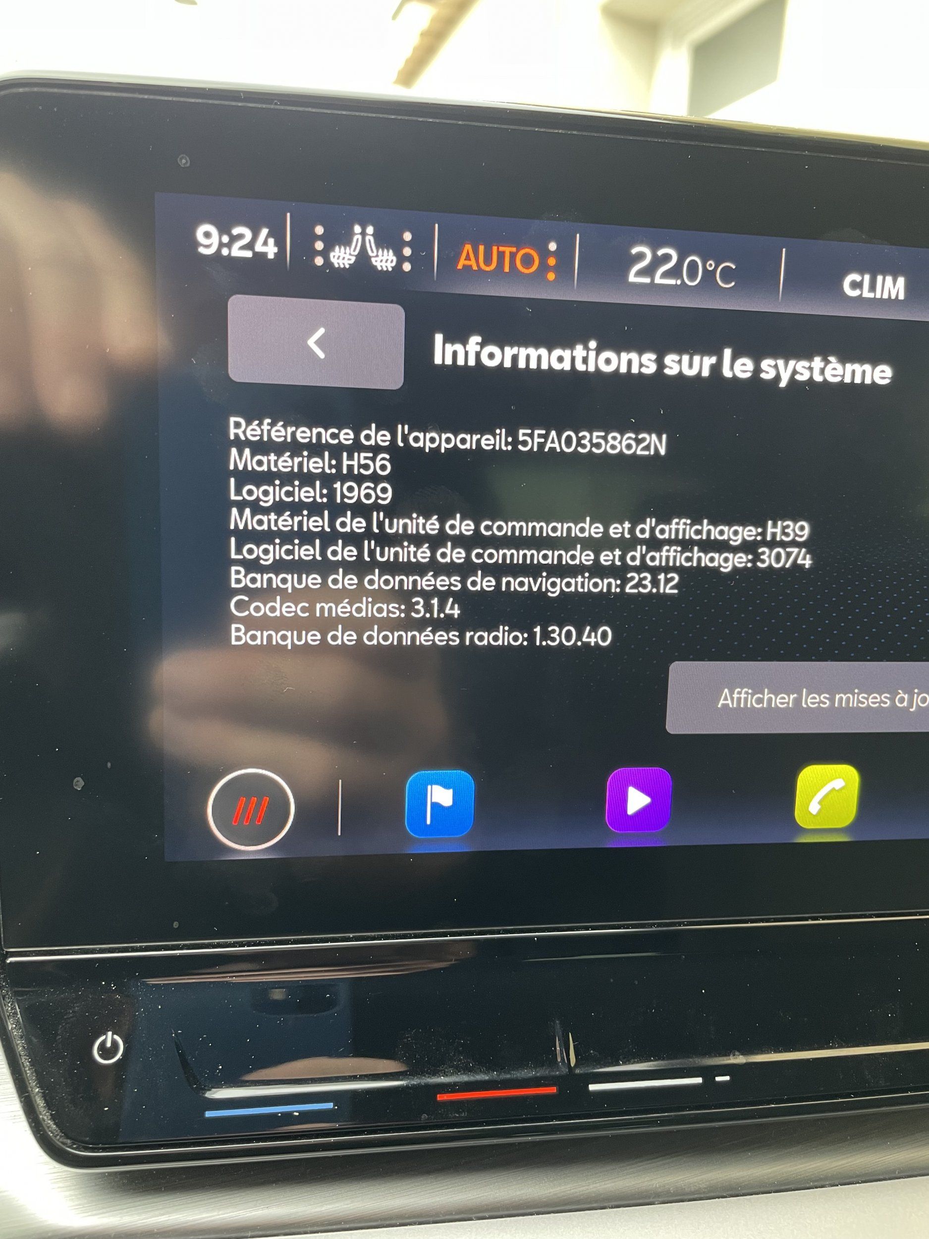

Wonderfull, thirst update to 1899 is done...next step is 1969 now...
Thank you to everyone who answer to my questions....👍
Reactions: barry7377
Herencia
Feb 10, 2024
And it's done....😁

Feb 26, 2024
how do i go about updating my software? ive connected to Home wifi and phone hotspot but no updates appear. Thanks
Device part number: 5FA035862K
Hardware:H56
Software:A896
Display unit/control panel hardware:H39
Display unit/control panel software:3074
