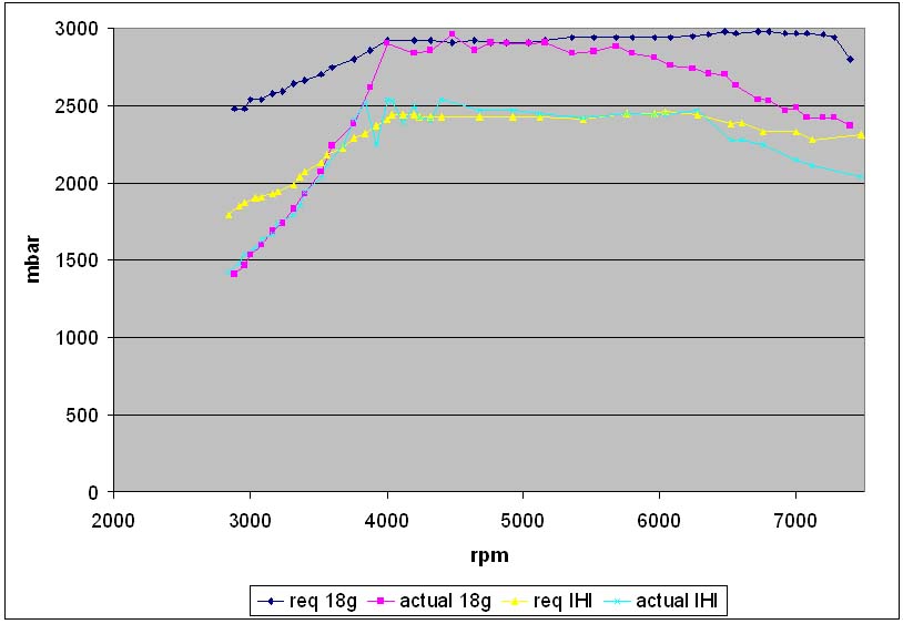

3rd gear boost log from mine. The turbo is flat out (well 95% duty cycle from 6000rpm on.

drops to 1.5bar max'd boost from just over 6500rpm.
Is your scaling on the graph manual or are you getting the 3000mbar out of logged scaling.
How does your 18g compare to the VF34 previous?

The scaling on the graph is a calc. But It ties up with the boost guage, and at tickover I'm seing 820mbar vs 1000mbar on same day. Makes max reading about 3100 on new map. Boost guage on higher boost just about pegs the 30psi guage and nearly pegs the map sensor, so it all ties up.
It drops to 1.7 bar at 6500 and 1.5 bar at 7000. Holds better in higher gears. Will hold 1.7bar at 7000 in 4th.. In 3rd, the wastegate just can't close fast enough to spin the turbo up.
I've updated the graph above with IHI lines (done in 4th)
I was getting 245g/s peak from the IHI and I'm seeing a little over 300g/s with the 18G. There is a bit more in the turbo, as when we let it go to 100% duty cycle, we saw 10-15g/s more of air. It's now limited to 95% in the upper rev range. You know my history with IHI's bill.
