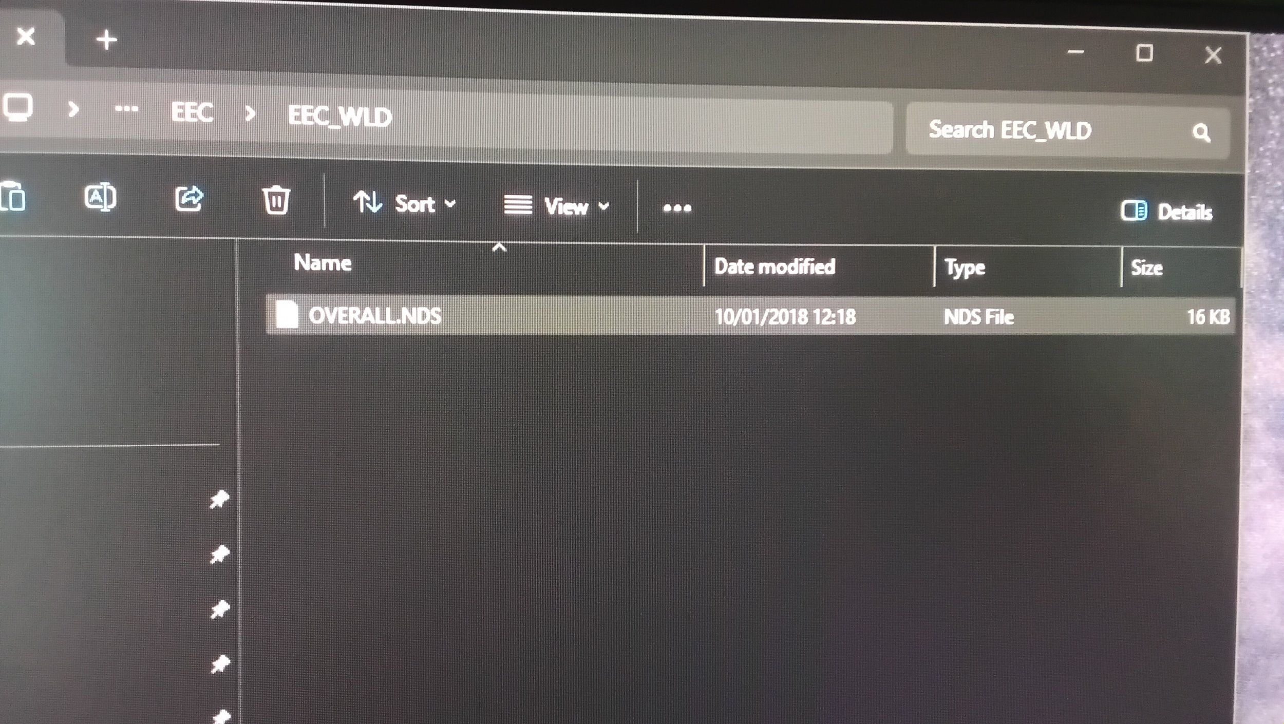

The guidance is in the map resource here. People manage to get files and directories confused. I've seen that. So on that overall.nds file copy they wack the other file in the EEC_WLD directory then it doesn't work.
I keep a proforma so it's just copy and paste, left to right on it. Profile of the copy from. Makes it easy. No note searching. You just follow the directories down.
\Arona - Satnav Files\Original File Fragment To Copy (V7) (1030)\EEC\EEC_WLD
How I do it. Not drag and drop but copy and paste from the file fragment held under Maps.. blah... blah

you use the trick with the nds?
I think i have something for you
Hi, yes, got the 2210 maps back working, so the card is OK.
Downloaded both bundles DL2 and DL3, as I want Germany included, and swapped the overall.NDS file from my working 2210 maps, still using the genuine SEAT card, and both DL2 and DL3 immediately come up as navigation database unavailable.
You have something for me? I'm intrigued....:)

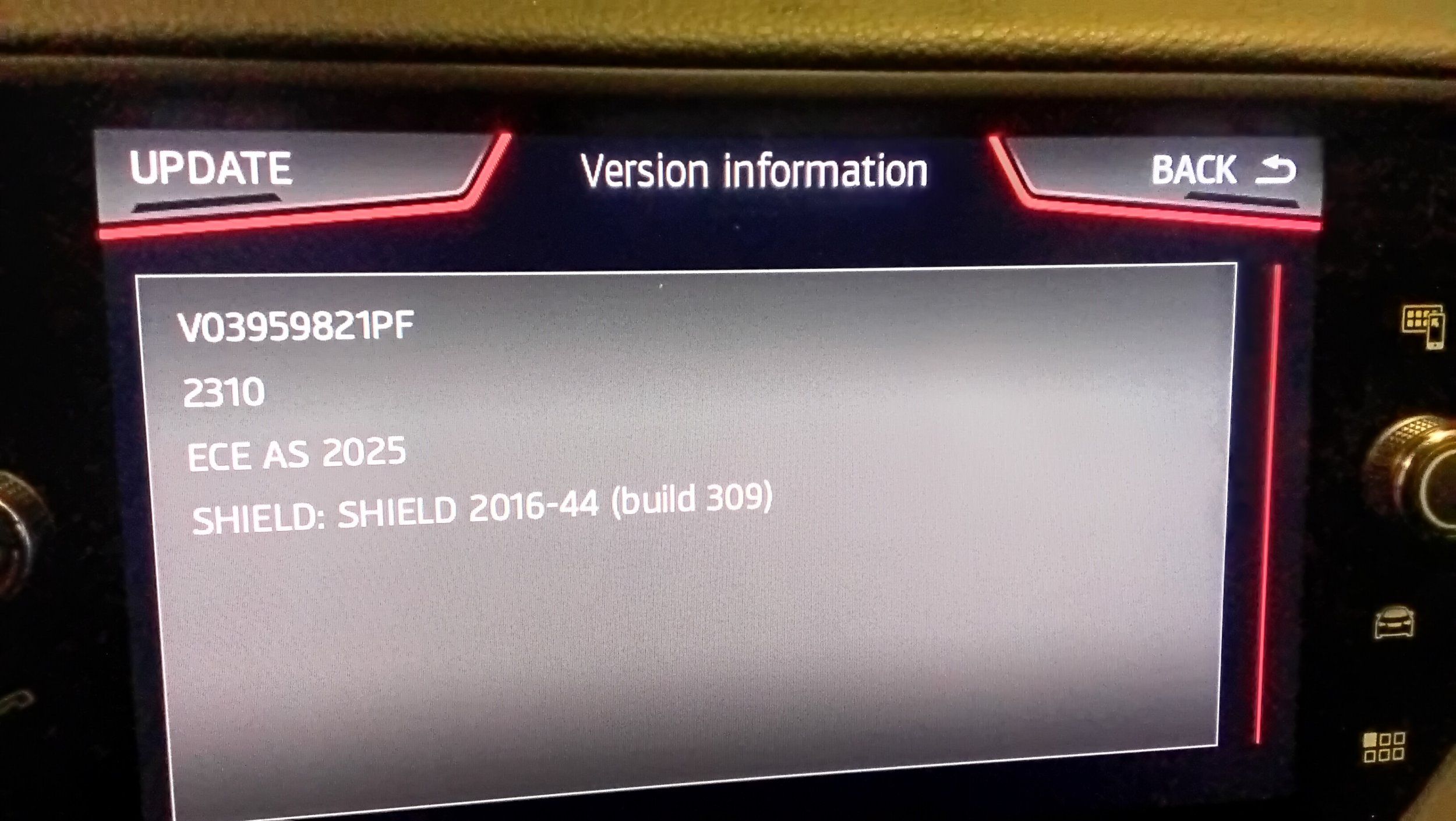

The all Europe success screen with the ndr workaround
Same TomTom cartography. I recognise what I've put on HereMaps and what I got TomTom to put on. So yes updated TomTom cartography but isn't HereMaps so no chance off Inrix TMC without old maps. Pulling the card back out 🤣. You have the choice in the UK of working TMC on the mib2 standard with old maps, or new maps but no TMC.
Hmm are speed signs left out ?. It's happened before. In the UK we lost the top speed once. Then we had trailer speeds were shown all the time... with no trailor 🤣. The mib2 standard isn't a finished product. Mib2 high was always better. So yes sticking to the old HereMaps originated one with the Inrix mod as per the resource link.
Everything you needed to know or didn't need to know is in the resource including the Inrix fix for TMC on old maps, the NDS work around etc:

OK finally, I have working 2310 maps......DL2 version because I wanted Germany included. Not been out on the road yet to see about speed limit signs, the rain is biblical out there and I ain't getting soaked again - already had a soaking out with the dogs earlier!
Thanks to all for your help
