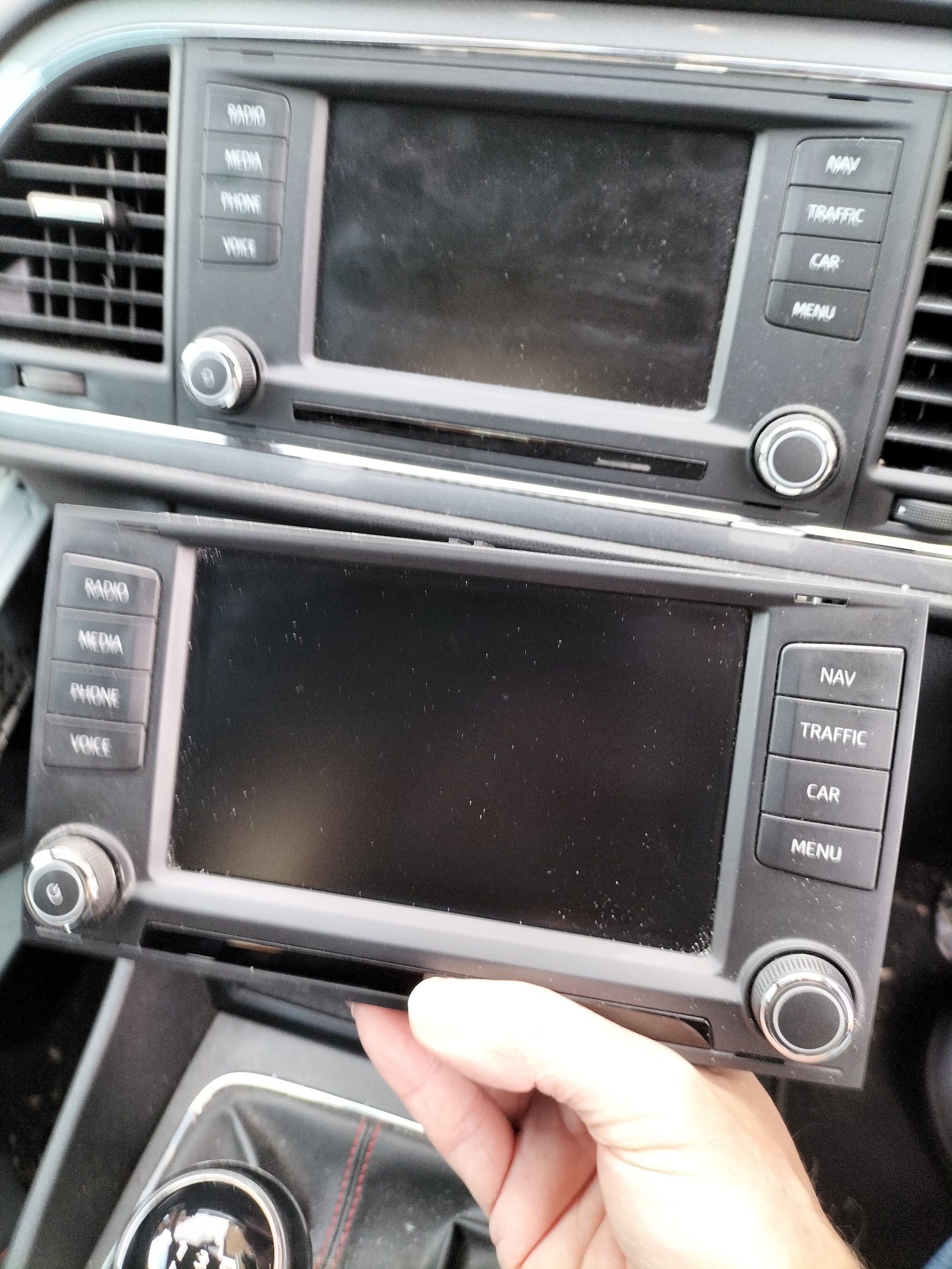

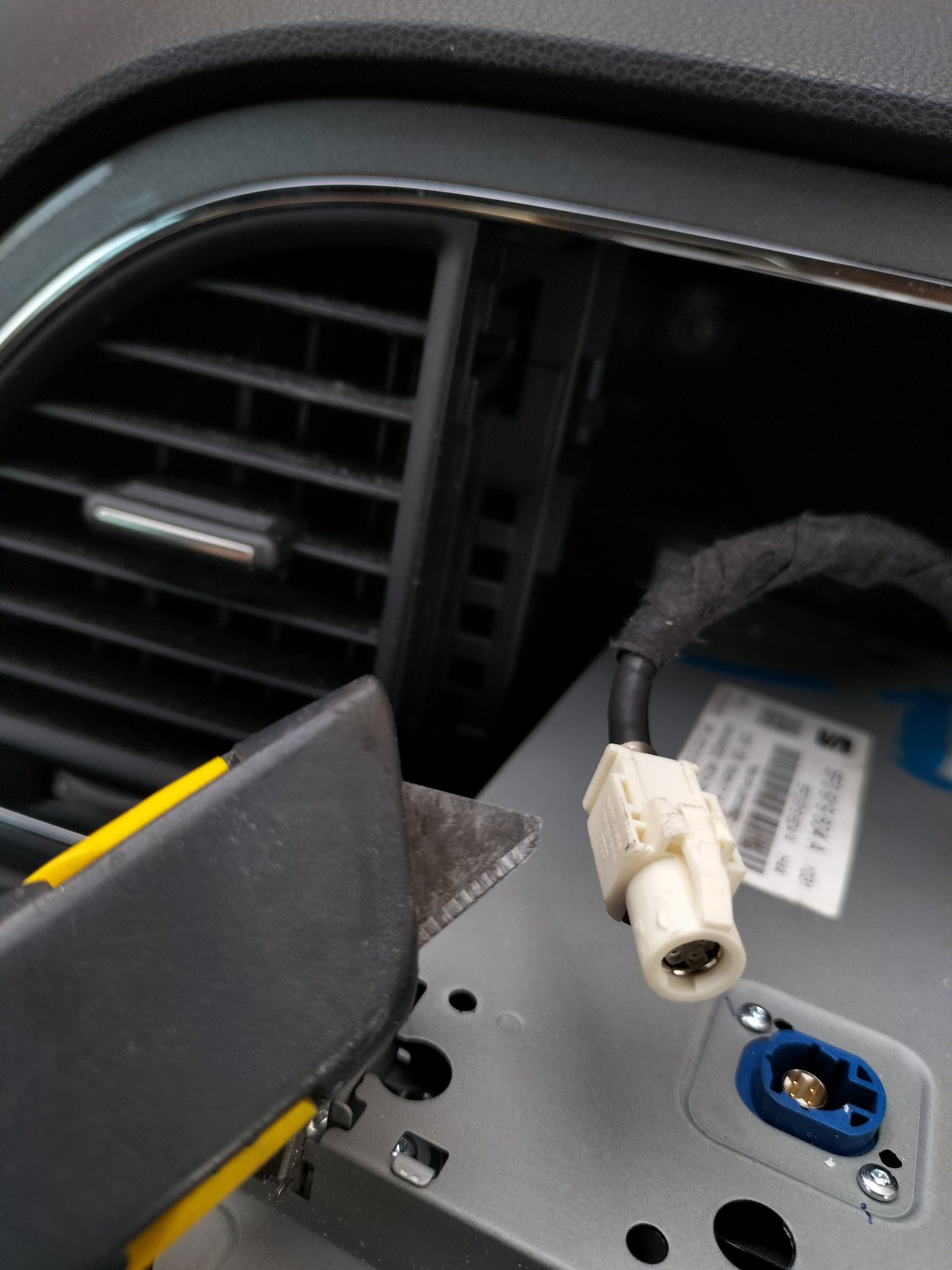

Some pictures from the hardware installation (the easy bit!)..

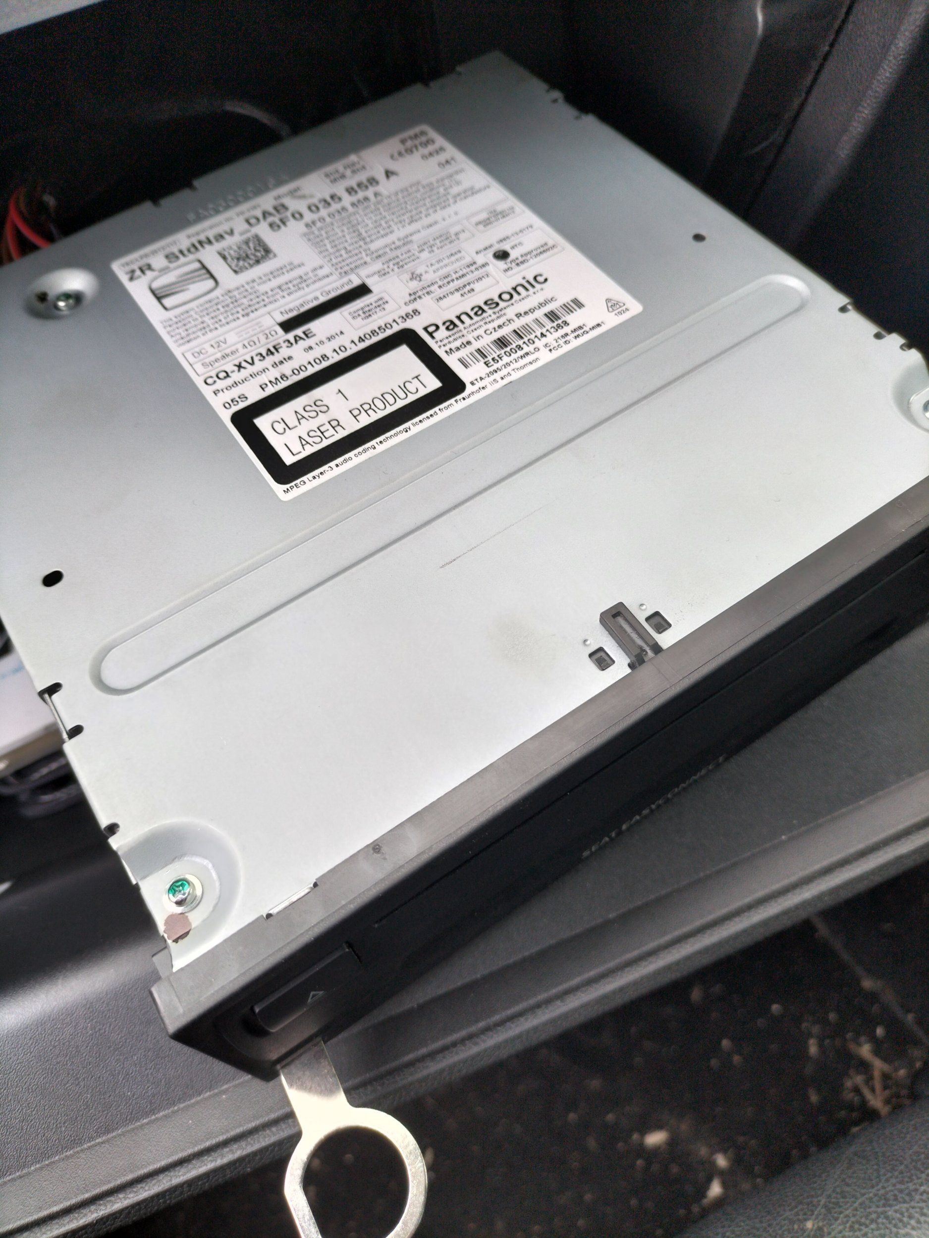

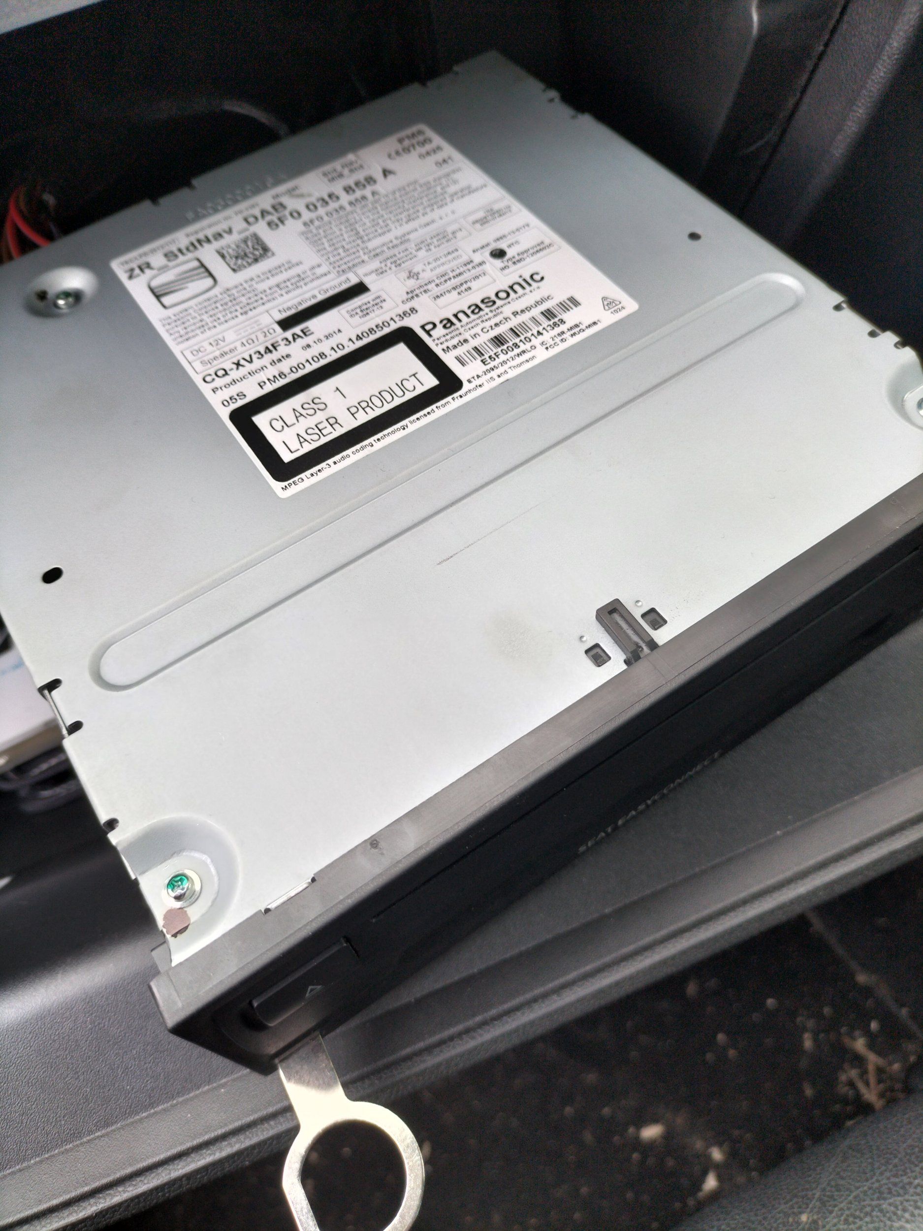

First of all the MIB1 glove box head unit - straight/easy swap for the MIB2 unit, though have to say the cheap ebay keys were a bit rubbish (just about good enough to get it out):

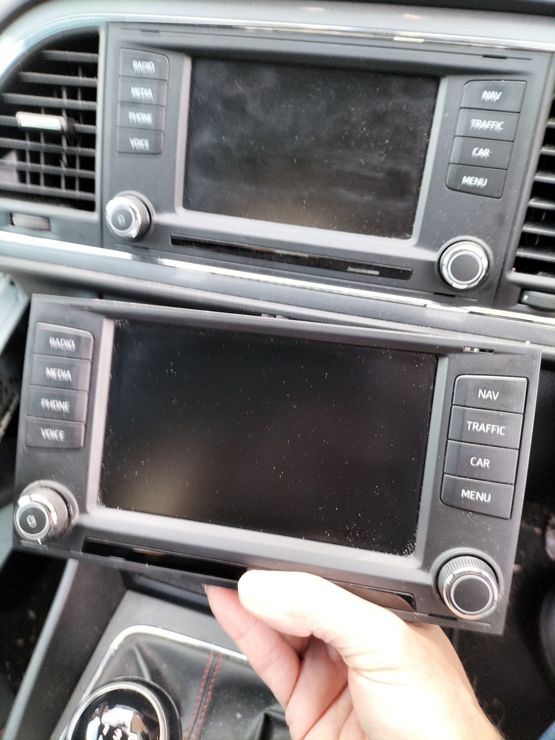

Then the new salvage screen; despite the photo it's only a bit bigger than the MIB1 screen (perspective!):
(8inch salvage screens still going for silly money so that will have to wait)
Screen came out with just the keys again - bit fiddly due to the cheap ebay tools again, but there's no need to unscrew any bolts or remove any trim.

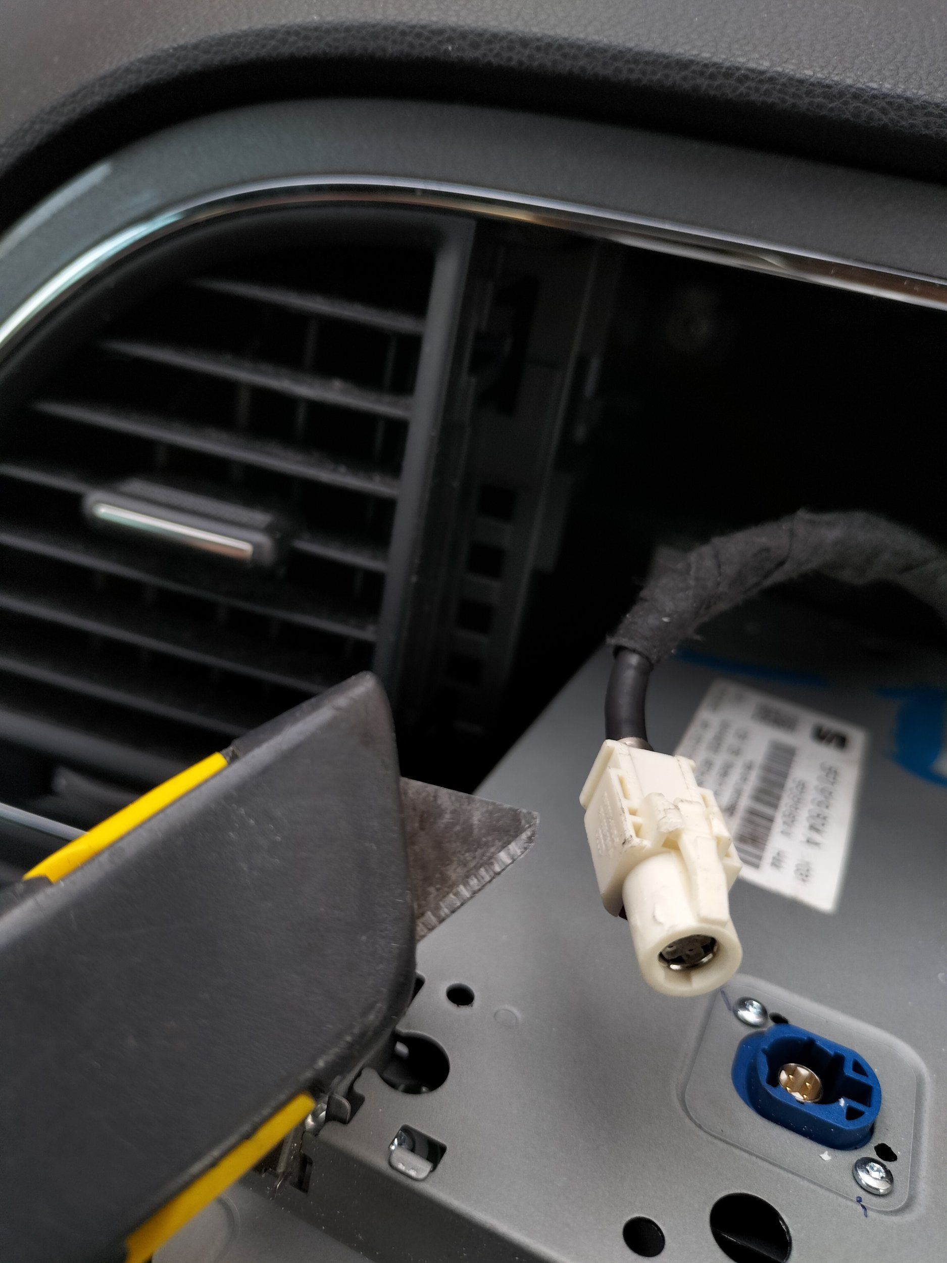

The only real problem with the screen hardware install is one of the MIB1 connectors at the back doesn't fit into a MIB2 screen without some hacking away of a few small plastic ridges ('keys') around the barrel - the light MIB1 connector was thus 'shaved' with a stanley knife until it looked like this:
Then, with connections mated, the new screen and glove box unit just push back in - easy peasy.

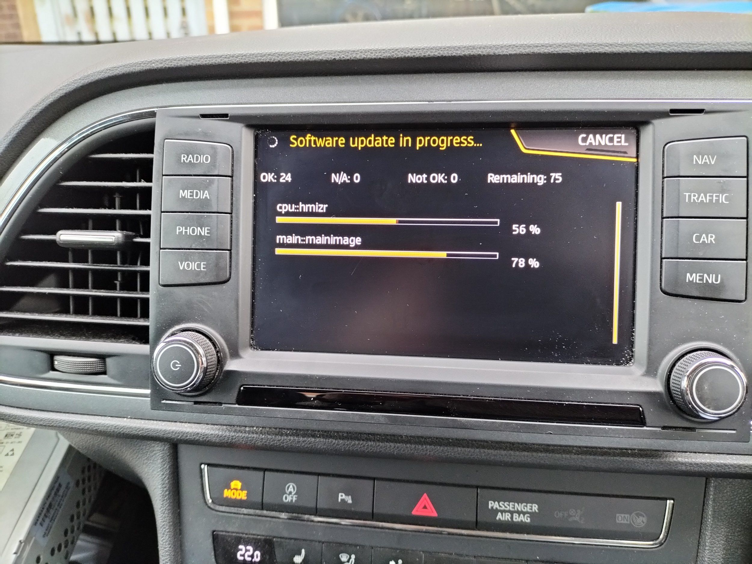

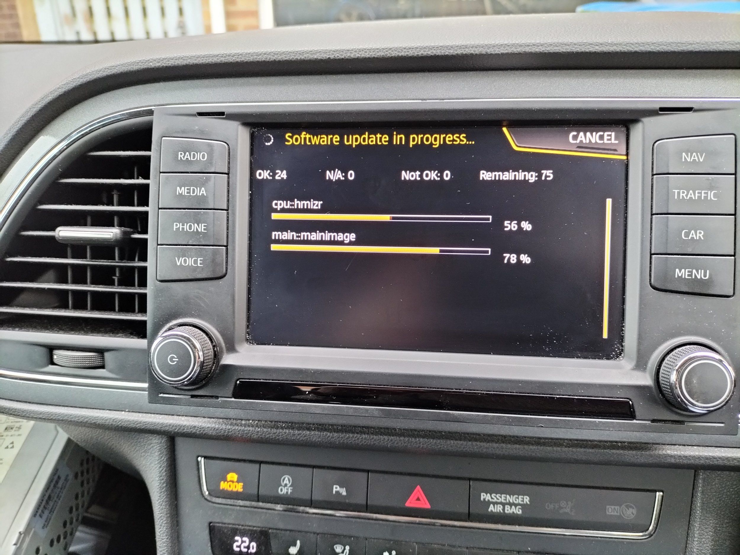

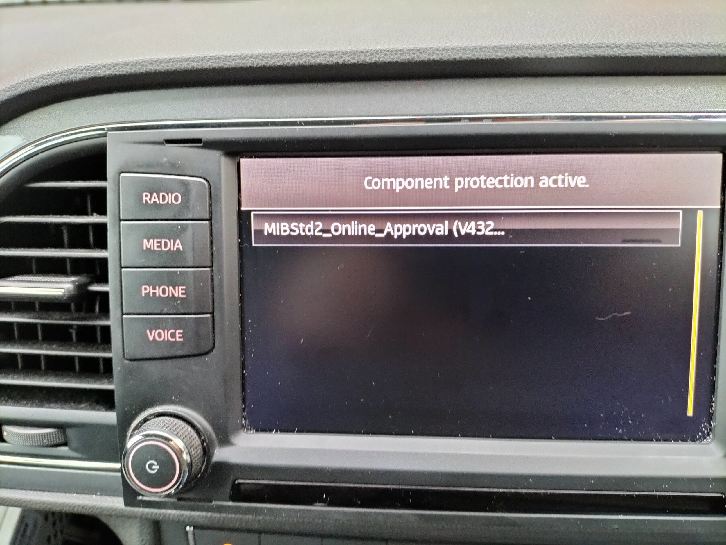

Then I updated the firmware from 0359 to the latest available for this hardware (0369) via SDCard (I had to use 16GB formatted to FAT32 with 4kb clusters as a larger 32GB card didn't work). This took about 20 minutes:

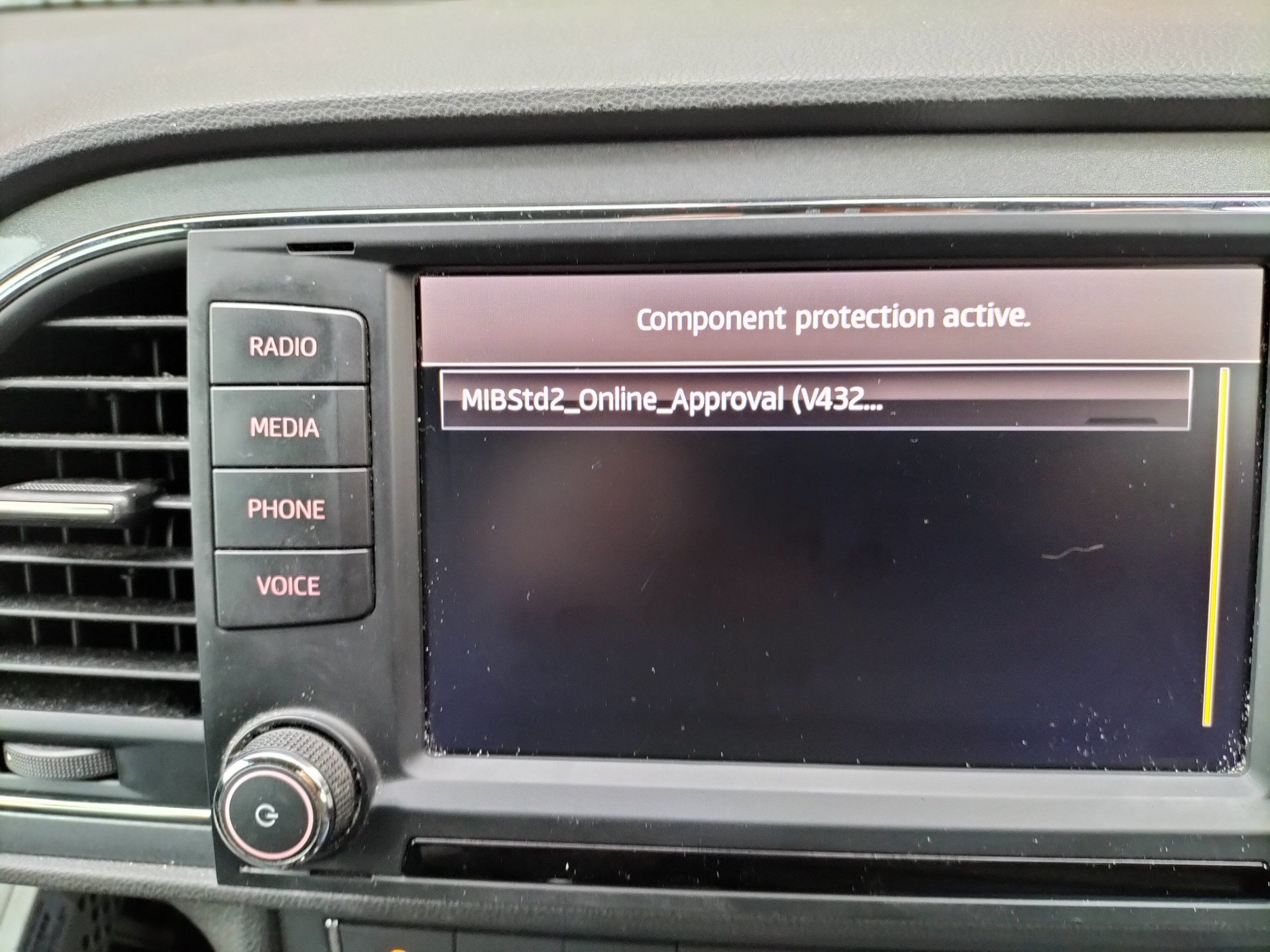

Then an SDCard patch on top removed component protection and enabled some (but not all) features (no green engineering menu or ODB tools required at this point):
The patch (SE_ZR_P0369T_FEC_ALL_CID_OFF_CP_OFF_SPORT_FIXED.7z) allowed any SDCard navigation maps to work so I downloaded the latest West EU MIB2 maps and they were accepted immediately (DiscoverMedia2_EU1_2110_V18.7z). The map software is still nowhere near as user friendly as Google or Waze but at least they are almost up-to-date rather than stuck in 2015 and can be used as backup for phone network failure!

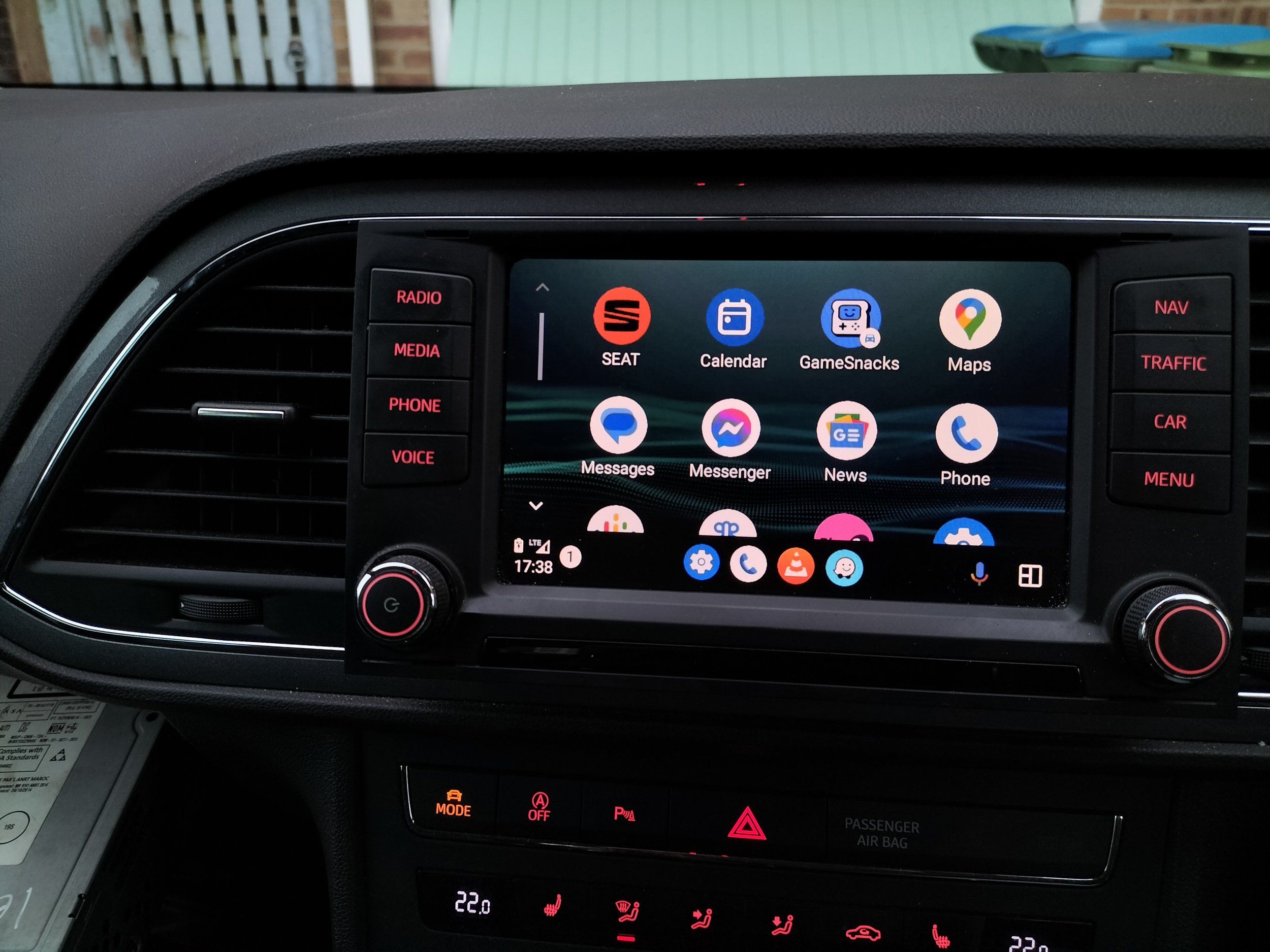

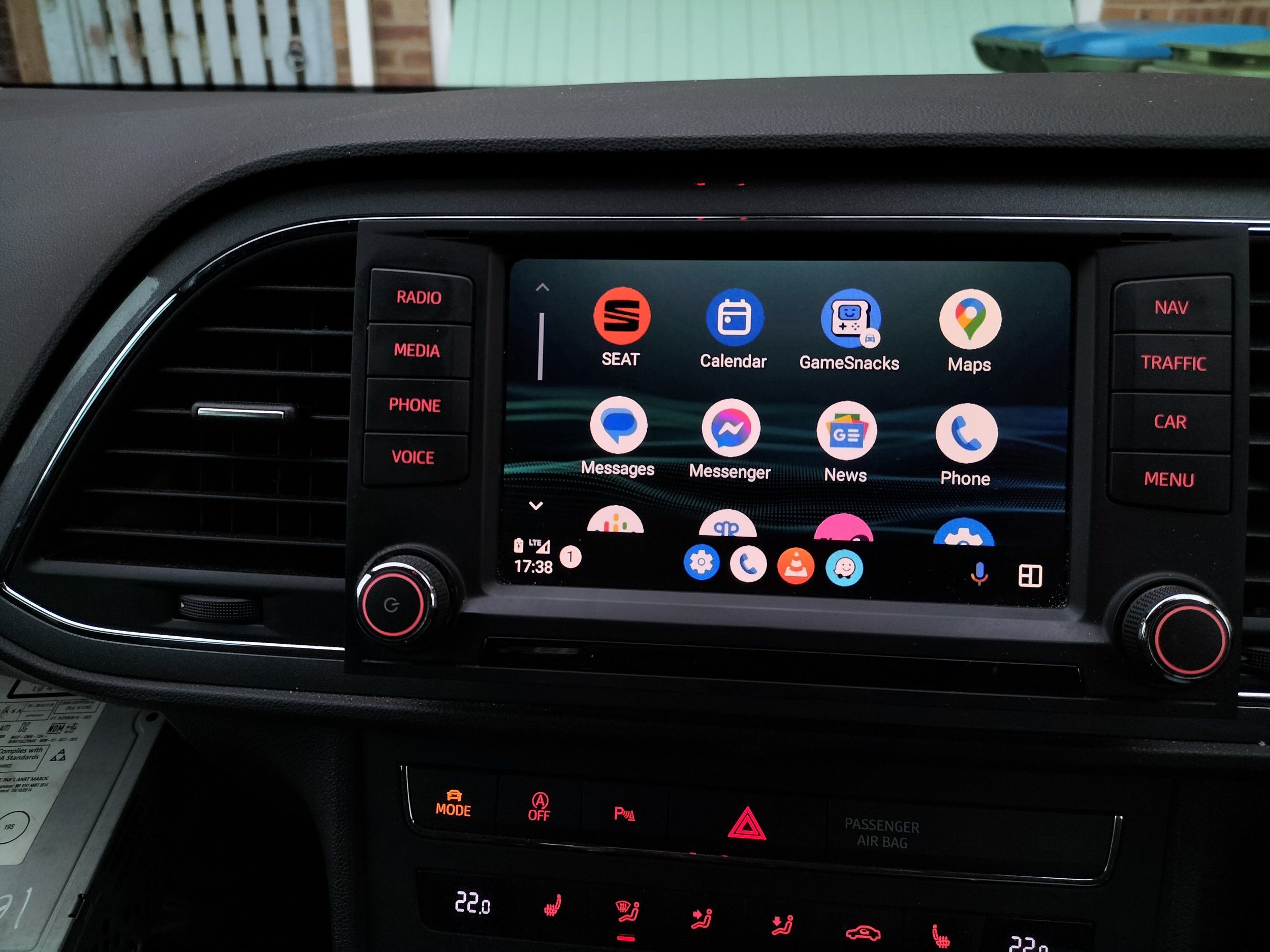

After this there's sound (CP off!) and Android Auto and we're up to the point where I was discovering the subtle problems (coding to exact car model):
Next we're arriving at the realisation that I had to start learning about coding/parameterisation: went on to install Android's Car Scanner Pro to modify the MIB2 unit digital registers to update them to my specific model - this task is ongoing (see earlier posts). The app actually gives you 3 free code changes which might be enough for some people but not me so I paid for the app (one off payment of just less than a fiver).
I've got to say that after coming from my other car (a 2010 Alfa) that I've just put an aftermarket Android Auto head unit in, these MIB units are a pain in the backside but an interesting learning experience!

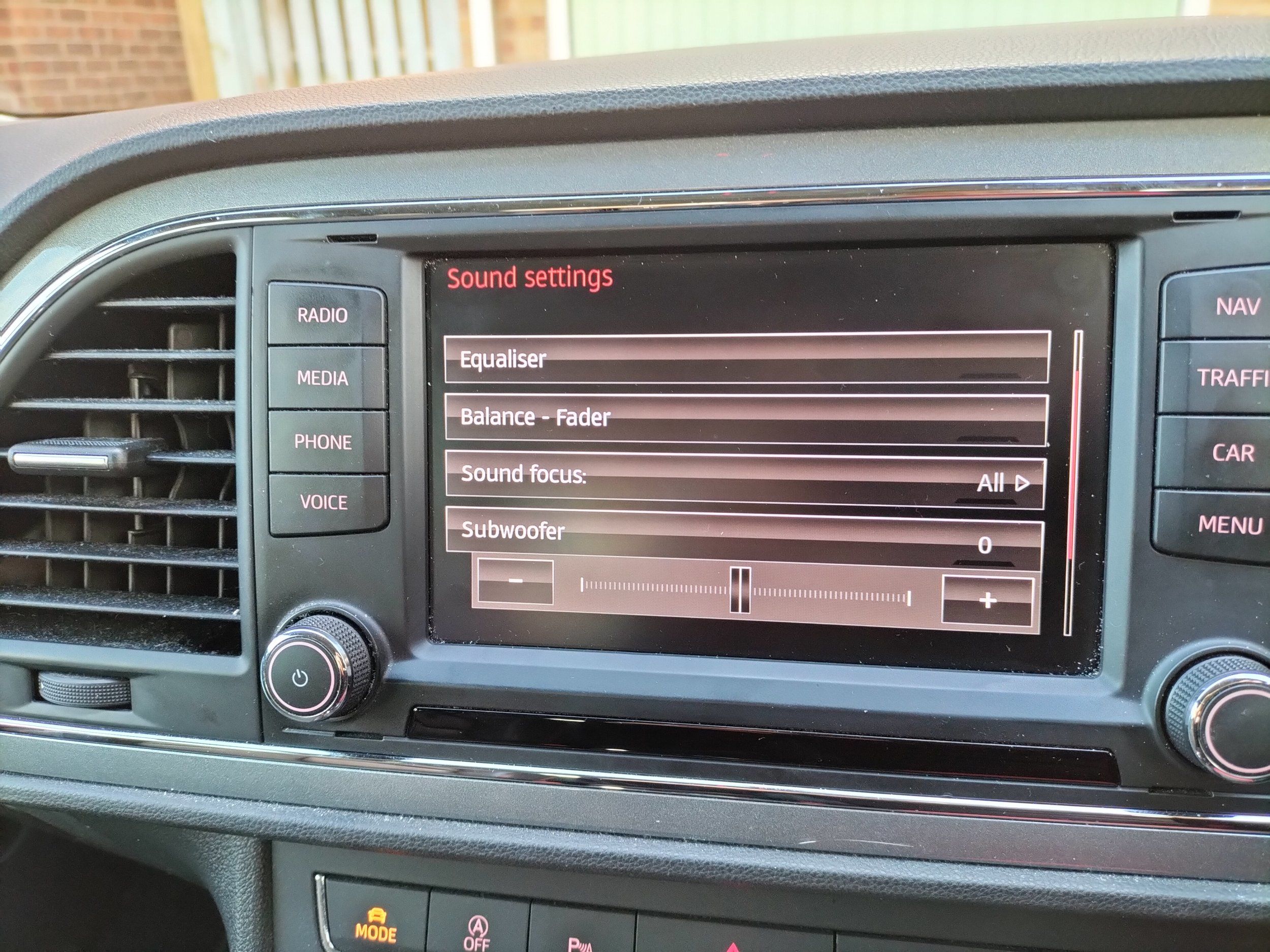

For anyone that needs to activate seat sound. You can diy it now apparantly to get the subwoofer option.
I installed a 02xx mib2 in 2018 one of the first on here actually, but picked up a 04xx unit from a carboot last year for £15 😂 and just getting round to swap it over, as i have factory seat sound from the mib1 i will give this a go.

The subwoofer control does fec all anyway very slight changes. i went through this first time when i swapped from mib1 to mib2 vcp and zdc files etc. Most change was when choosing the car type in vcds from 5 to 3 door. Obviously 9VD picked in vcds made it work 95% anyway.
Still worth a try just to see, i have one done with vcp to compare it to.

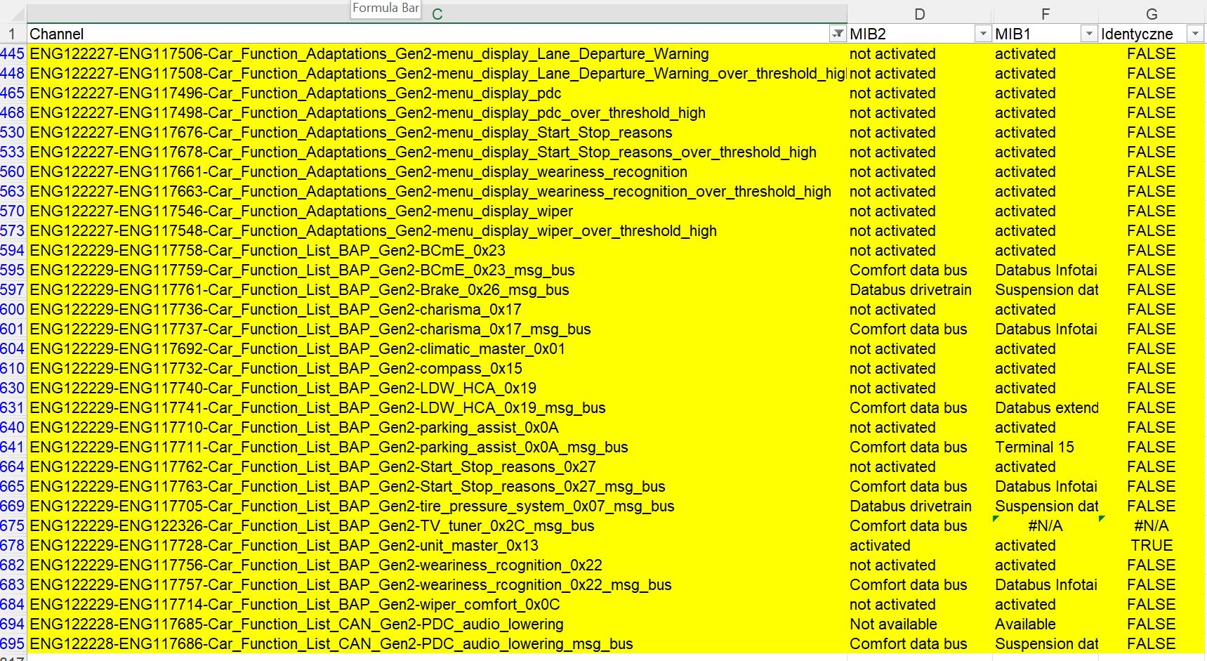

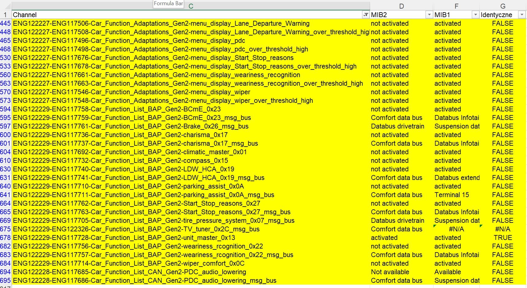

well i don`t have the other tools but this is what i changed in vcds
fake cables work :sneaky:
looks like lines 465 468 640 641 694 695 option to me.

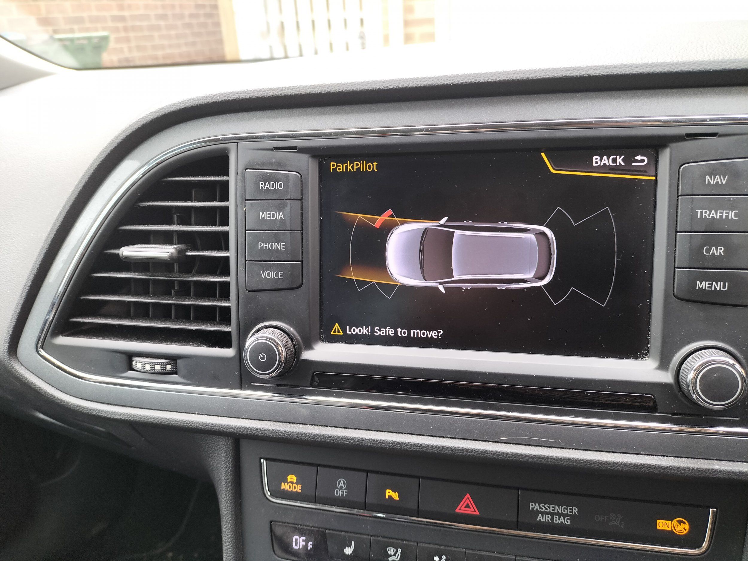

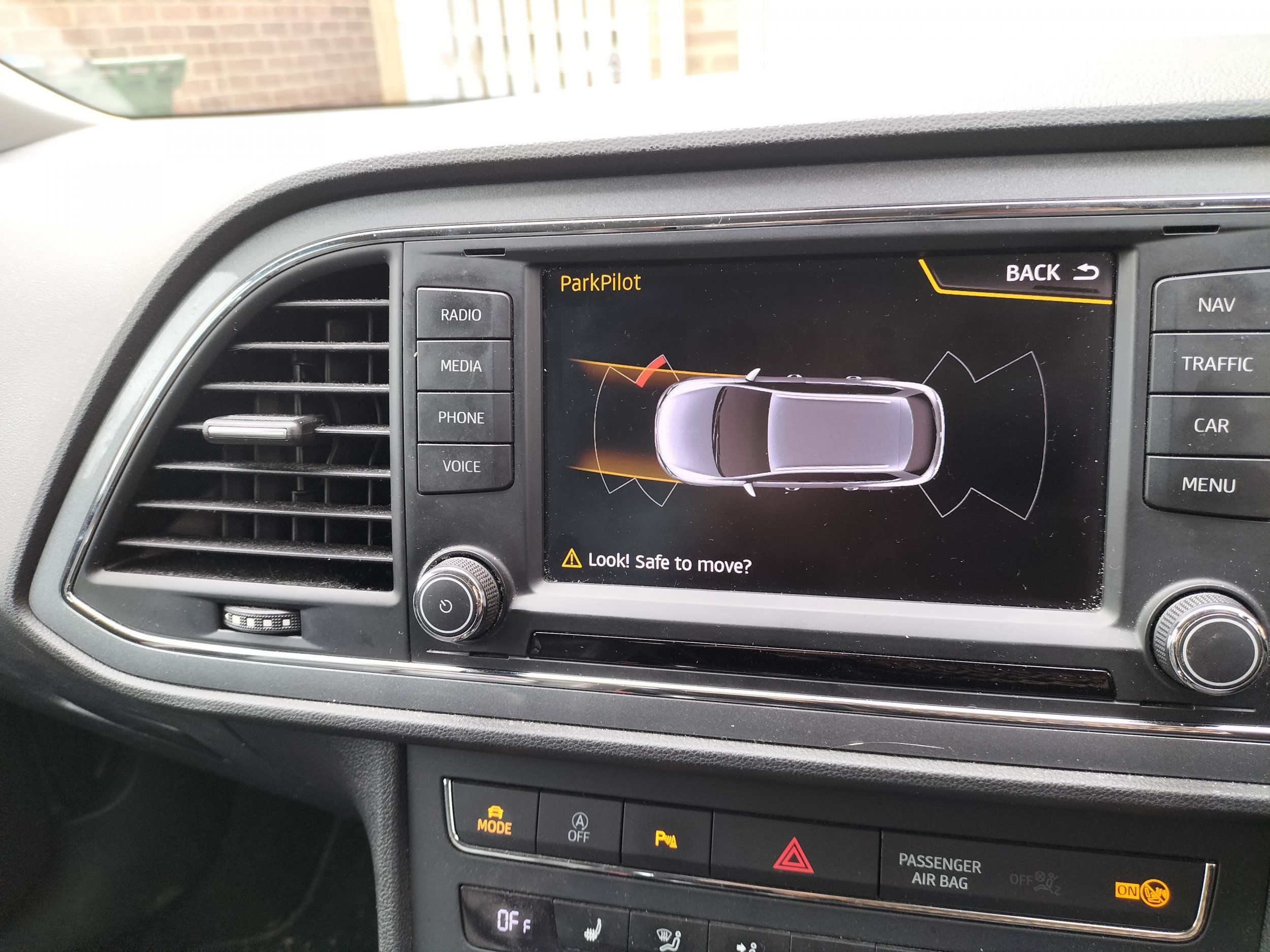

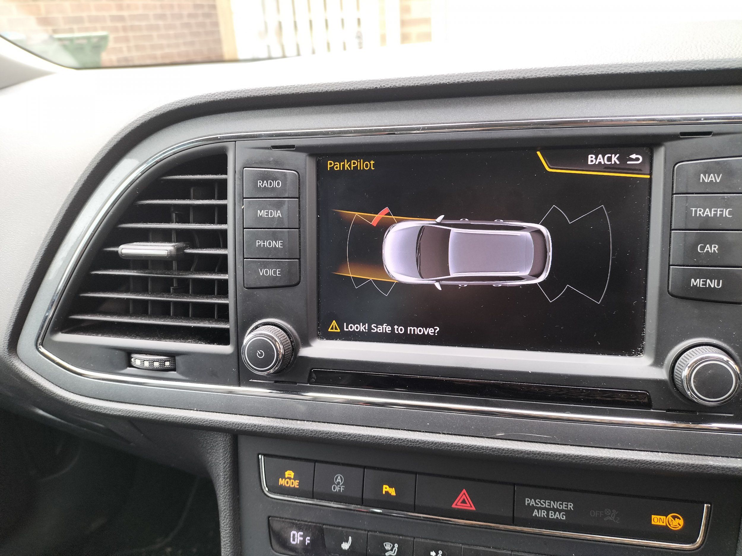

Haven't had much time to 'play' this week, but I did install the GEM and MIBstd Toolbox and tried two things - changing/fiddling with the status of PDC adaptations & menu settings (Mibstd Toolbox) and checked a small proportion of the Car's coding in Parking Assist modules 10 & 76 (Car scanner) which looked ok (00 31 05 10 01) - These had no effect, so no joy yet in making the ParkPilot appear on the screen when reverse or button engaged (the dashboard button and the beeps work fine). I appreciate there's a lot more it could be.. (Gateway coding, CANBus issues etc.).
Enjoying the Android Auto and access to Google Maps, Waze, podcasts etcs. as well as the almost up-to-date inbuilt maps in the meantime!

i have been playing today and i have sussed out how to add fec`s and seat sound with carscanner app pro now. its dead easy.
i have copied the data sets from another mib2 that had seat sound installed and wrote it to the new unit set config to 3 door and wow its sounds better now than my first mib2 unit, no setting for the 3 or 5 door existed on the 02xx unit i had so think that was the issue.

Well I probably don't have optimised SeatSound yet (I haven't yet figured out how to do that with Carscanner pro!) and I also couldn't see how to use Carscanner to do the Parkpilot adaptations needed either so I gave in and installed OBDeleven pro - was easy to sort out the missing Parkpilot* with that!
Looks a bit snazzier than the MIB1 version!
*It was setting the BAP Gen2 adaptation parking_assist_0x0A to active that I was missing.

I did the seat sound upgrade on my new unit worked a treat.

Thanks to leonlad's 0x3000 & 0x3B00 config files and CarScanner Pro, the sound is improved (more bass than I can handle!) and the sub-woofer menu appeared!
