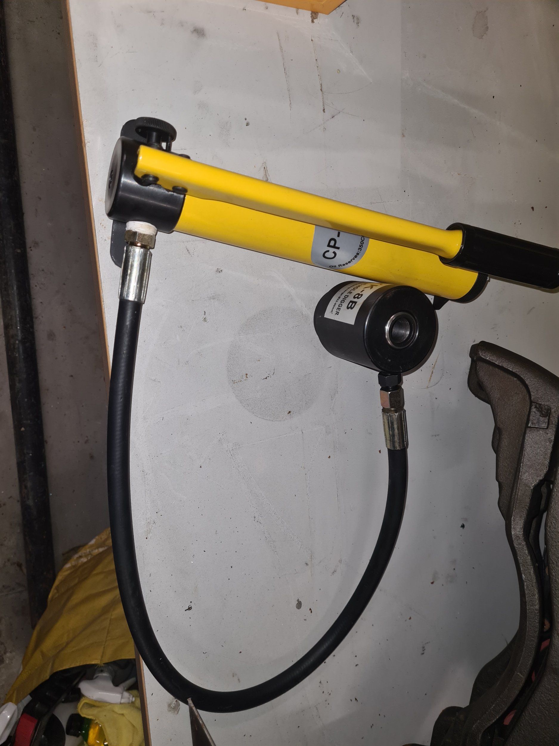

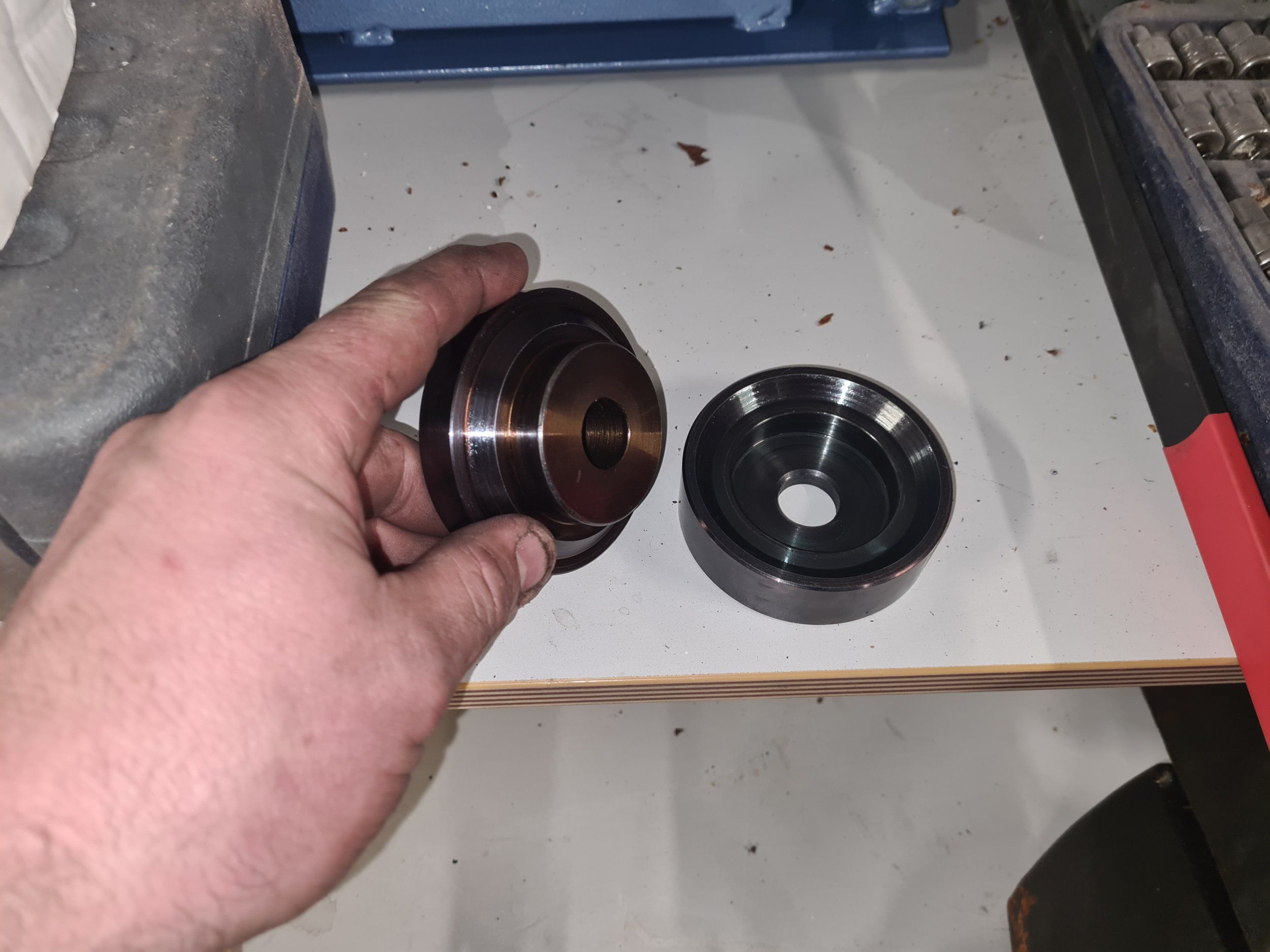

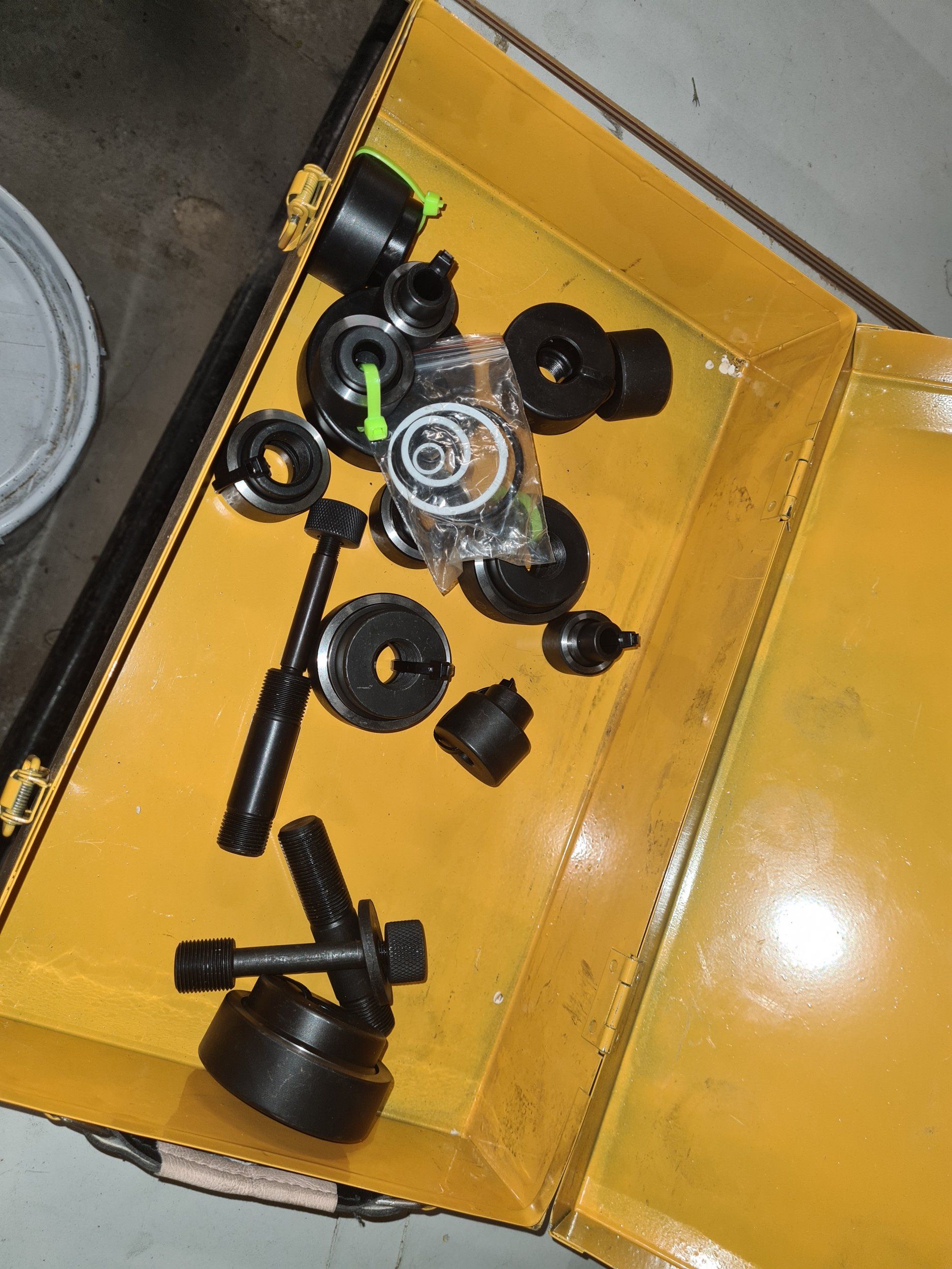

Some new toys turned up today... quick pop to the work shop to have a play... took some quick photos. If people want I will do a more indepth description.
What I have bought is a hydraulic hole cutter. So what you get is this pump
and then a range of different size hole cutters
Well we all know what a hole looks like so will skip that.... then I also bought a set of dimple dies to fit the puller
Then line it up and then pull it threw the hole and .......
Every thing is now going to get holes ..... lightened

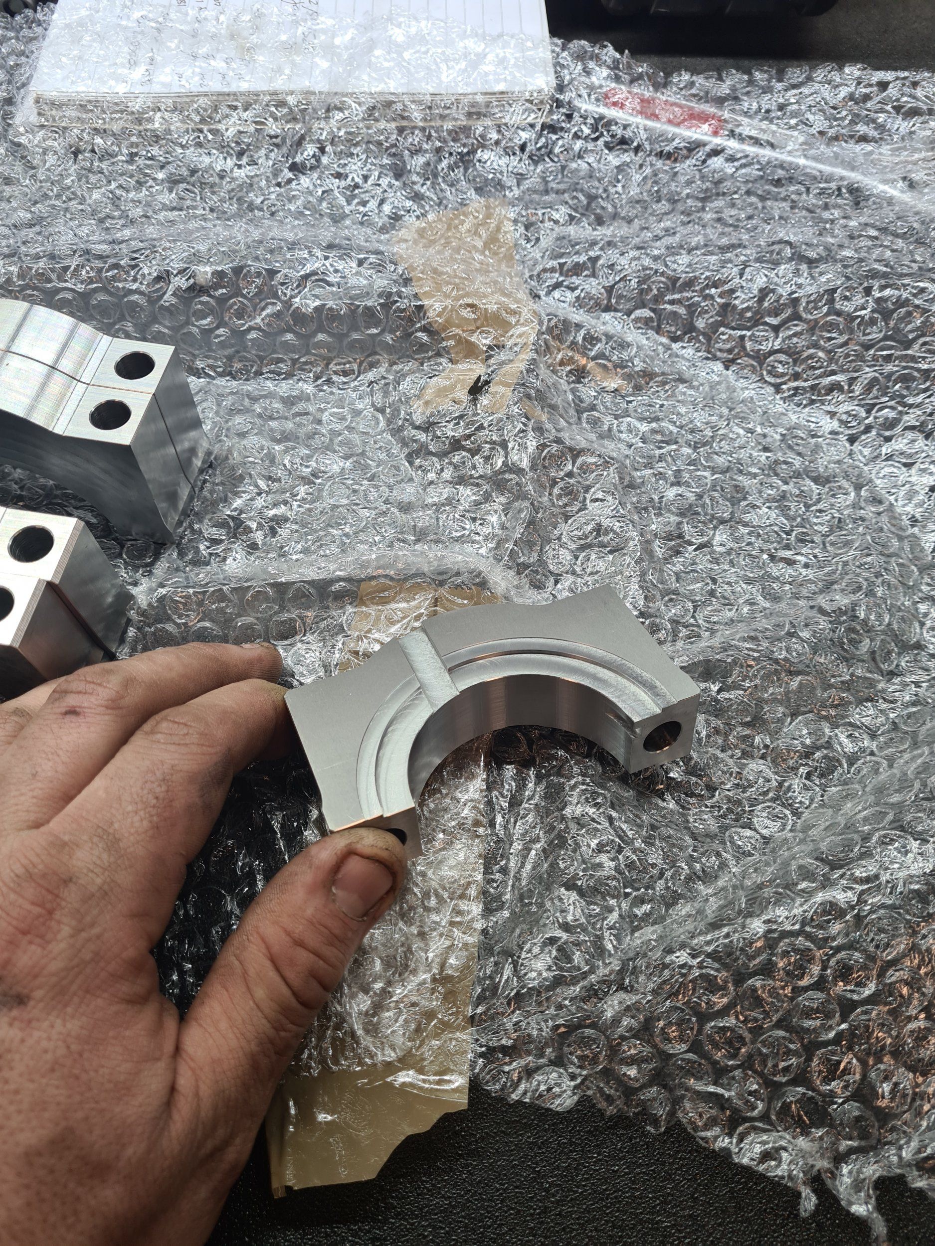

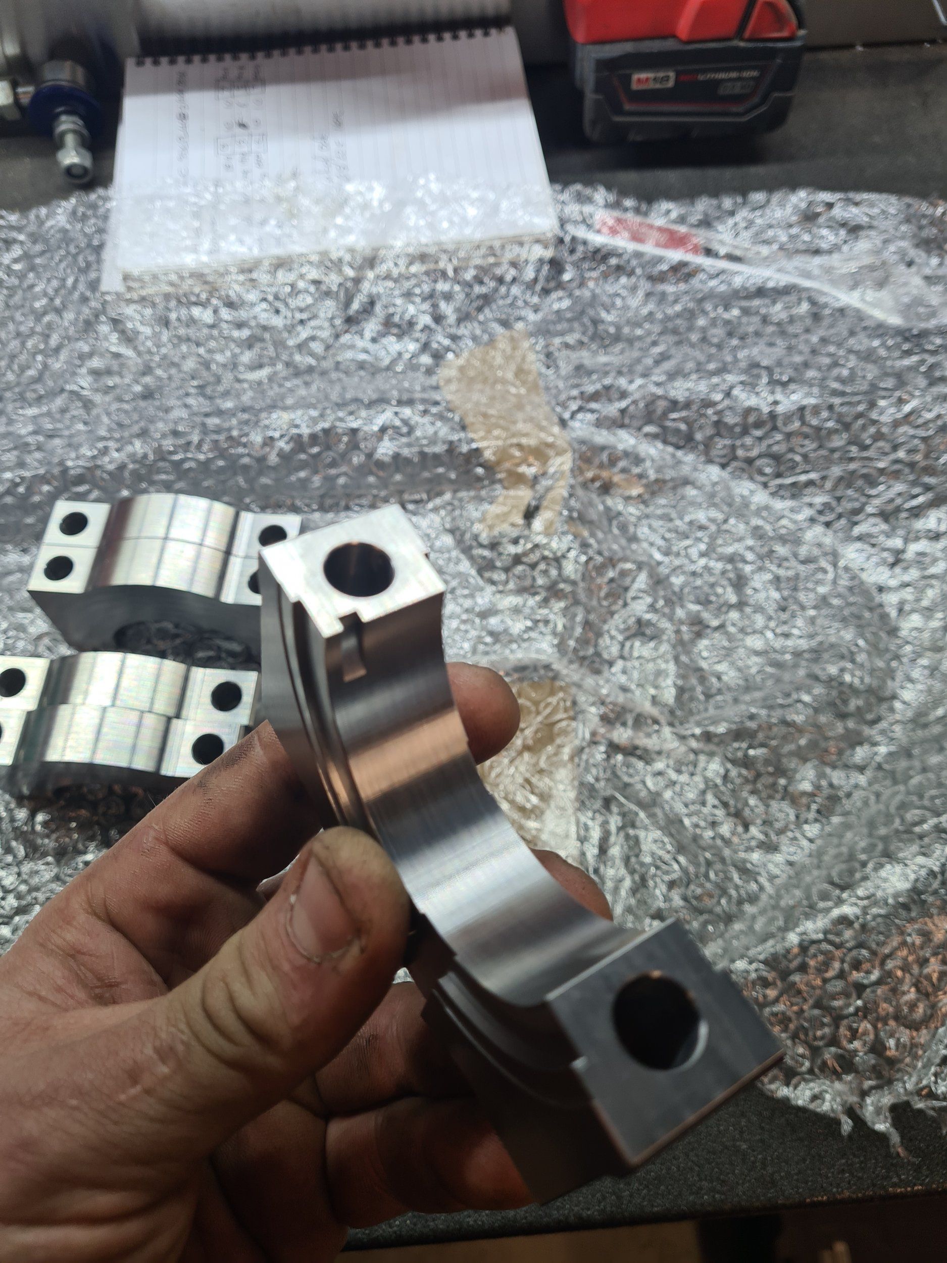

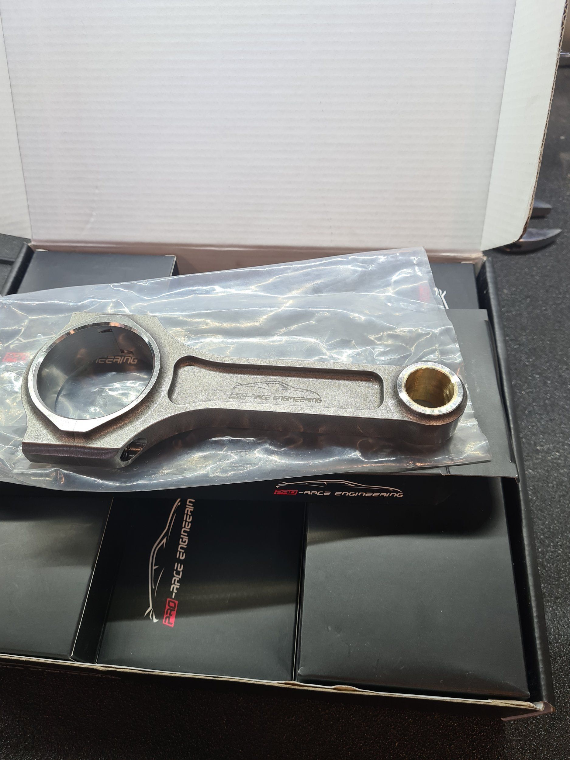

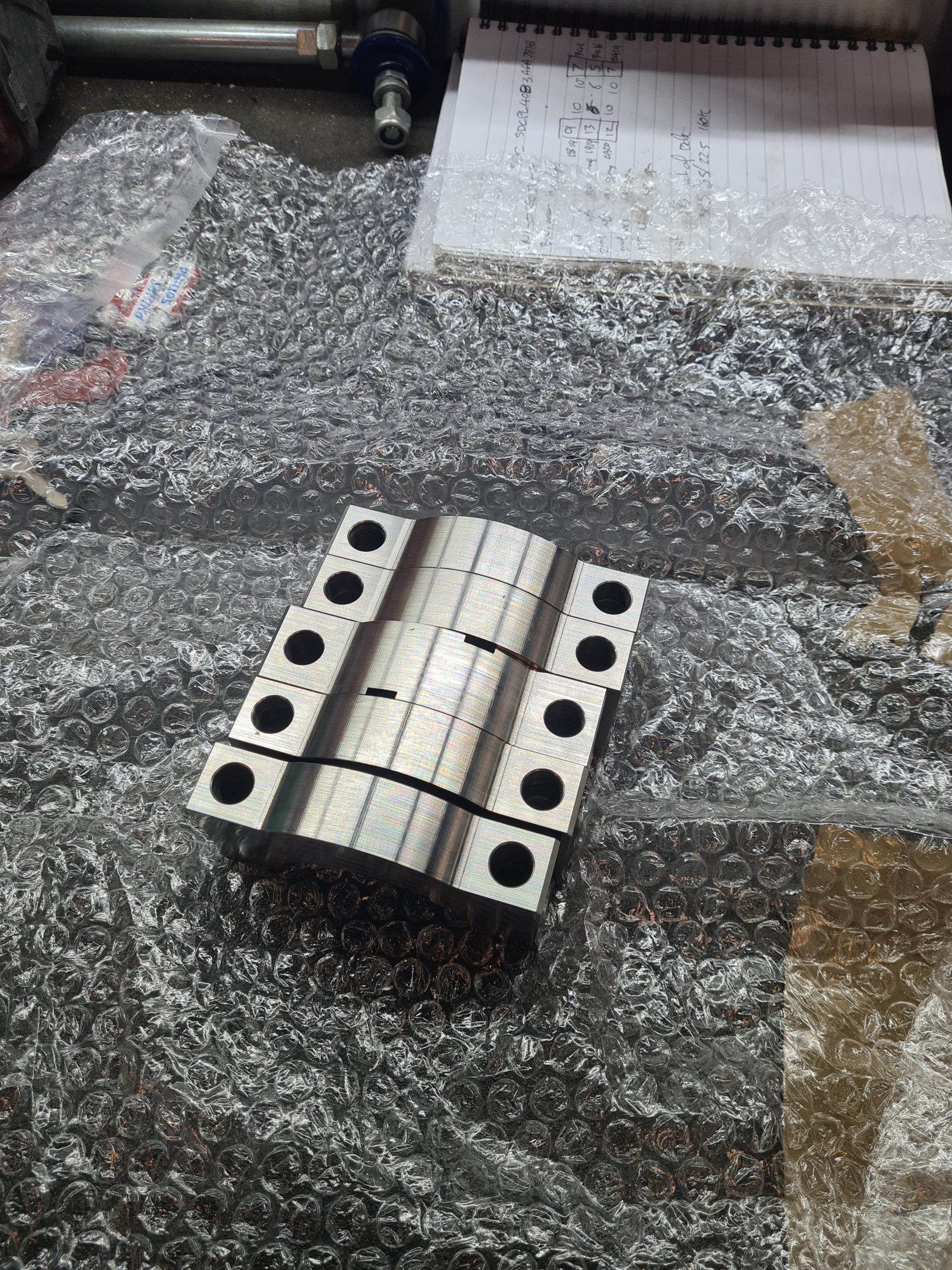

Next up are the billit main end caps. Again supplied by Prorace engineering.
These are a love bit of machining. They look ariginal apart from being Billet. The idea it so hopefully make this engine semi bullet proof..... or we'll manic proof.. they will need machining to suit the block . Also to hold it in place is an ARP stud conversion . Again. Stronger than the bolts so hopefully more reliable

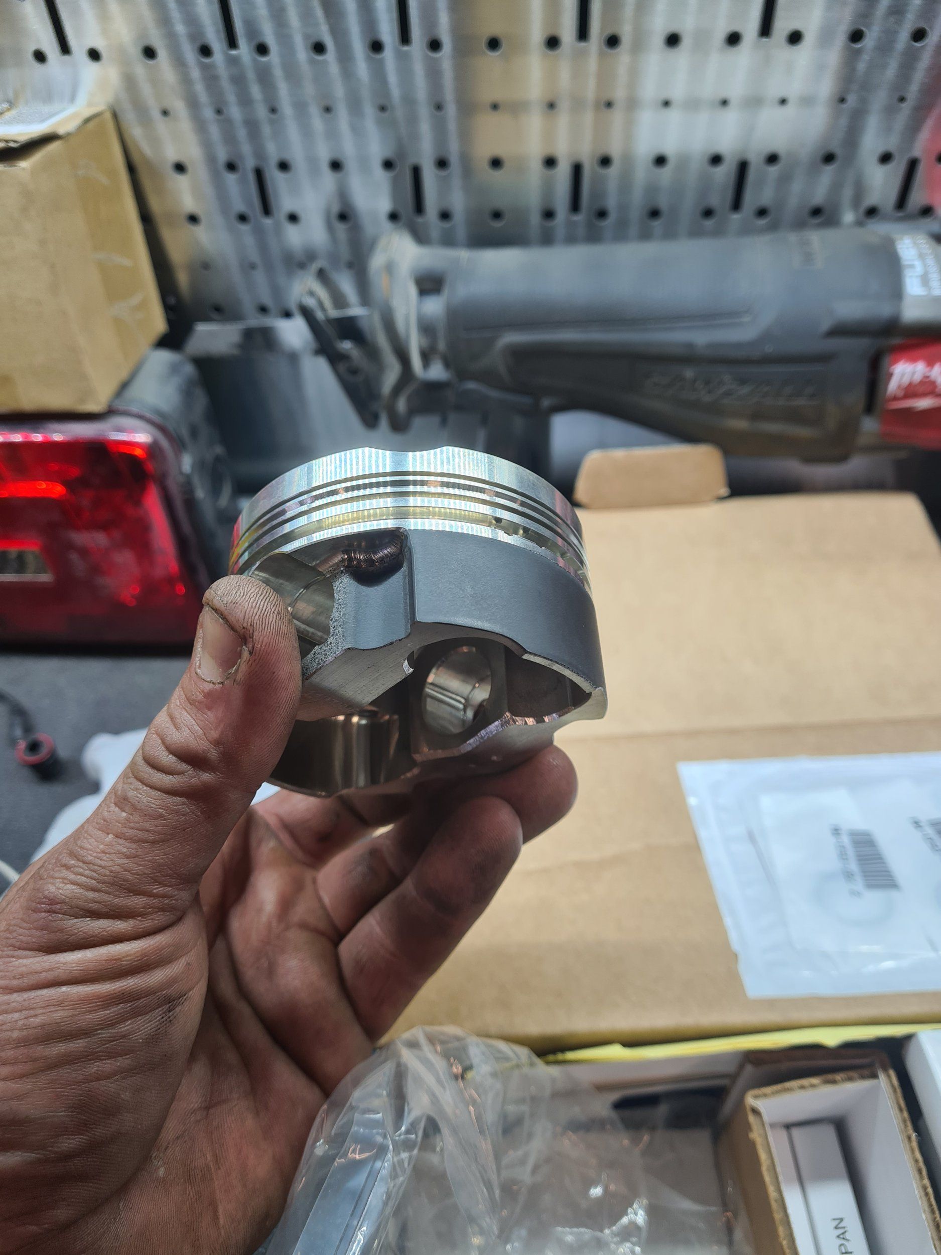

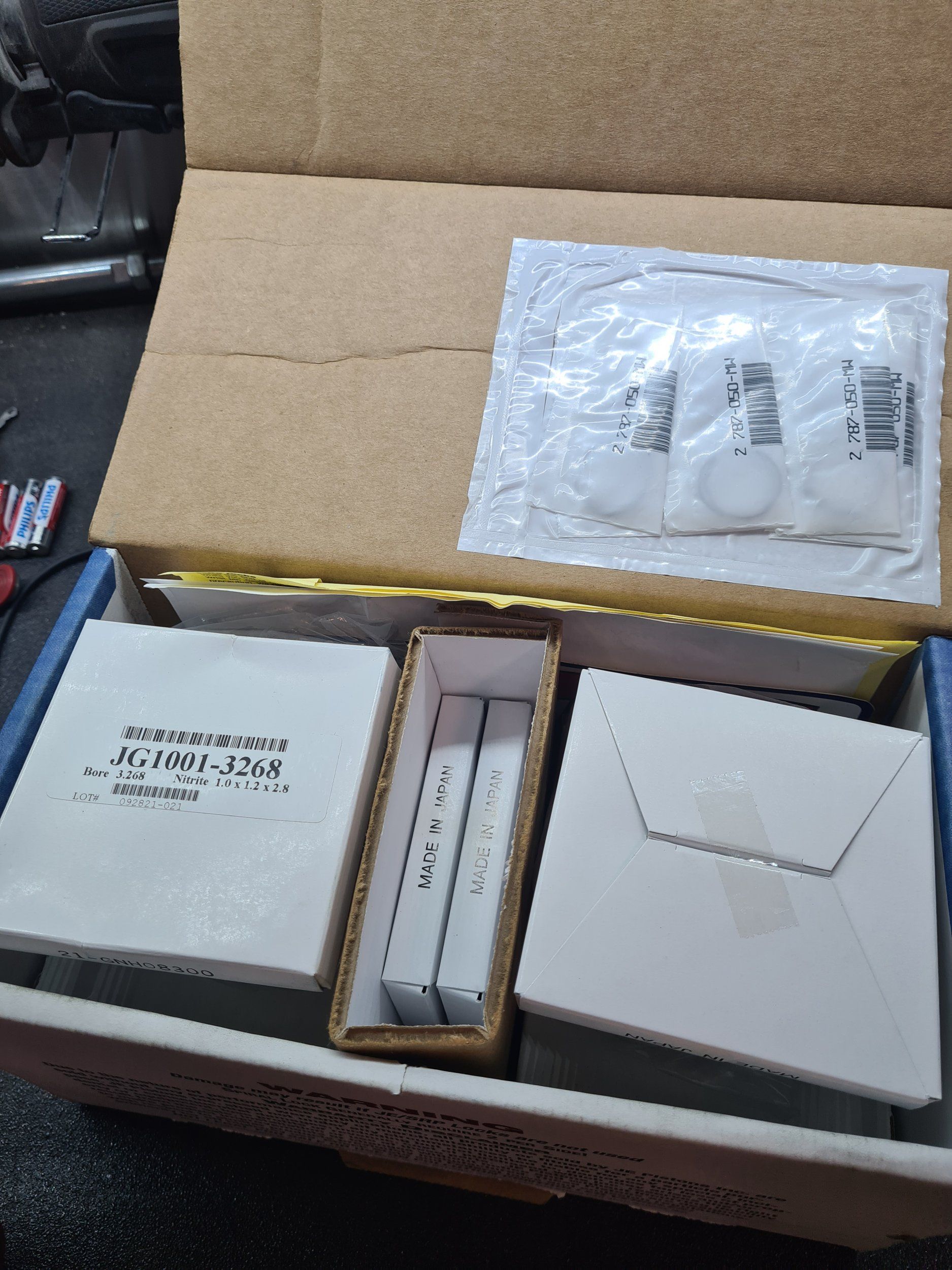

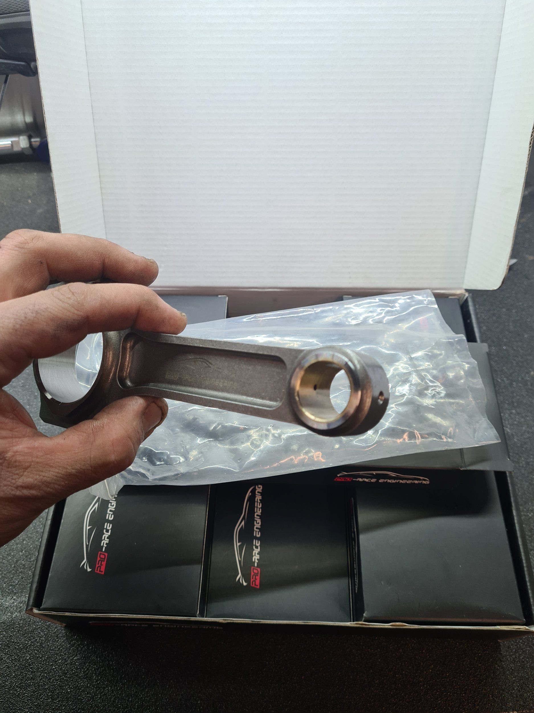

Please all sit down.... here we go... again from prorace engineering. As I am going stroker now. They supplied me some JE pistons...
Who's ready for some unboxing
Mmmmmmmm. We getting closer ... ready for the goodies
They have the extra tool steel thicker wrist pin. Then I went for the thermal barrier coating on the crowns and the tuff skirt coating to help slide and prevent wear.... I wish we had see threw blocks. Or I should have bought 5. And mounted 1 on the wall..ooooooooo

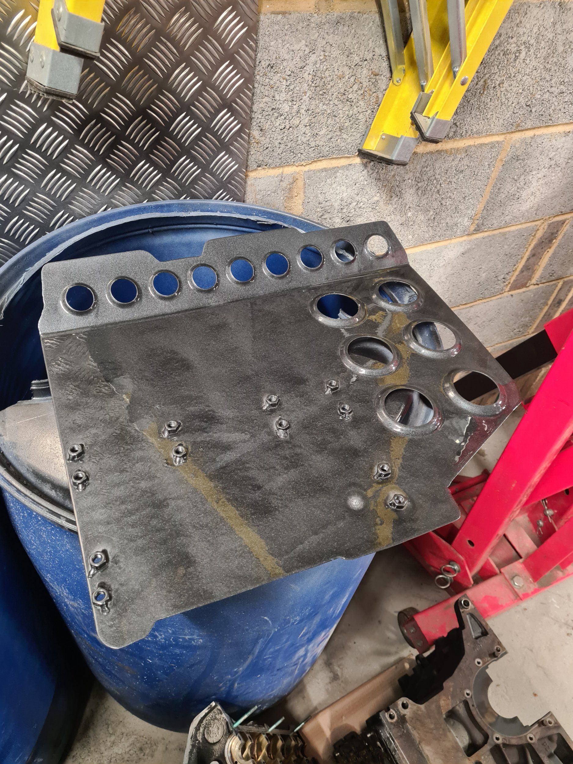

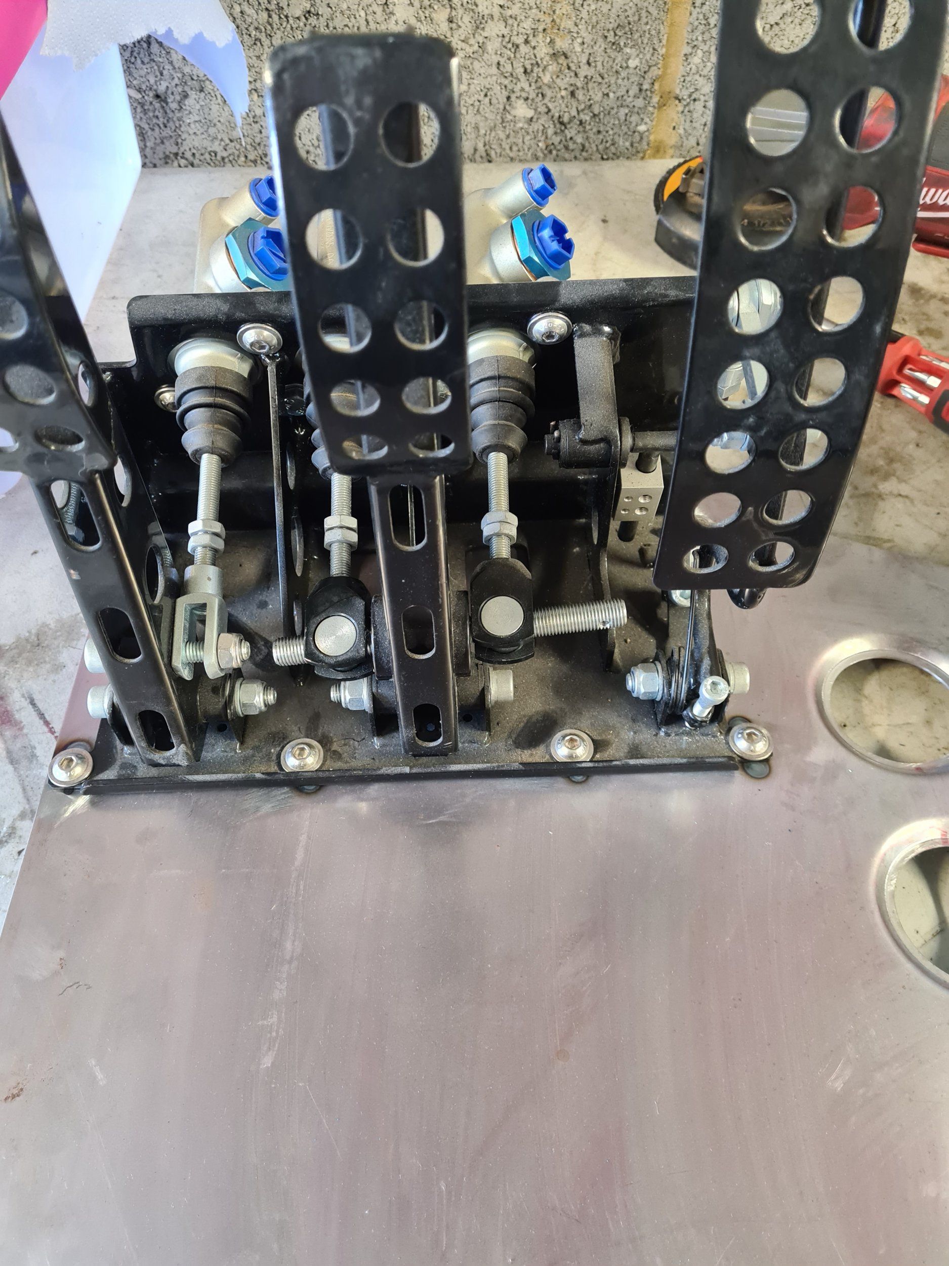

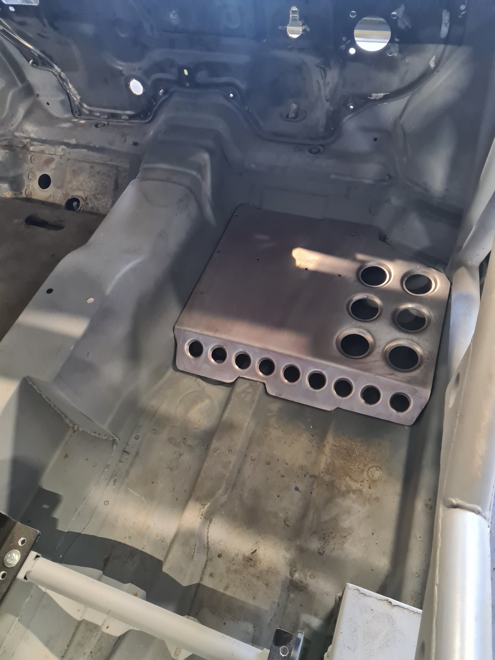

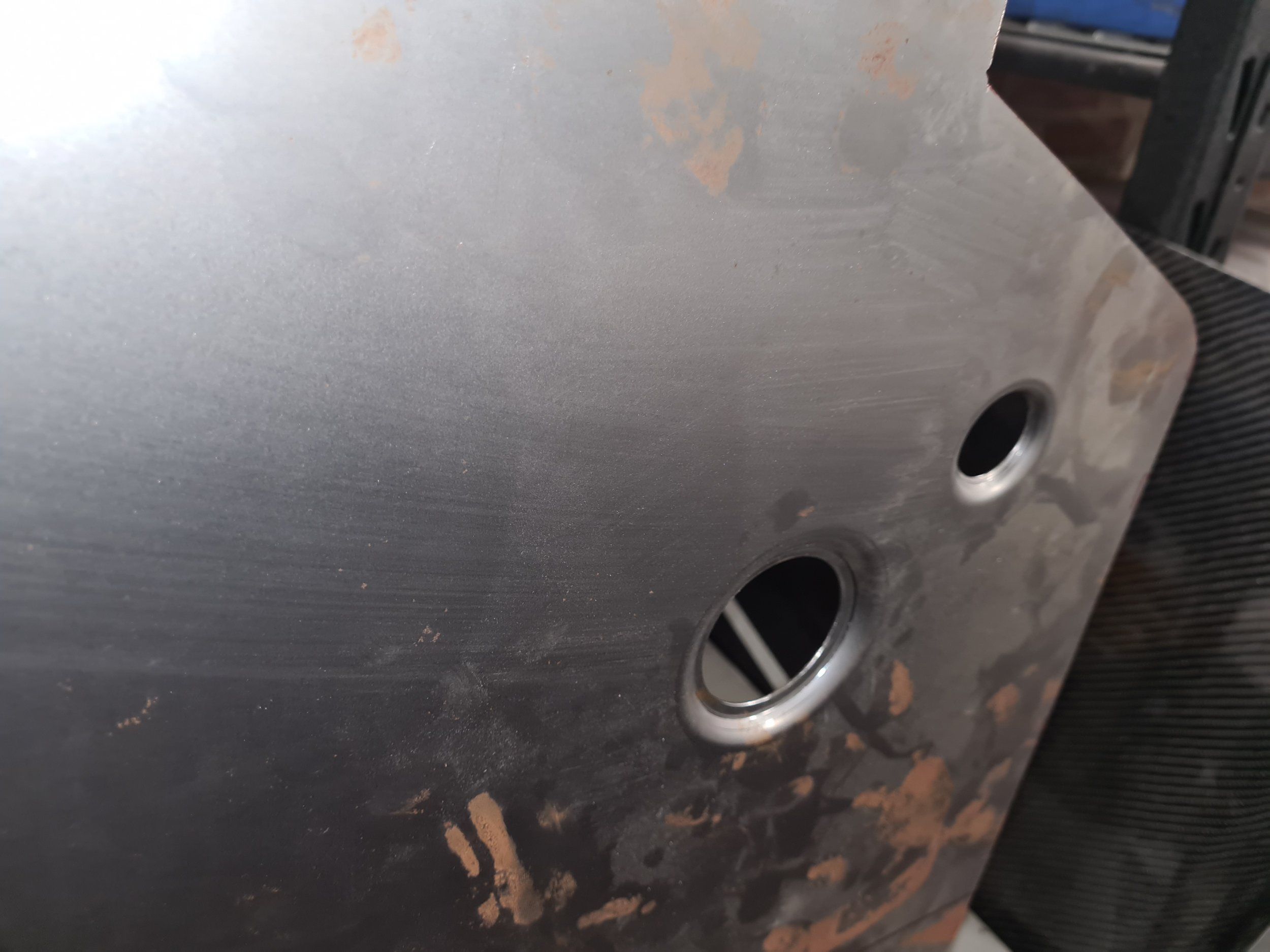

Carried on making the floor plate for the pedals.

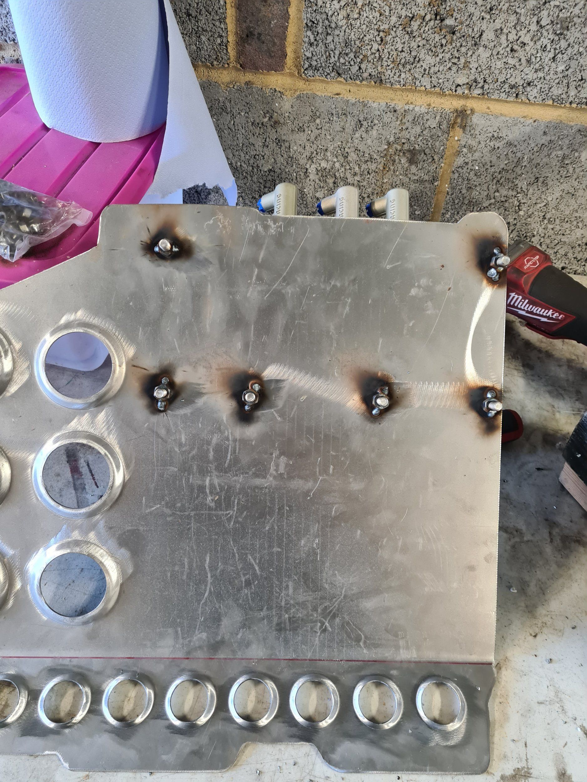

I holed and sumped the areas that are not in the way. So on reading and experimenting. The holes reduce the weight but dimpling or sumping reintroduces the strength and rigidity of the panel.
I then lined up the pedal and then drilled the holes to mount it . I used some mild steel nuts and then bolted the pedal box in to hold the nuts in the right position then welded the nuts to secure them.
Then I moved the pedal box forward an I ch or so then repeated it again so the pedal box is movable. Then gave it a quick paint underside to stop it rusting when it's welded in to position
