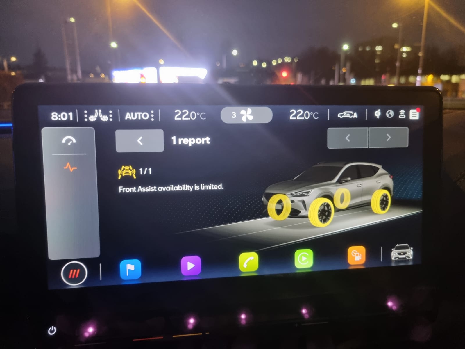

Had a couple of errors on my 3 week old car.
First was “Front assist availability is limited”. This has happened a couple of times. First time the car was thick with frost and put it down to sensor being frosty, but other time it was mild and clear. Ironically it happened in the same location on both occasions. After a few mins the warning disappeared and all was good.

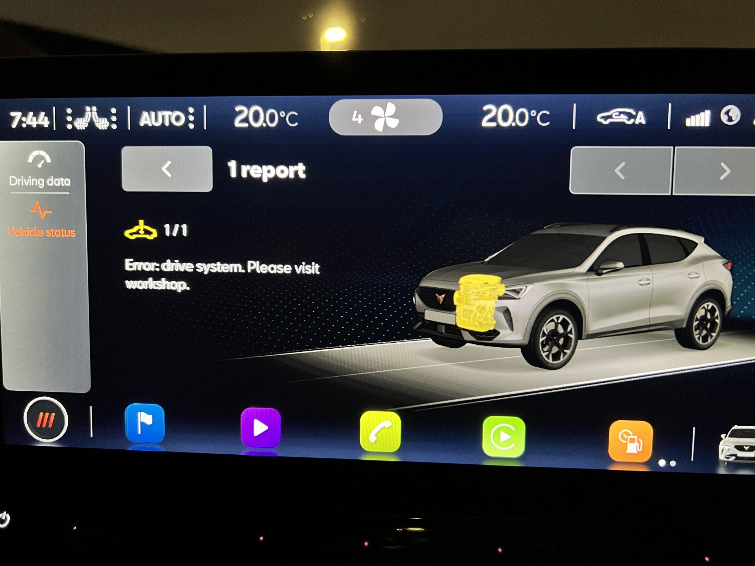

Second error was, “Drive system. Please visit workshop”. This happened the other morning when pushed ignition on, but didn’t start the car. I switched the car off and back on and the warning disappeared. I called my dealer and they spoke with the Cupra master tech while I was on the phone, who advised that it may be teething problems as the car is such a new model and updates are coming out all the time, especially as it disappeared on switching off. They said to keep an eye on it and if it does it again to let them know and get it booked in.

Pretty picture on the front assist. The Arona's front assist is sensitive to angle, theory water inside drains down blocks it. Often happens after rain and it's got wet. Doesn't happen on the Ateca.
Thanks. That’s the wife’s skills while we were sitting at the traffic lights. Read the manual this afternoon and it says that many conditions affect the sensor for front assist. Rain, fog, frost, dirt, insects, etc. First time it happened would put down to frost and second time could’ve been water or dirt.
The drive system error is the puzzling one.
My saga with the drive system error is somewhere on this thread, several months back. In short, I had this on numerous occasions, some were fixed by a restart while others were persistent and my car had to be recovered to SEAT on two occasions. A lot of back and forth as the garage couldn’t replicate the problem (car started after recovery / thought they had solved it… eventually the suspect part, Body Control Module, was replaced, and ever since then the problem has not recurred.
I read back of your problems. That wasn’t good and hope mine was just a one off glitch. My dealer said there wouldn’t likely be a problem logged as it cleared itself so quickly so not worth booking it in unless it does it again.
