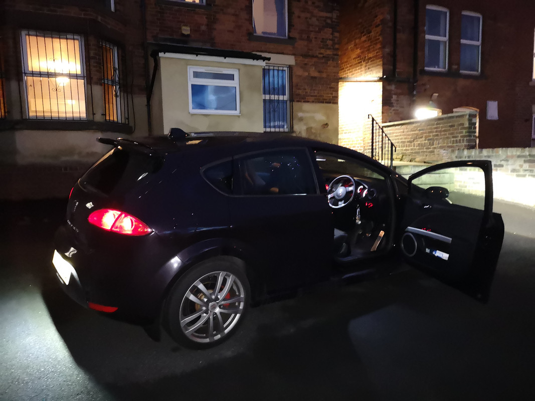

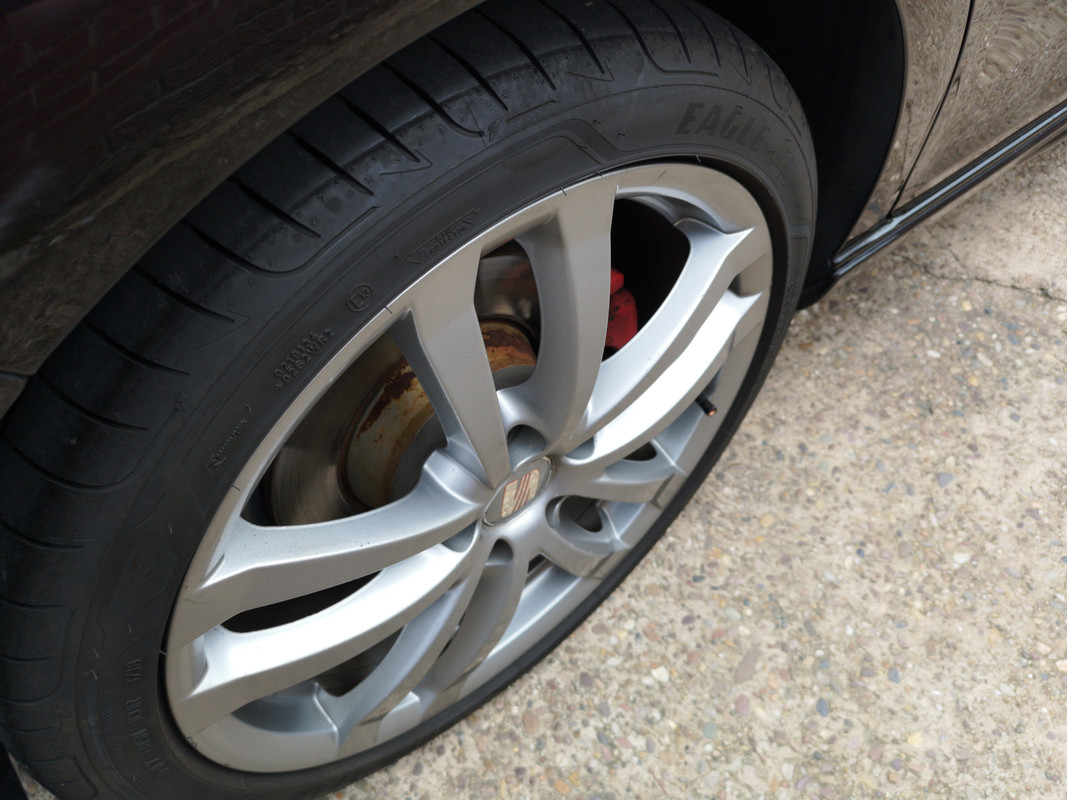

Got a horrible vibration noise coming from the rear, bearings are absolutely fine but found lumps in the inside of both rear tires! So gone with 4 new Goodyear Eagle F1's as the fronts needed replacing as they look pretty old and cracked. Had these tires on my previous car and they were brilliant!

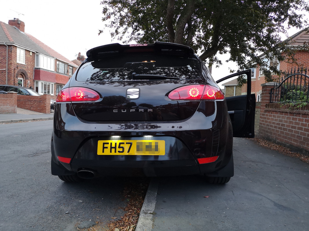

Also got some licence plate LED's and some new 3D gel plates, really smartens it up I think and also fitted LED's in the rear indicators which are a little bit brighter than normal.

Do you get any errors for the rear indicator lights? I wanted to get an LED for the reverse as it's quite pathetic but the indicators don't seems amazing either...

Thanks mate! No errors as I made sure I got canbus ones and they work well. Wasn't sure if they would hyperflash but I'm guessing vag cars just throw up a light rather than hyperflash if your indicator is out. I would like to upgrade the reverse light but heard they strobe upon starting the car so kind of put me off abit

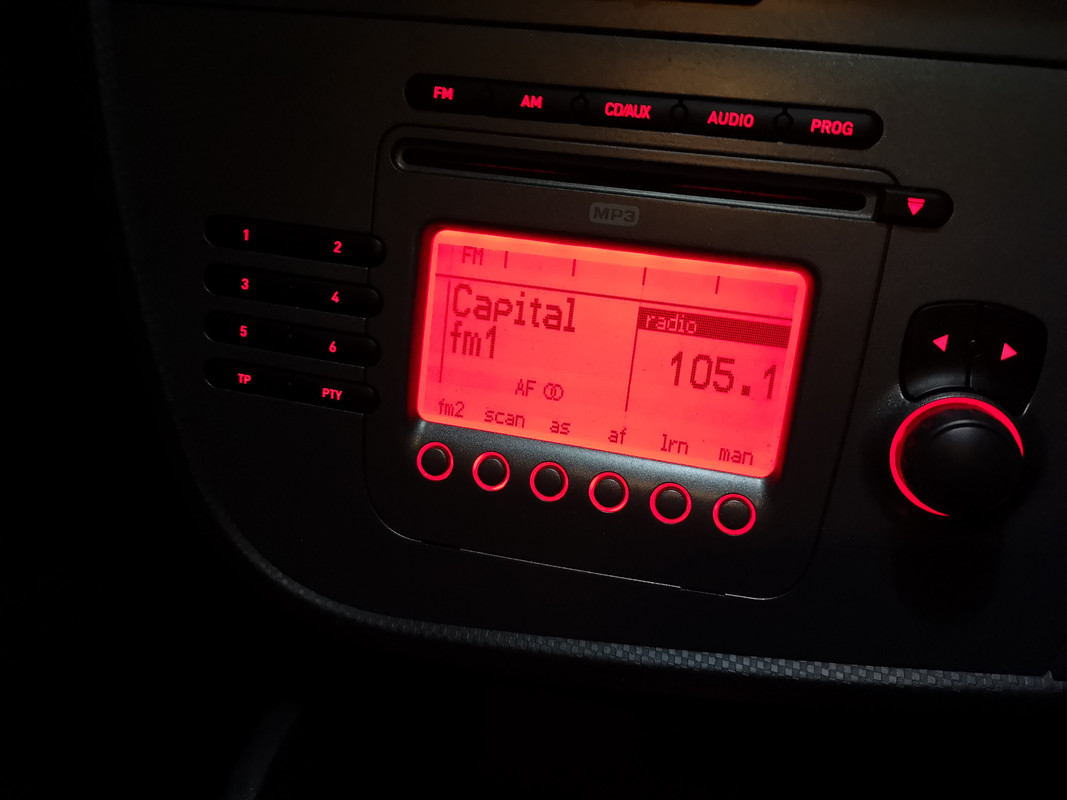

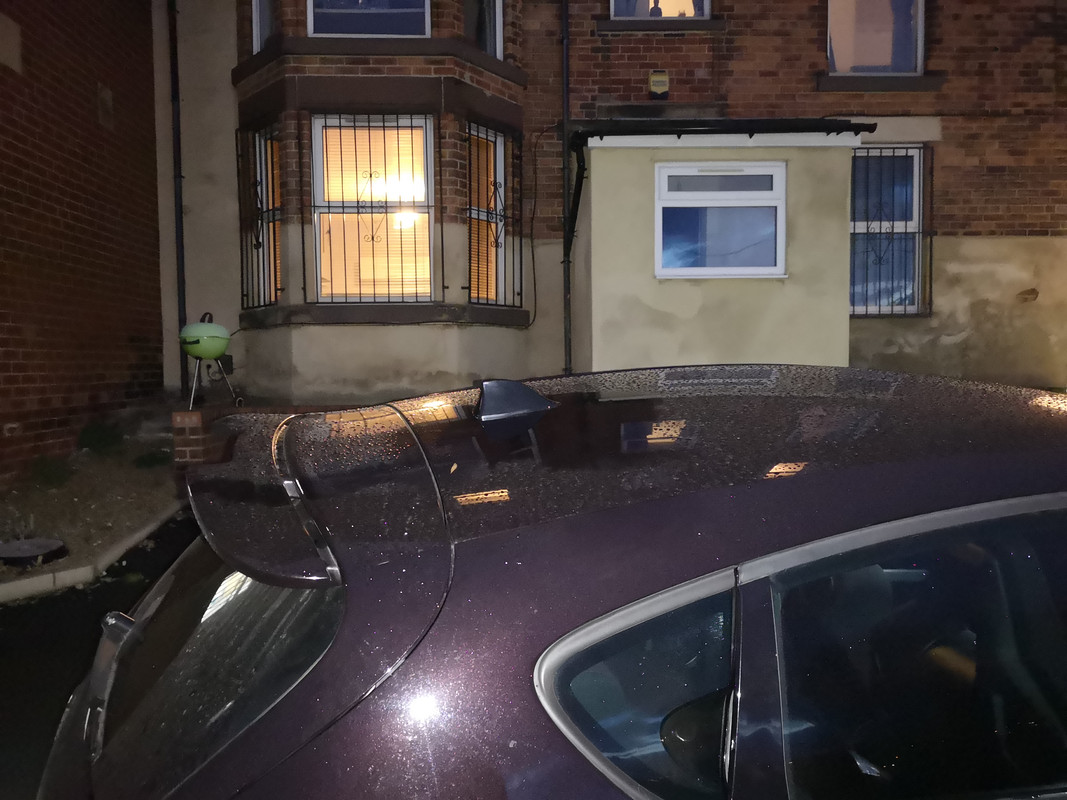

And last but not least I unscrewed and pulled of the horrible 9ft ariel and replaced it with a gloss black shark fin which has an ariel inside you screw into the existing hole. So much cleaner now and I hope I stuck it on straight as it got dark very quick lol.
Radio still works great!

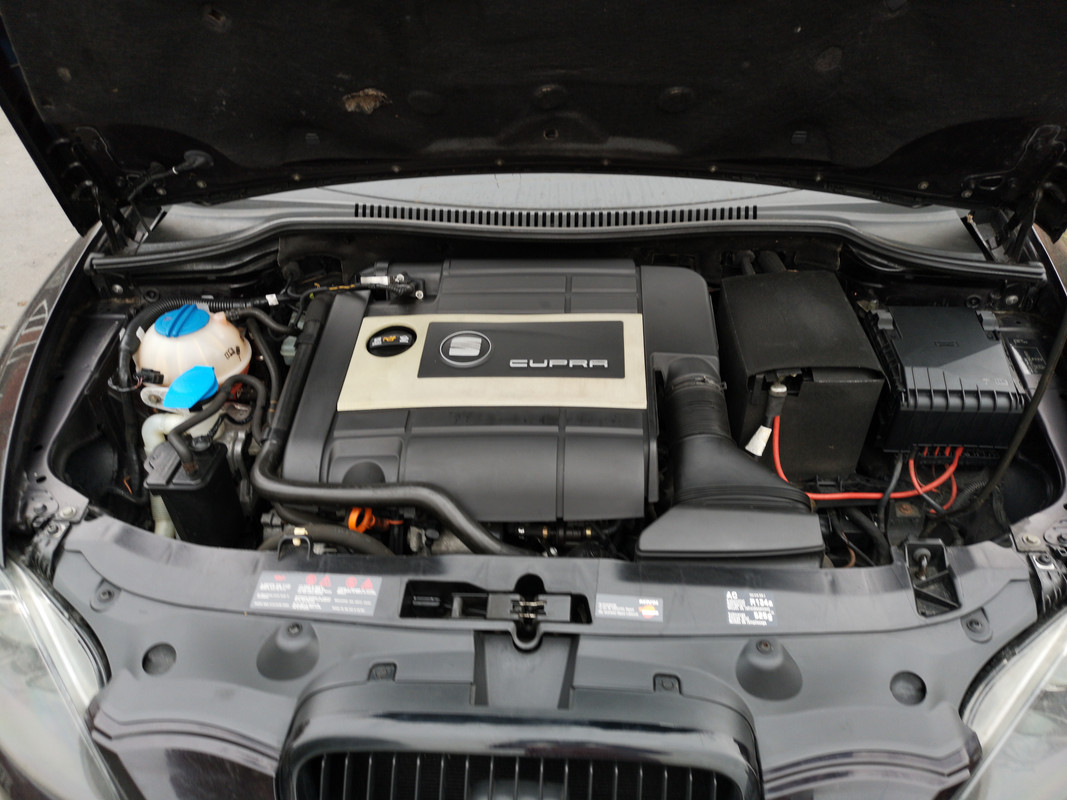

Gave the engine bay a quick spruce up just with some EZ Car care APC. I didn't dress it.

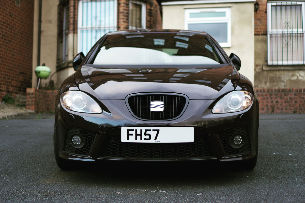

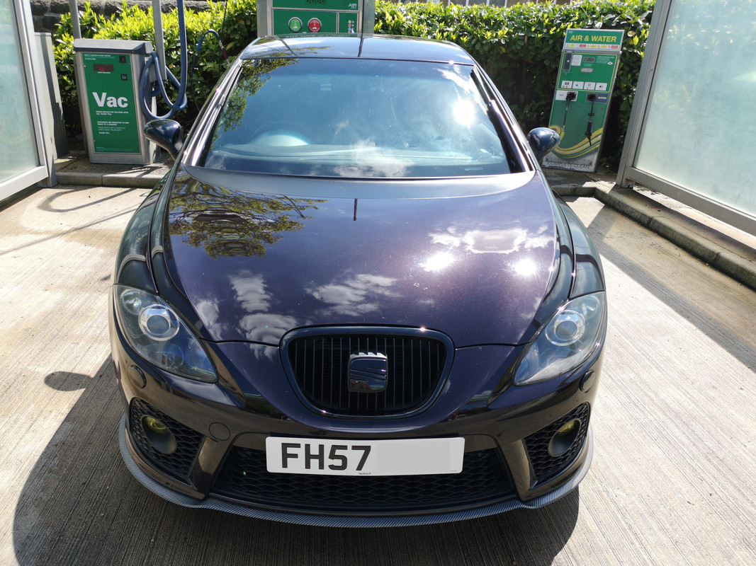

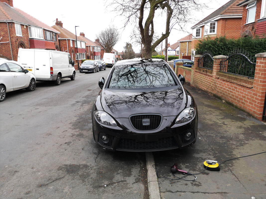

It's been a while! Nothing much has gone on really, I did get a super cheap carbon fiber look rubber splitter which I actually really like the look of! And tinted the fogs yellow with some yellow light wrap which I will probably re do one day as its not great but looks okay from a distance lol. Car was filthy as per so a routine wash was in order!
And after the wash

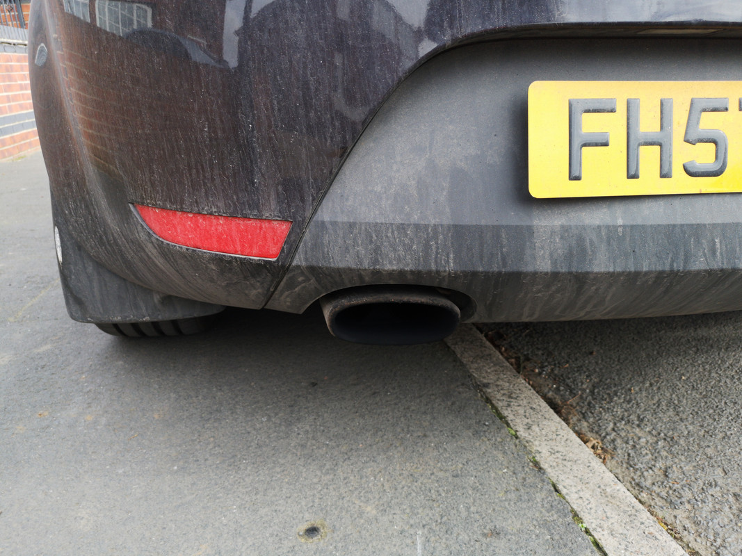

Bit spontaneous but has a centre box delete done yesterday, they definitely should of sounded like this when they came out from factory! I'll probably want it louder though soon :lol:
How much was that? I assume they just used pipe they had in the shop lol

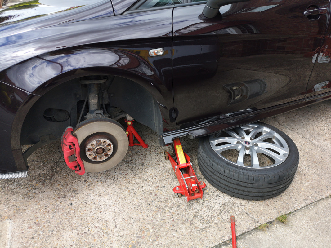

Anyway I started off on monday by sorting out my rusty hubs, they look absolutely awful so a while ago I got some silver hammerite to paint them with.
Picture spam...
These are all before I started, you can see how awful they are!
During...
I did mask them up too as I'm not the most steady handed :lol:
Much much better!

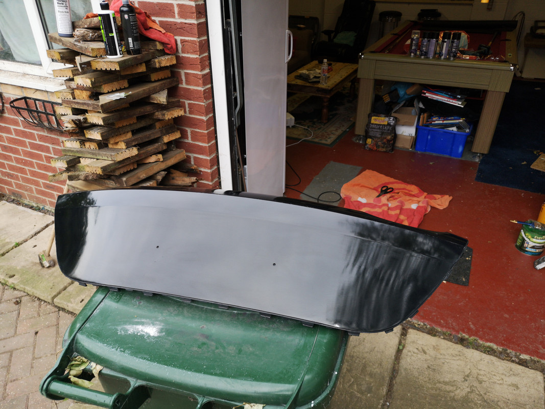

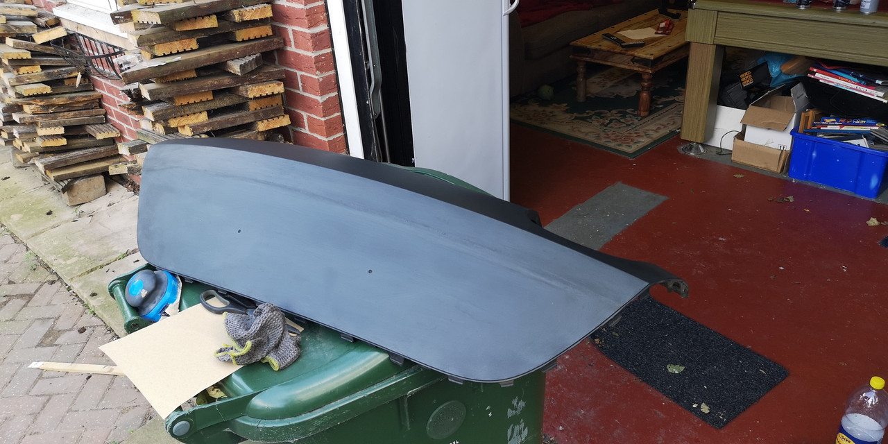

And now onto the rear plastic
Started off by sanding down with 60 grit on a power sander and did the more intricate areas by hand.
Once I had removed as much of the texture as I could, I sanded with some 180 grit, then set about getting some coats of plastic primer on.
It took quite a few coats of primer to get a good coverage. I used over a can.
Many many coats later, it was ready to be flatted back
Once I got it flatted back I cracked on with the gloss black paint, £1.99 a tin from home bargains!
It took alot of painting to get it to how it looks above, after I wet sanded with 600 grit to get rid of the orange peel and to smooth out the paint, and simply polished it back up with some chemical guys compound and then finished with meguiars 205. In all honesty I spent 2 days doing this and the final few hours I couldn't stand the thought of any more sanding so I rushed it and didn't bother to lacquer it. It's just to last till I get a cupra R diffuser :)
Finished product
Before
After
Its far from perfect but I'm just glad to see it on the car now, at some point i'll perfect it a little more by sorting out the parts where I sanded to the primer by accident and the marks here and there. But for under a tenner and no experience at all of painting I'm happy!

:thumbup: love it. Don't know why Seat don't do it as standard. Also good to see safe jacking of vehicle.:yes:

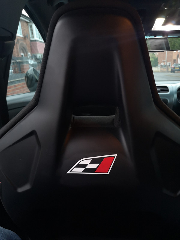

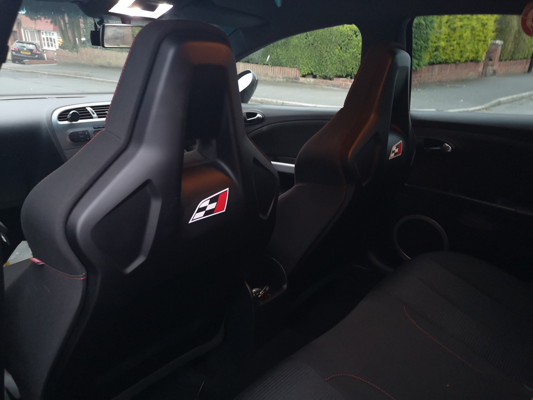

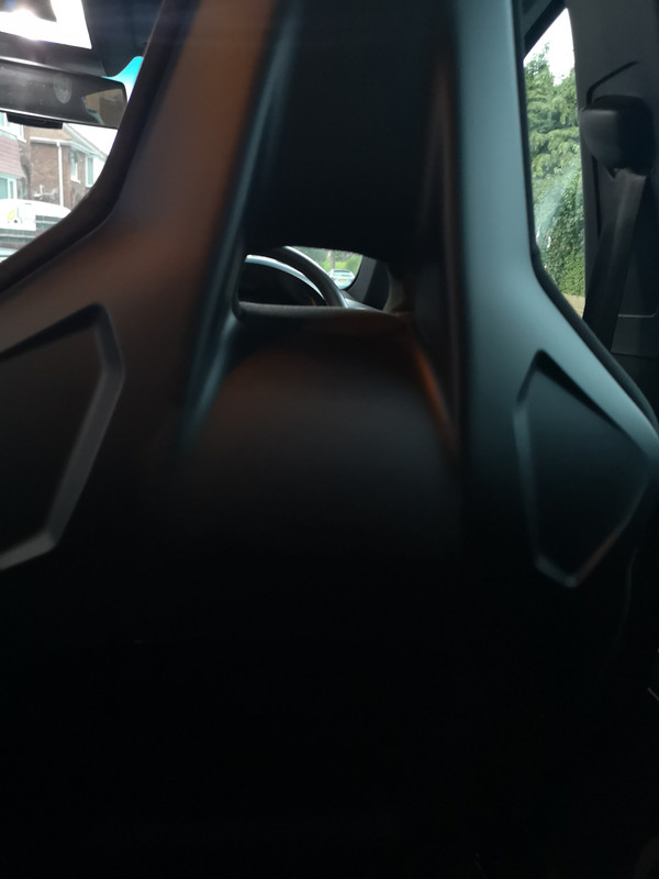

Tiny mod today, not even a mod really just a sticker lol. After looking at the cupra R seats I liked the idea of having the cupra flag on the back of them so I ordered some cheap stickers off eBay! They were such a pain to stick as the back of the seat is textured plastic and is not really sticky at all so hopefully they stay on!
Normal
After
Normal
After
They look ace
