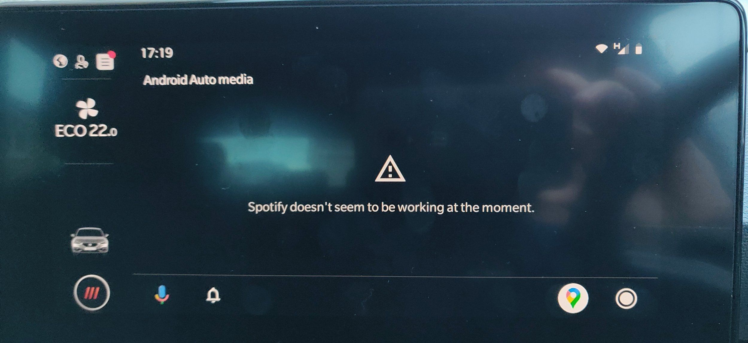

I've got a OnePlus 6T. I'll send a better pic later but I've attached the one that shows Spotify not working. Any clues on that. It's been the same for weeks, but did work initially.
Software versions also attached.

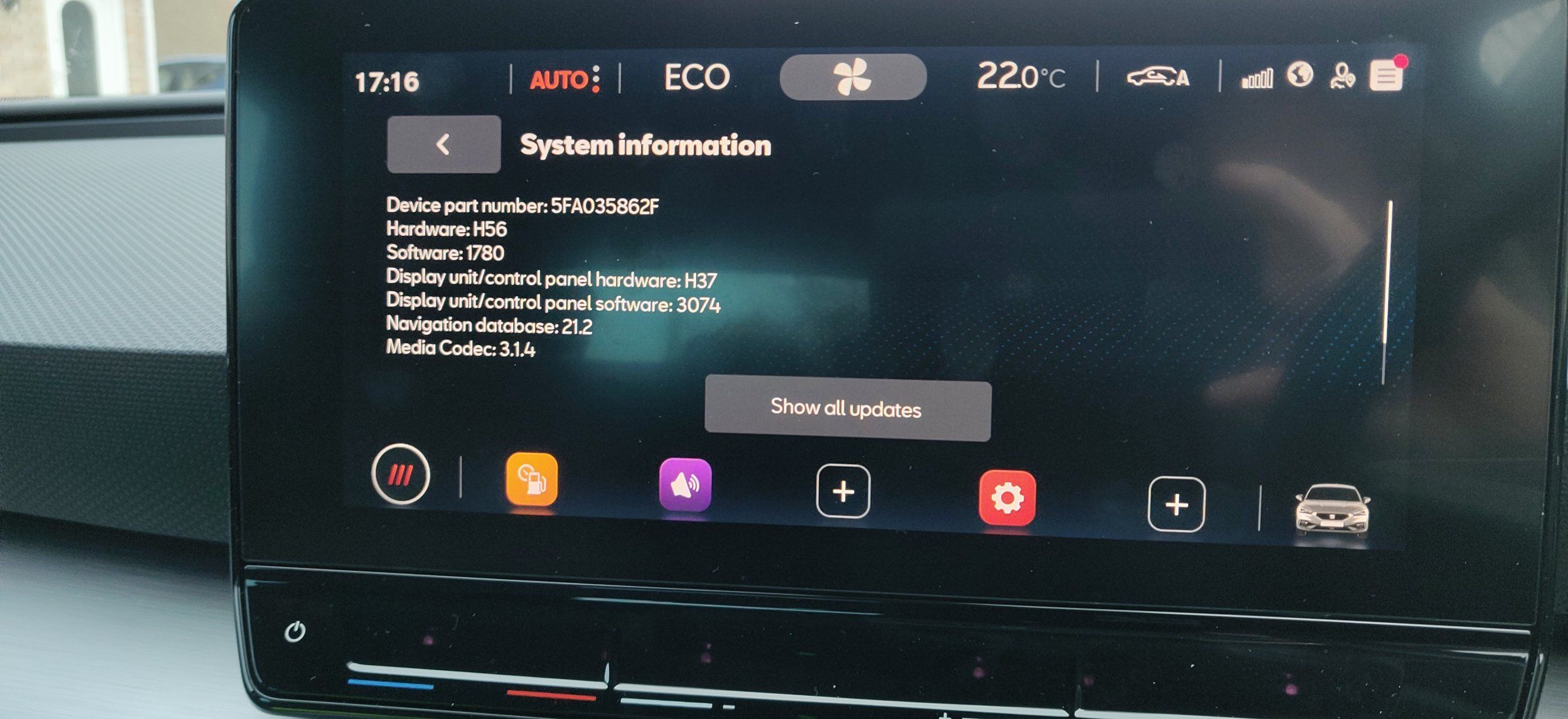

With the exception of the software number which doesn't seem to change after updates
We seem to have different device part numbers mine on my eTSI First Edition is 5FA035862 whereas scuj1(wireless AA) is 5FA035862D (same except for the D on the end)
The display unit hardware is also different mine being H37 whereas wireless AA is H39
I wonder if the D signifies a revision, which adds alot of things mine doesn't have

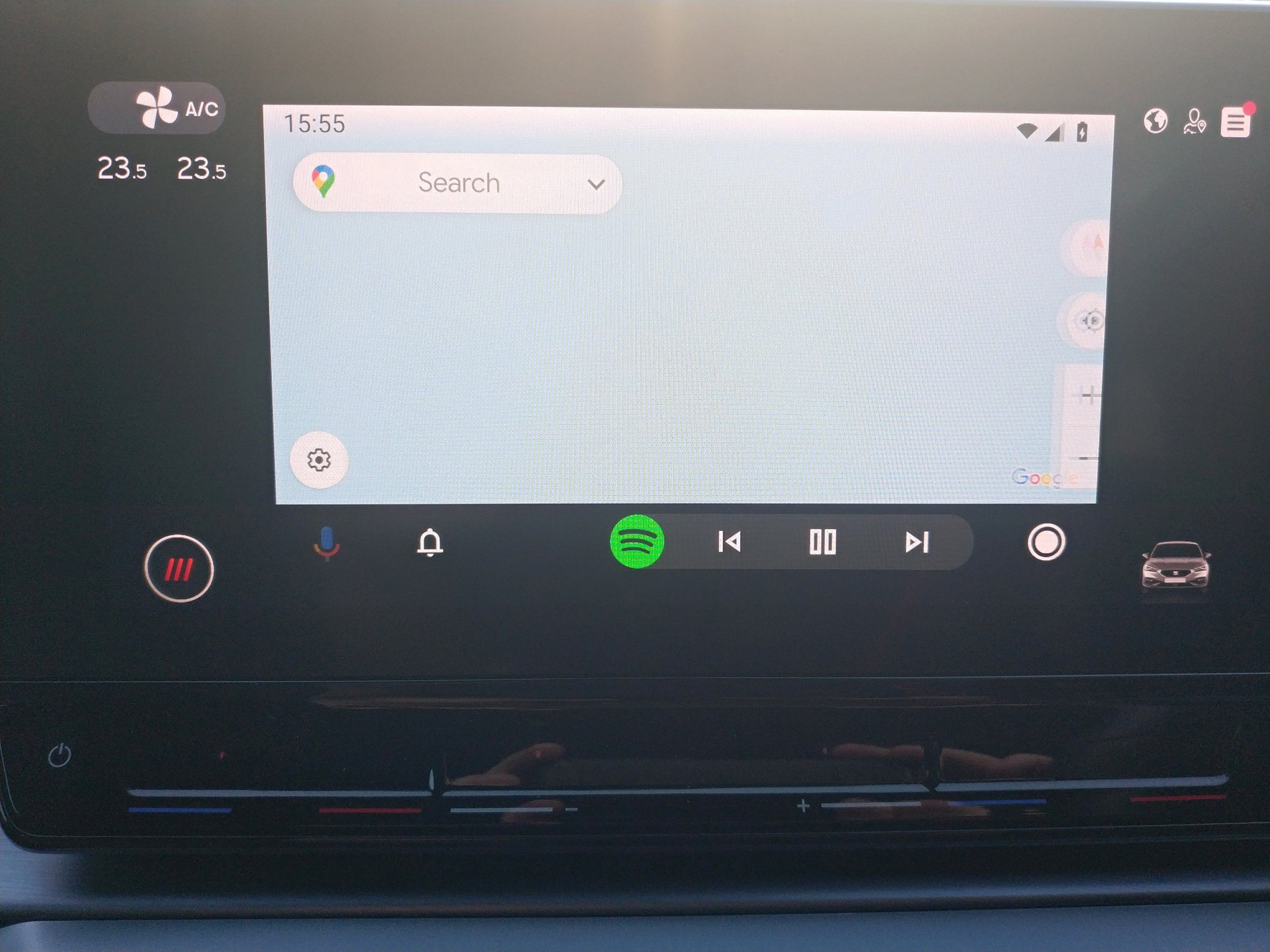

I prefer the look of the wireless AA, the large black borders are pointless especially when the car button can be moved to the other side and add a full 1cm+ of screen space

Part no. 5FA035862D
Hardware: H56
Software: 1788
Wireless AA working since yesterday :D

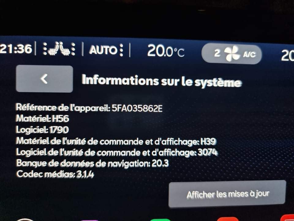

Device number: 5FA035862D
Hardware: H56
Software: 1790
Display unit/control panel hardware: H39
Display unit/control panel software: 3074
Navigation database: 21.2
Media Codec: 3.1.4
Leon FR 1.5 TSi 150, build week 50/2020

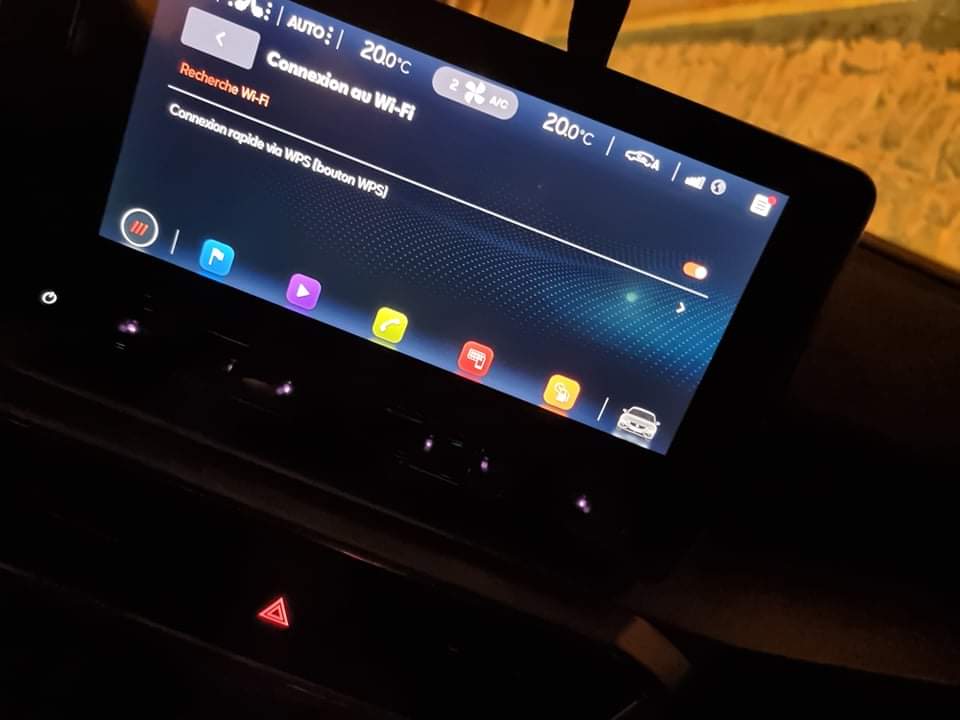

When i update the new version of software i lost the wifi
( wifi is activated but does not detect anything)so how i can do to fix it please thanks

Your best of starting a new thread.
Try holding the power button for 10+ seconds until you see the seat logo.
This reboots the system and should be the first thing you do with any technical issues on modern computers

I have done this without any result
