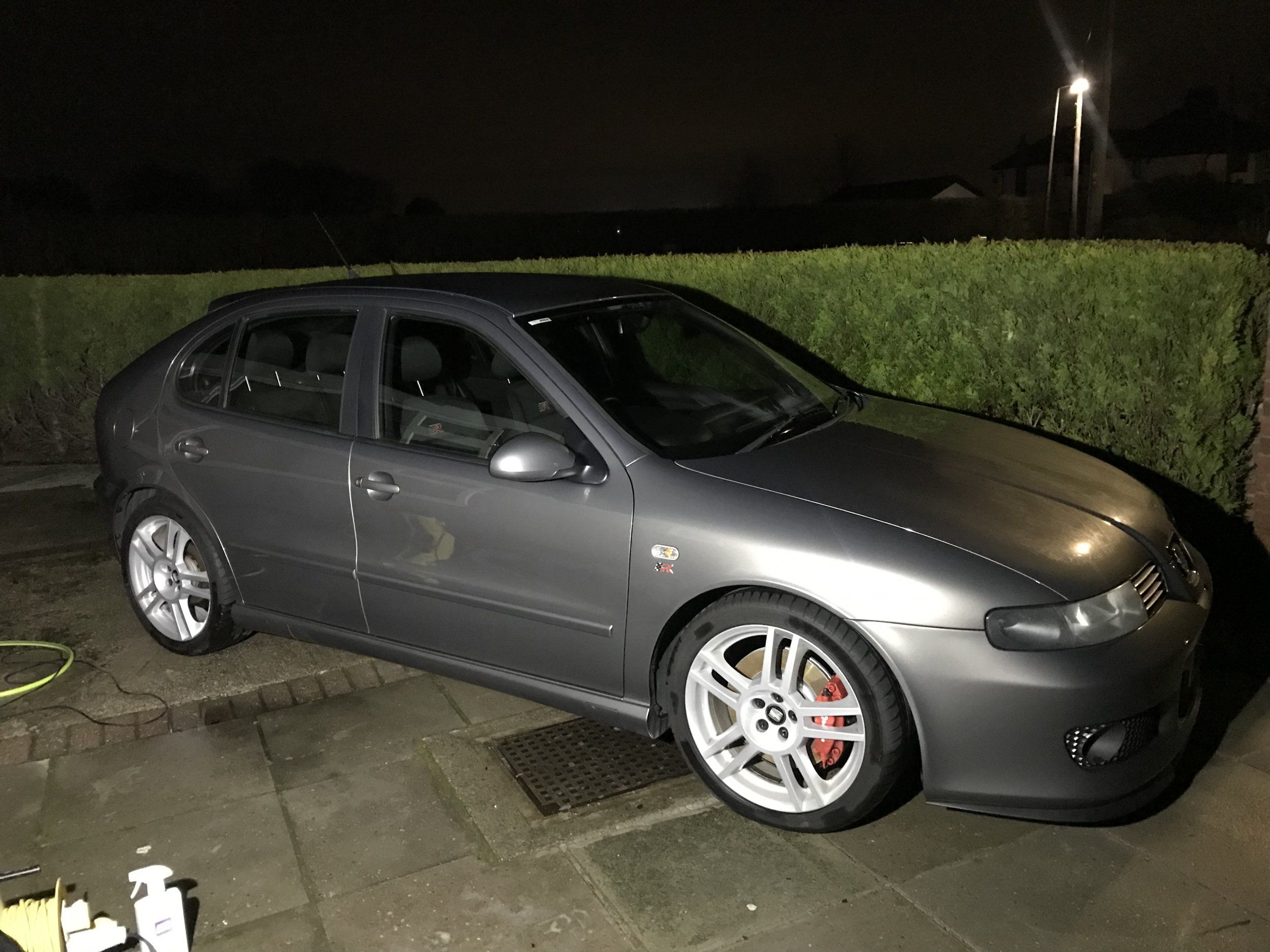

Finally had a couple of hours to wash mine today.
Not been washed since summer, but it has been laid up since then while we’ve been building an extension.
Had it under cover for the first few months but it’s been out for the worst months over winter. Covered in bird crap and even had green on the window rubbers. :eek:
Looking forward to spring to spend a full day on it but at least it’s had a wash.
Yes it was dark by the time I’d finished. Lol

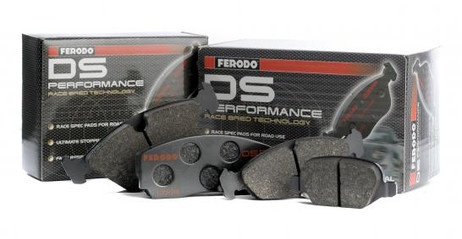

Brembo HP2000 could be an option. I can’t seem to find ferodo DS performance anywhere. Maybe they don’t do them for the Cupra R with brembos?? I’m hesitant about DS2500 since strictly speaking they’re not road use (I’m thinking worst case scenarios, insurance etc).

I know shocking. Especially seeing as I won the cleanest car award a couple of years ago at the Cupra.net annual meet. :ROFLMAO:
Luckily it came off without having to pressure wash the rubbers, don’t like doing that on the Leon.
Iron fall out, snow foam and a good soap and wash mitt got it off apart from one area which needed a bit of persuasion with a very soft tooth brush.
Hi,
The. bake pad isn’t something an insurer is going to start removing to see what you have on there.
Additionally, the 2500’s are a brilliant pad for road use. They warm up and bite properly after maybe braking 3 times.
Even cold they work.
People seem to think it won’t stop the car. Quite the opposite.
You may need slightly more force within first 2 mins of your drive but most of the time you just don’t notice.
The 2500 is great on road and you won’t experience fade or squealing.
They work on track but the car needs to be very light or they will overheat quite easily.
I use Carbotech xp10’s at present and they stay stone cold on a school run etc and squeal like stick pigs every time you come to a gentle stop. They still stop the car fine.
Also very good on track.
Now going to try Pagid Black Series.
Basically, don’t be put off. If your car is a road car you’ll be pleasantly surprised.
I wouldn’t use any other if mine was just a road car.

Thanks Sparkie. Its good to hear experiences of others. I'm most likely going to get the Brembo HP2000's. They seem like the closest replacement for OEM and I'm unlikely to be doing anything beyond some spirited road driving. I've got my Brembo calipers back from refurb now but need to sort out a few "issues". I'll update my thread on that when I have sorted them. I also bought some braided hoses from Badger5.
