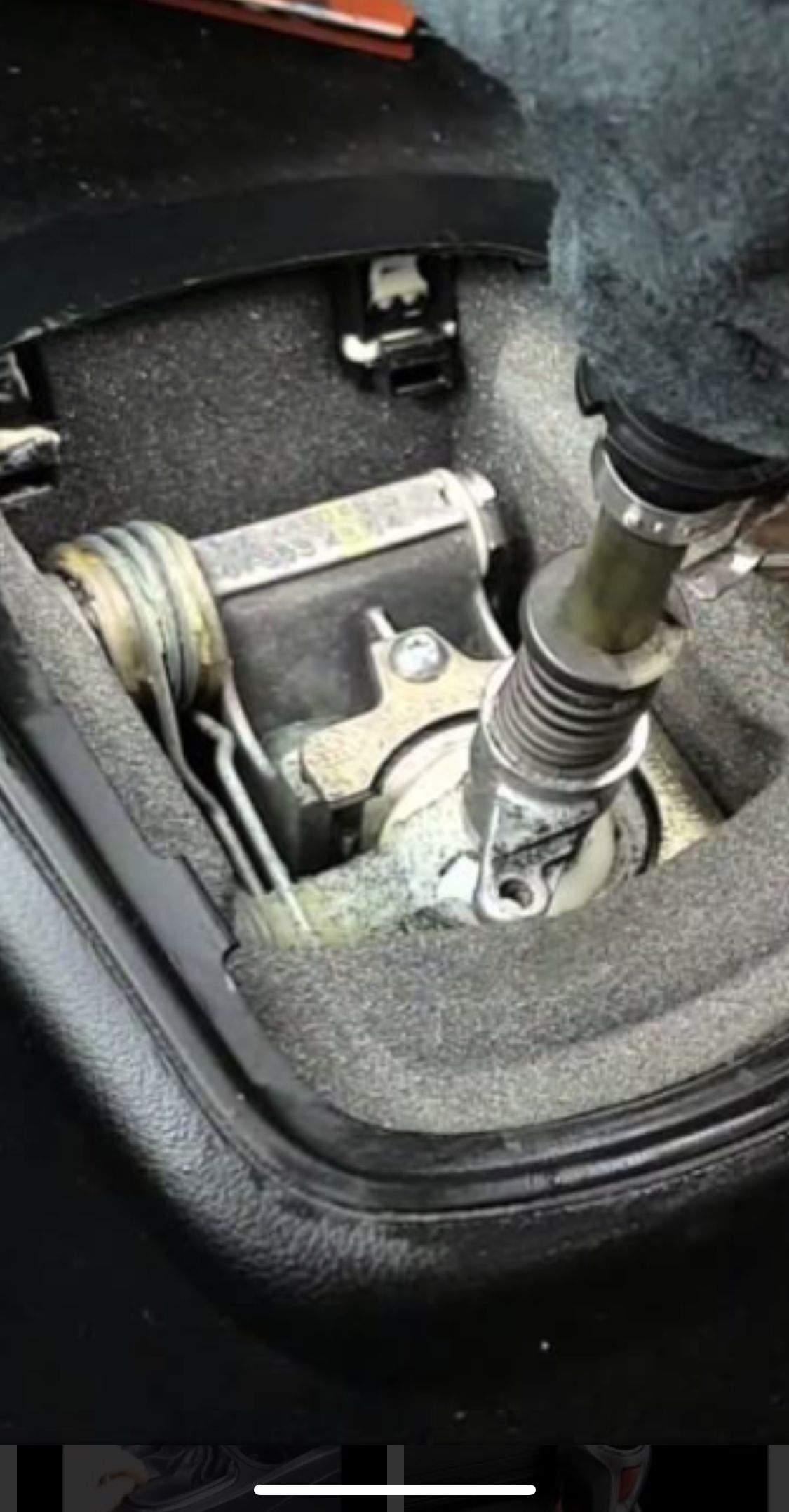

Cleaned underneath the gear stick and sprayed it all with lithium grease. Much smoother gear change now and well worth doing even if yours seems fine.

Be good for others if you’d written a guide - even on simple jobs
lol.
1. Unclip gaitor
2. Spray everything.
3. Reclip gaitor.

1 - Looking at the gear lever from behind, lovingly press the plastic base part forward, then lift.
2 - Lift the whole thing up to improve access (don't worry, the knob is fixed in place by a clip)
3 - There may be some foam there, pull it out, shouldn't be anything holding it in place
4 - Get the lube and spray the mechanism like you're on the top of the podium (anything you need access to shy of the actual rod ends is accessible, and even then a little ingenuity will get them too)
5 - If you want to do any adjustments like realigning etc, this is your chance
6 - In true Haynes style, refitting is the reverse
Reactions: Alexis27 and Rich.T

No. You can see which parts in particular need greasing if you move the stick and see how it works. There's the plastic ball, but also a balljoint to the left that needs a good squirt.
the linkage under the bonnet can get stiff that's worth looking at and removing too clean up and regrease if hard changing comes back
