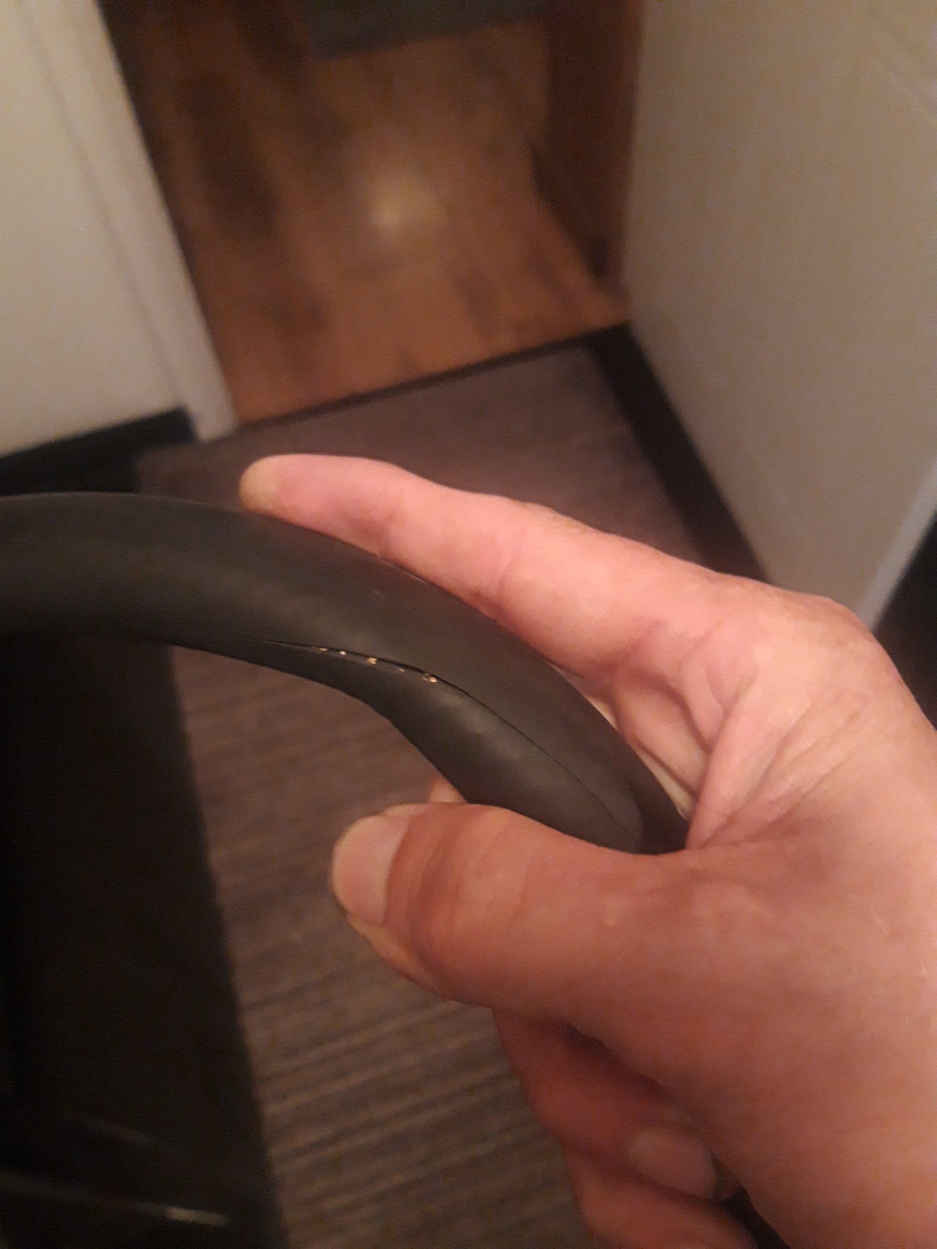

So, decided a few weeks back to go vent to atmosphere with my catch tank.
Ordered the hose from Ebay and it turned up soon after. Left feedback and got on with my life.

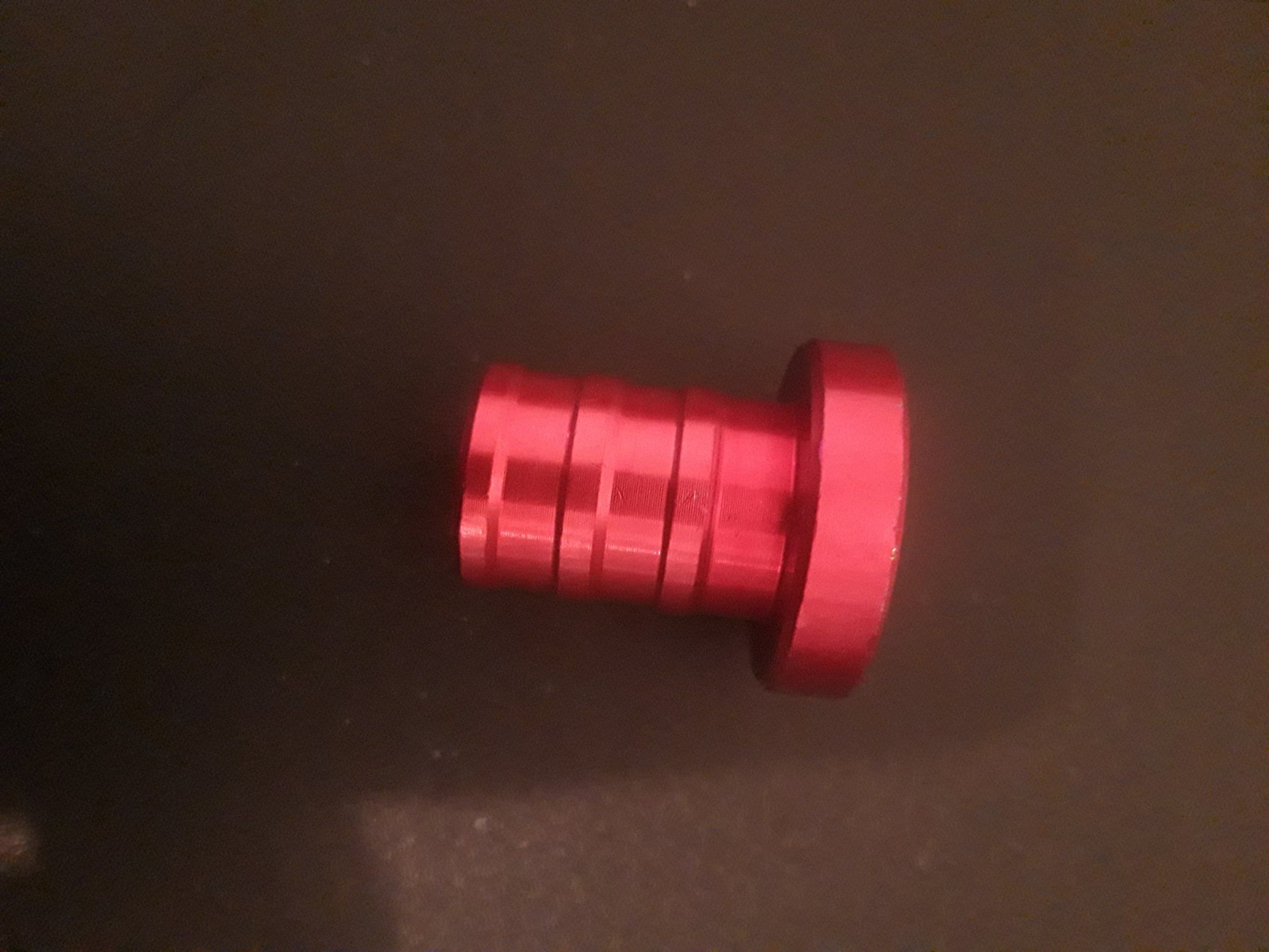

Also ordered an ally bung to cap off the hole in the tip.
Just opened the bag that the hose came in and its got splits in it!
Not all the way through but if you twist it you can see cords.
Im going to use it now as i want to fit it tomorrow and it basically attaches to the outlet and drops down to just below the subframe.
Note to all, if you buy something off the internetz, check it straight away.
The bung looks ok and just hoping ive ordered the right size.

Done!
Blocked off the hole in the tip.
From the outlet of the catch tank ive got about 6 inches of hose to the puck. Then out of the puck is the pipe that now runs down to the subframe exiting at the rear of the nearside inner arch.
Will run the car for a week or 2 and report back if there are any findings.
