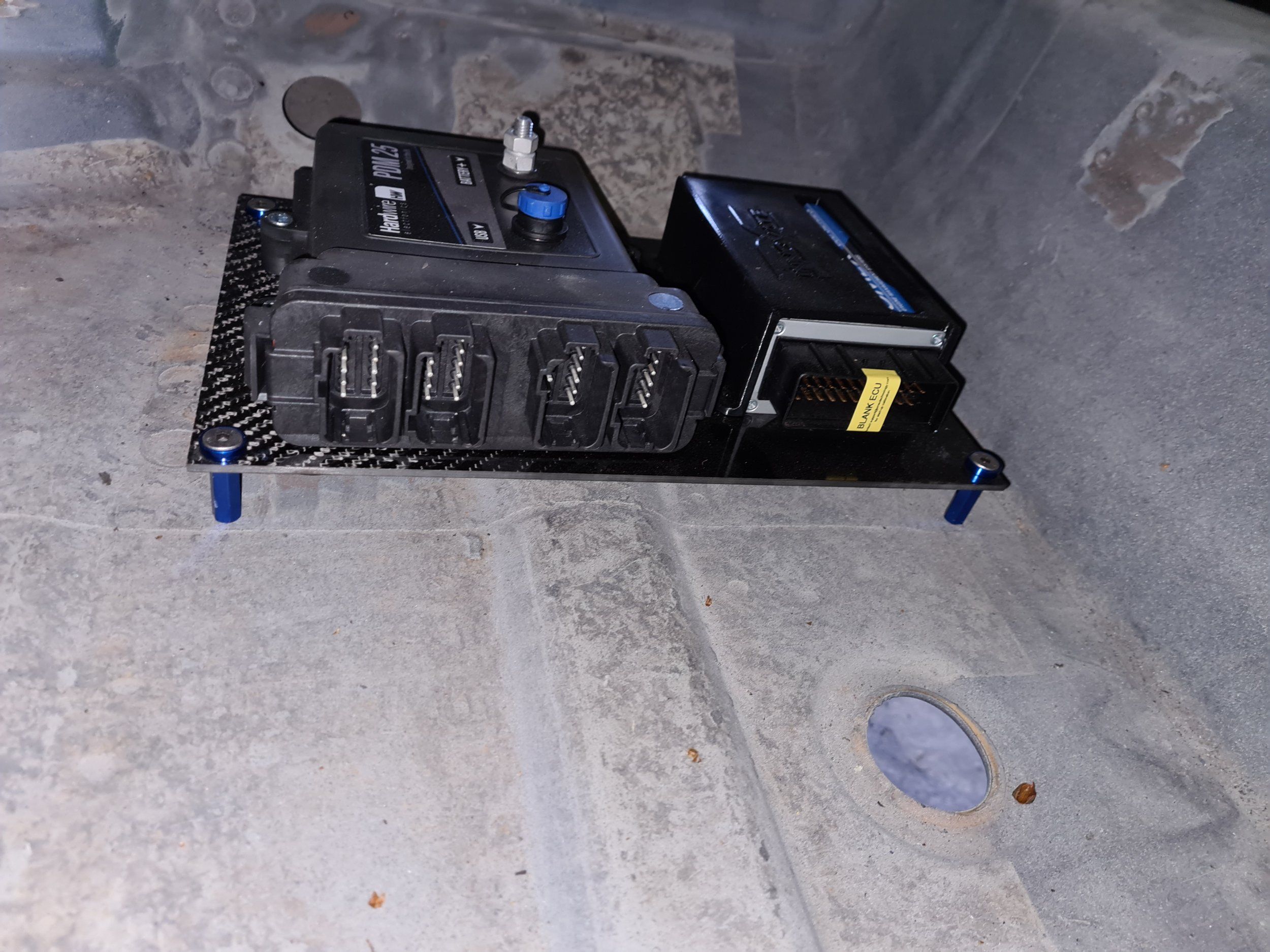

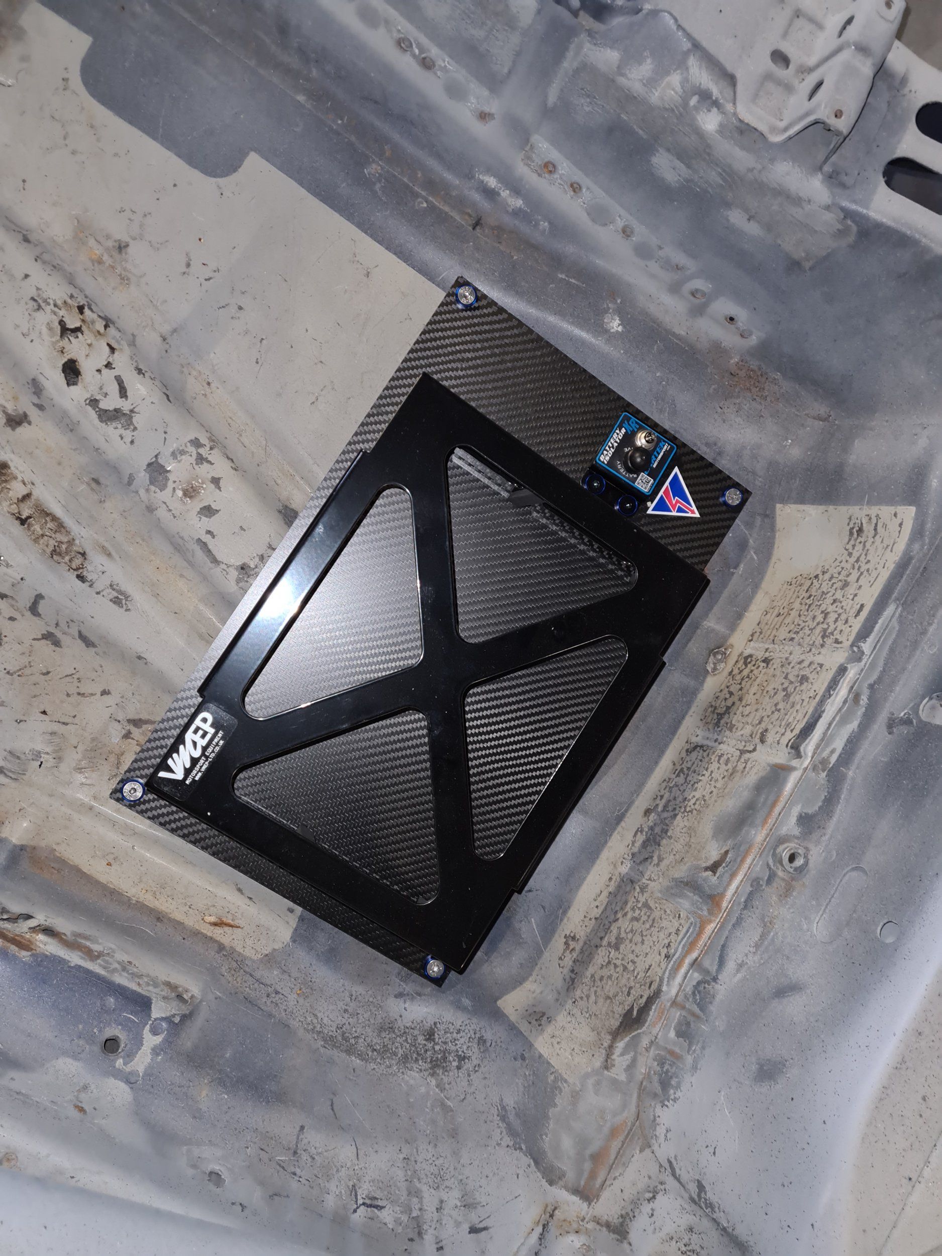

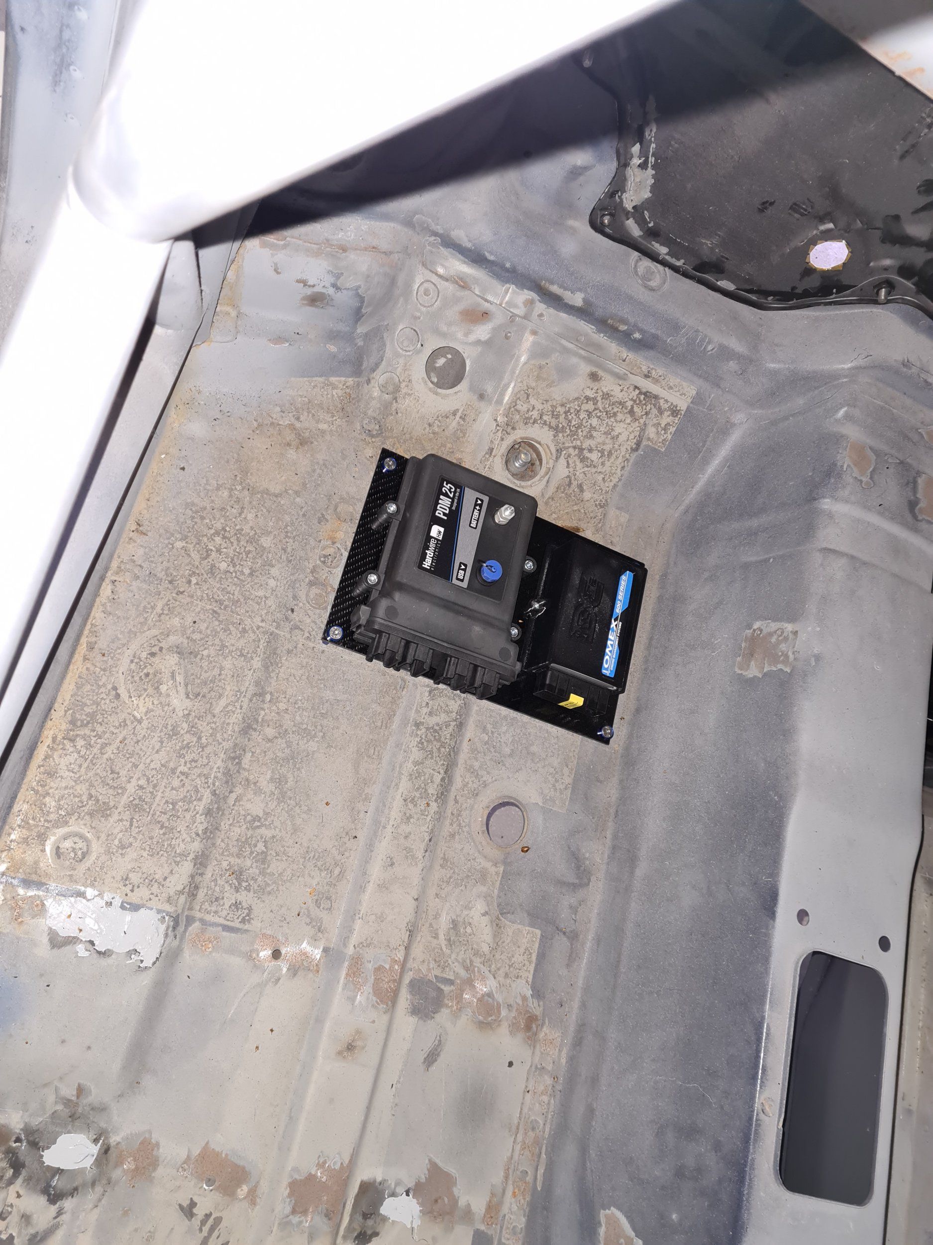

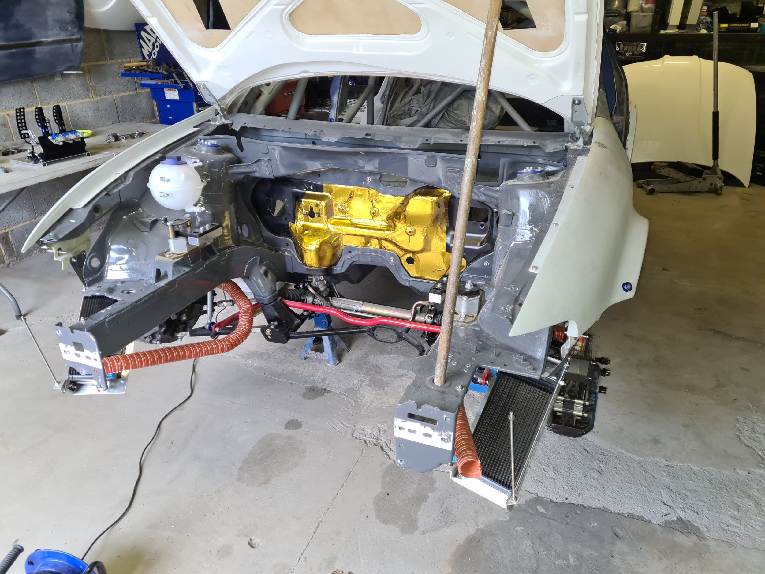

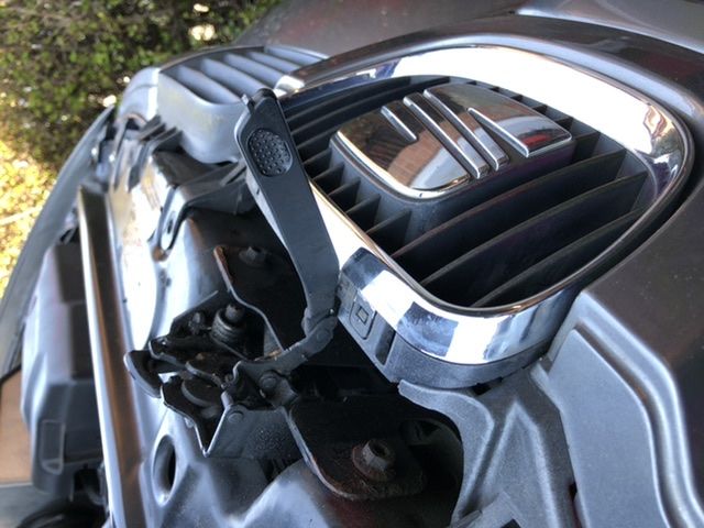

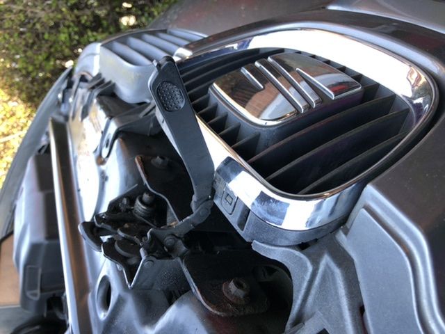

Afternoon all. Sorry about the lack of updates and stuff . But basically I not done much to show just more messing about trying to make stuff fit.
Nothing on this car fits. Every thing has to be modified to work.... its now getting frustrating... but here's a few pics. Will do a bigger up date on the readers rides section
