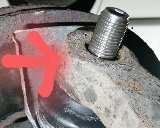

The ball joint.
Youve put that you have been hitting it from underneath?
This is where you should be hitting it.
Not trying to teach you to suck eggs. I may have read your post wrong.

The ball joint.
Rich
Yeah - you read right actually - I was doing it wrong. That's the same technique as for the tie rods, isn't it?
I'll try again in the morning - the right way. In the meantime I've just sprayed it again with penetrating lube. There's a lot of much that seems to be coming out of it when I spray, so it seems something is happening.
