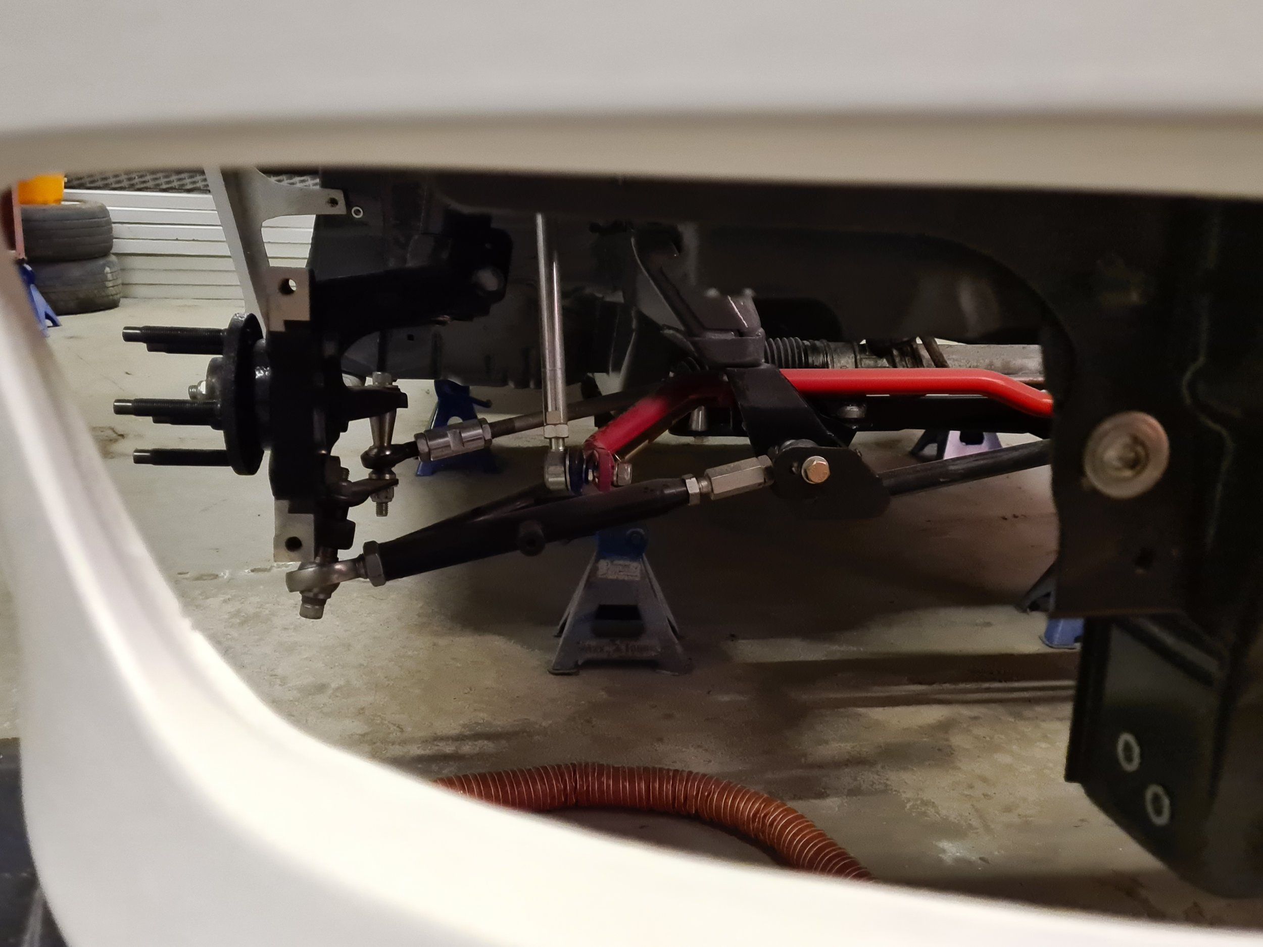

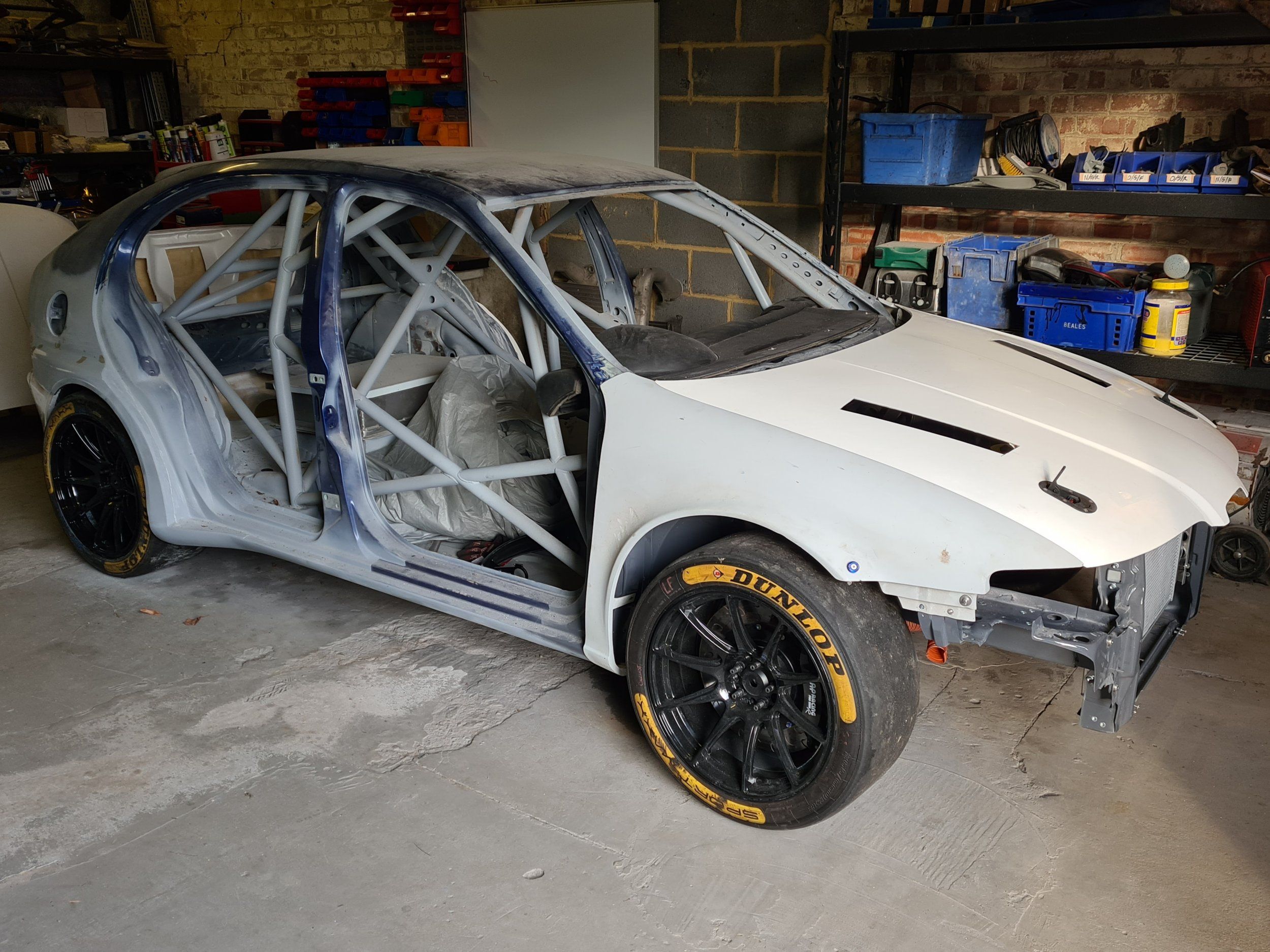

Had a tidy up and a move about . Had to put the wheels on . Oh she looks nice...
Had a nightmare with the coolers as the bumper curves. So having to have a rethink on the lay out and the positioning. . But nice view threw the old fog light hole.

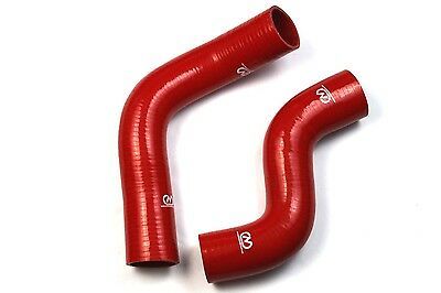

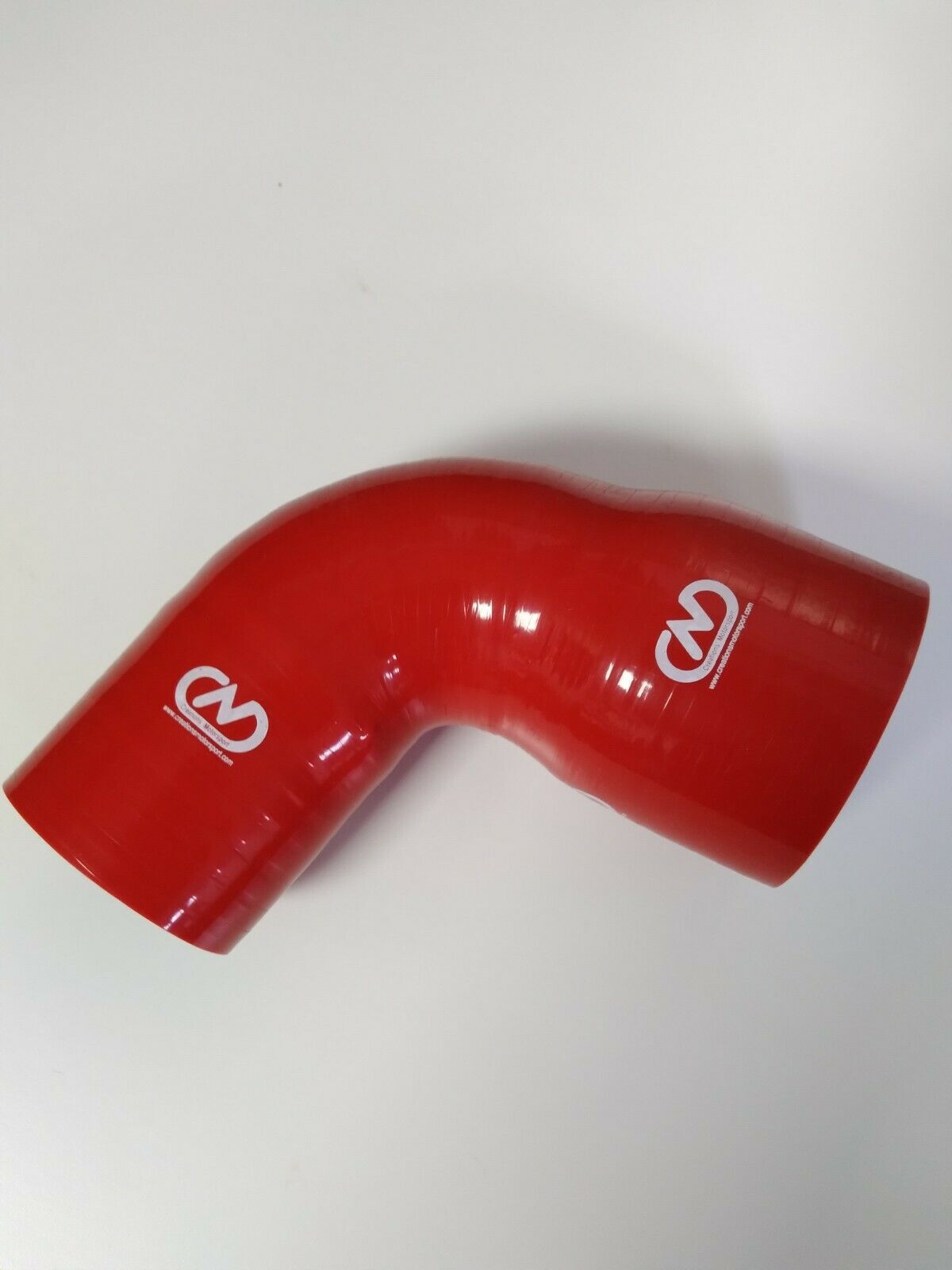

Yesterday i replaced 4 sections of hose on the car. 1st was the cold air feed pipe (controversial lol) to the air filter. Thought it was going to be a bumper off job as when id had the bumper off previously, id left the plastic piece off behind the headlight that the original pipe attached too.
Turns out the new pipe is so big that by the time id trimmed back the plastic behind the headlamp, there wouldnt be a lot left of it. So left it out.
3 inch diameter.
Also fitted the elbow from turbo to hot pipe, pipe to inlet manifold, and from hotpipe.
The elbow went on easy and was a good fit. The 2 others on the other hand were the devils work. Both needed trimming. Also due to the lack of stretch they were an efing tight fit!
Give yourself a good hour if your going to fit these.
On the plus side, driving the car, it felt a lot snappier and responsive. But could just be a placebo affect.
I'll see how it feels this week.
