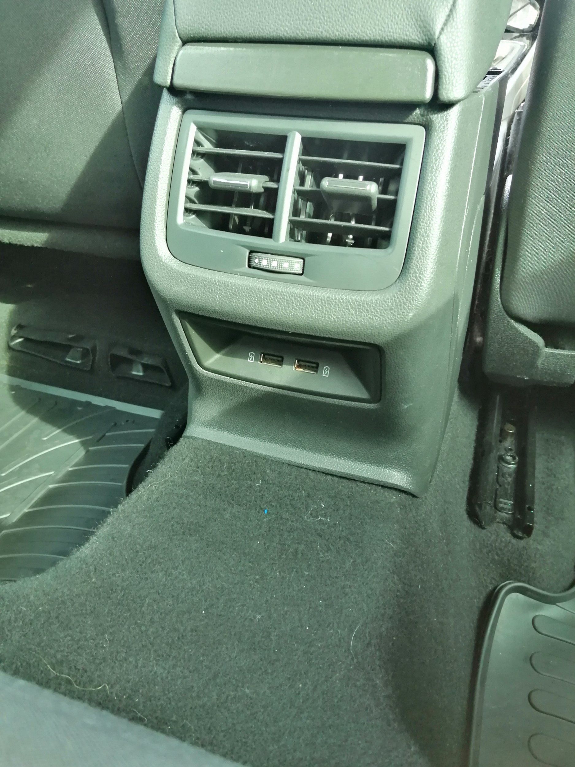

Gents,
Left the mk3 world and got a ateca. Now there’s a mk3 300 but it’s a manual. My mk3 I had was a 184 st dsg. What are the manual boxes like on the 300

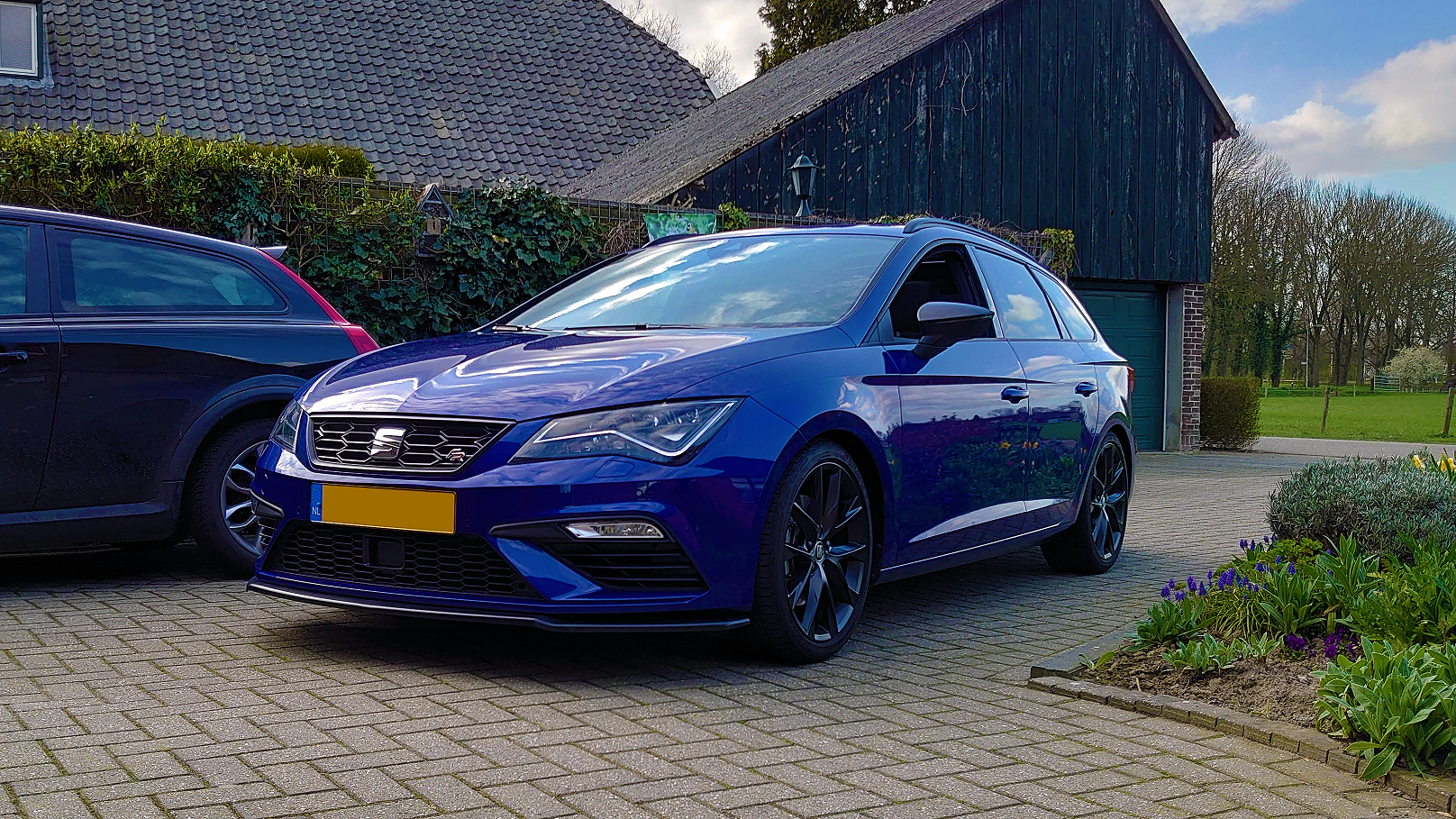

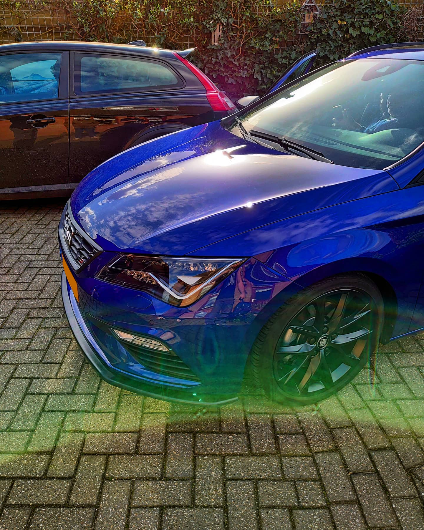

Put a Maxton lip on her. Was a fun install, the first "big" thing I've done on a car since covid started.
Next up: sideskirts. And still in doubt about removing the center exhaust muffler...
