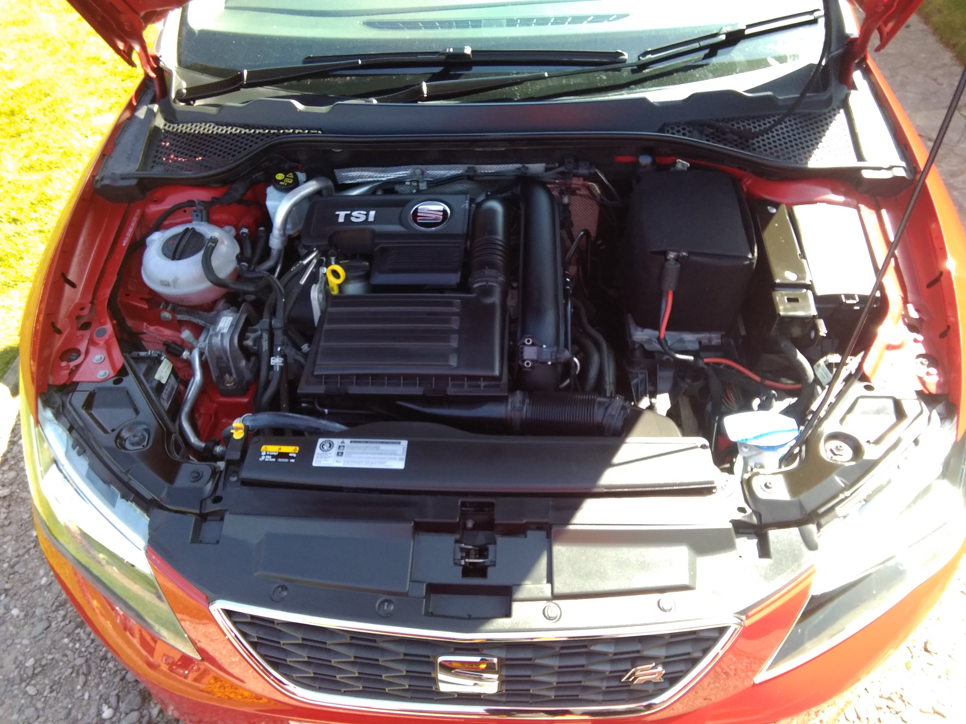

Cleaned the engine bay
Didn't come up to bad.

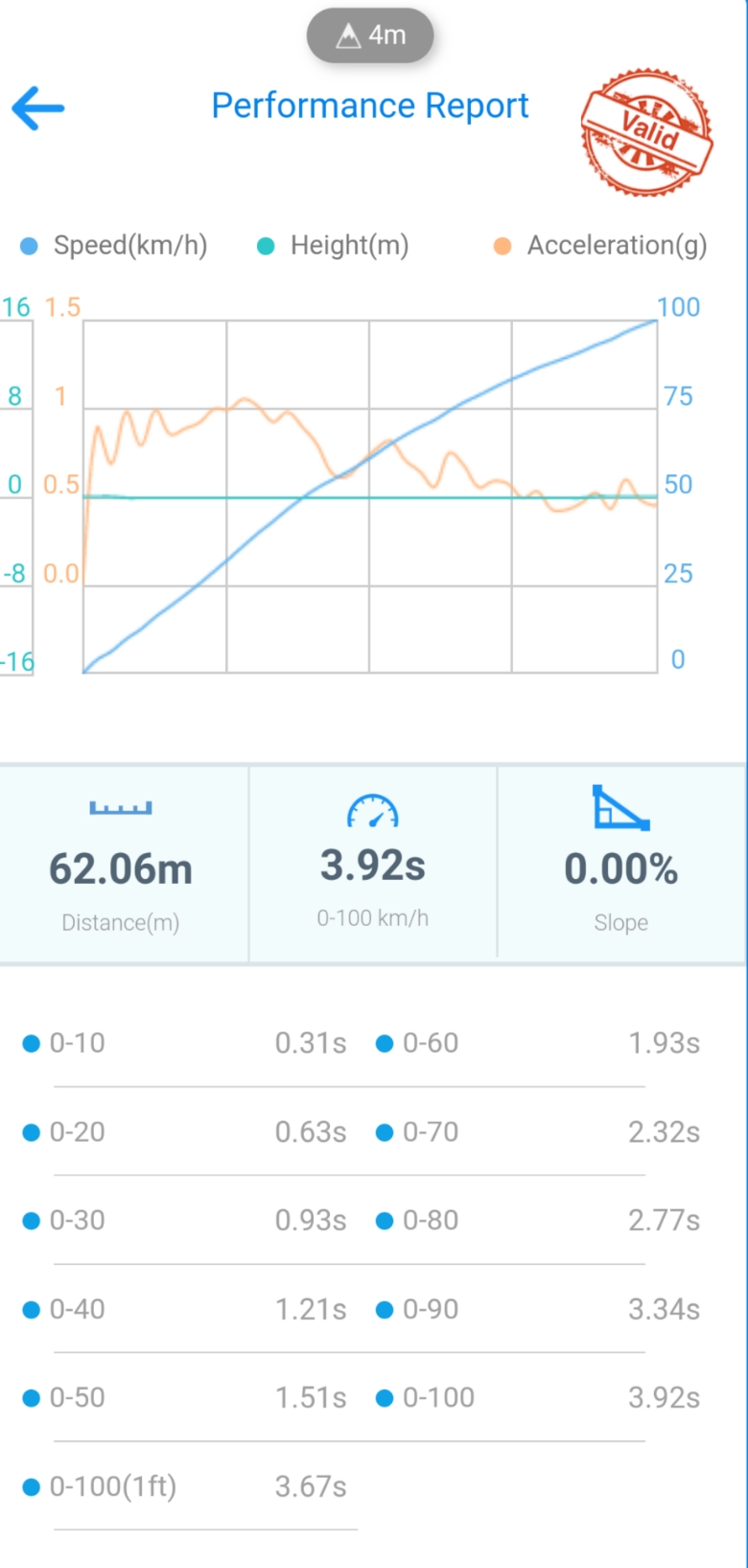

I don't often try launch control but thought I'd check how quick it is today. First try was 4.04s on my normal map 6 but then remembered George from Burger Tuning saying it is not happy with too much boost past 5.5-6k when using LC so then I cut boost quite a bit up top on my JB4 map 6, still a decent run for my winter wheels setup. :)
0-100 km/h 3.92s (0-60 mph 3.7s).
