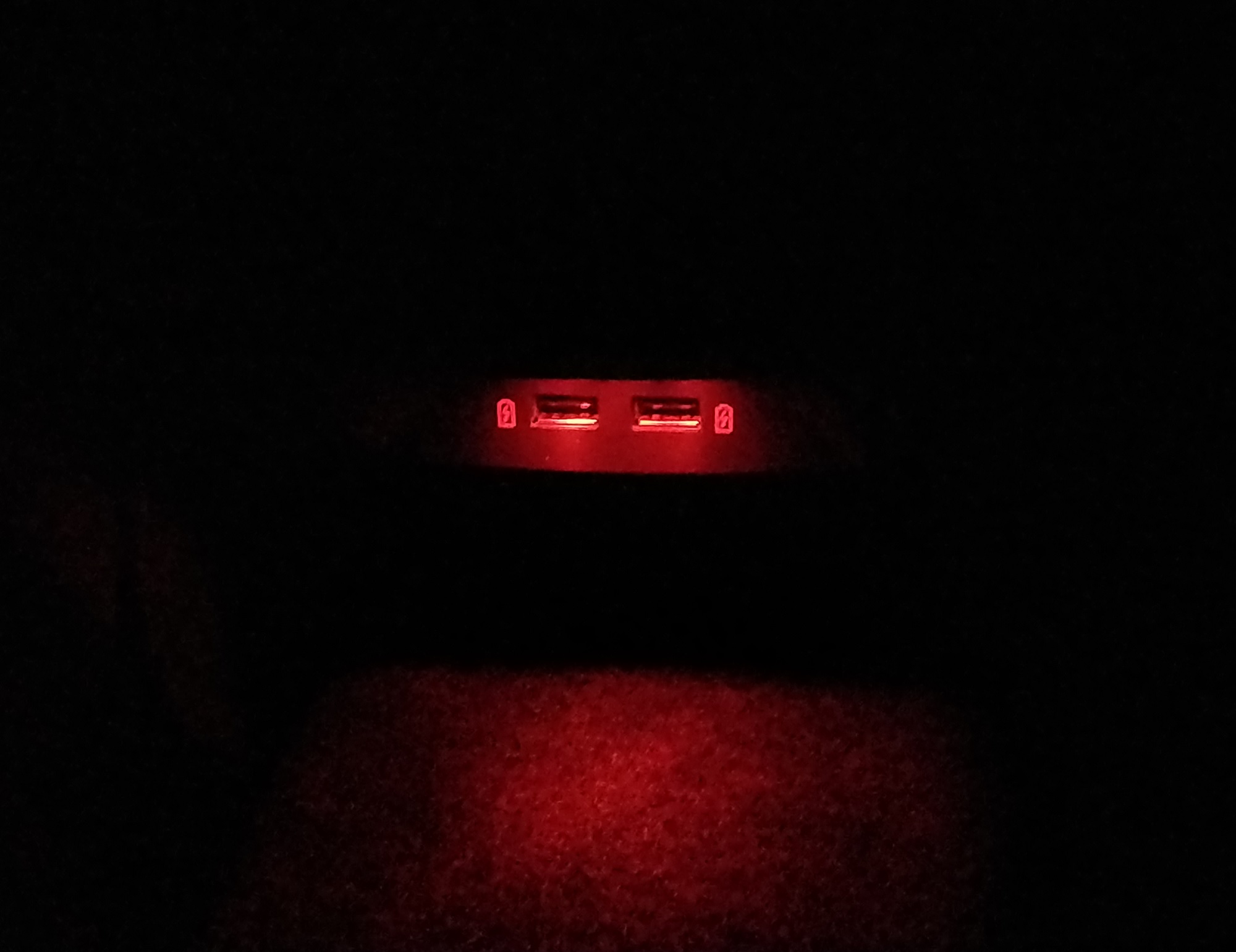

wow, that's a nice little touch. Where did you get the lights from and where did you connect them?
I used these.....
https://www.amazon.co.uk/gp/product/B0832L6JBB/ref=ppx_yo_dt_b_asin_title_o02_s00?ie=UTF8&psc=1 and one of these.....
https://www.amazon.co.uk/gp/product/B078MFFK8S/ref=ppx_yo_dt_b_asin_title_o03_s00?ie=UTF8&psc=1
but I would think any 12V LED would do. I ran cables to the left and right footwell lights to get the supply and the earth behind the panels at the ends of the dash. By getting supply from the footwell lights means that these dim with them.
Some cars have the one under the air con panel, but I couldn't find any part numbers
