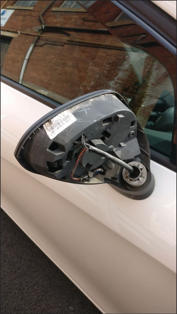

Some low life scum stole both my FR wing mirror covers.
:censored: Sake. Gotta wonder how much they could even get for them. Not even a thought that it'll obviously leave you out of pocket more than they'd make selling them.
