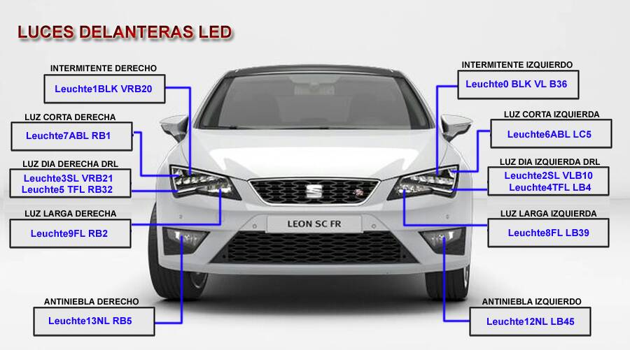

Front fogs with main beam (and not with headlamp flash)
LEFT SIDE
Leuchte12NL LB45-Lichtfunktion C 12 > not active > “left high beam”
Leuchte 12NL LB45 Dimmwert CD12 “0” > 127 (use value 127 for LED fog light bulbs, and 100 for normal halogen fog light bulb)
Leuchte 12 NL LB45 Dimming Direction CD 12 “maximize” > maximize
RIGHT SIDE
Leuchte13NL RB5-Lichtfunktion C 13 > not active > “right high beam”
Leuchte 13NL RB5 Dimmwert CD 13 “0” > 127 (use value 127 for LED fog light bulbs, and 100 for normal halogen fog light bulb)
Leuchte 13NL RB5 Dimming direction CD 13 “maximize” > maximize
Front fogs with main beam AND with headlight flash
As above, but two additional channels to change
LEFT SIDE
Leuchte 12NL LB45 Lichtfunktion D 12 “not active” > Lichthupe generell
RIGHT SIDE
Leuchte 13NL RB5 Lichtfunktion D13 “not active” > Lichthupe generell
Front fogs on with headlight flash only, and NOT main beam
LEFT SIDE
RIGHT SIDE

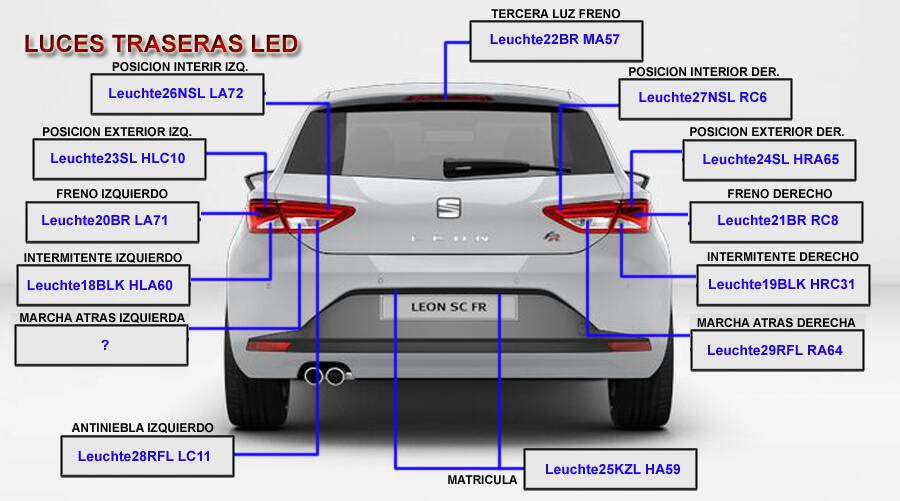

Hope this helps someone! I've attached a couple of pictures showing the designation of the LED light arrangment on the Leon. Ignore differences in LHD/RHD, the designation for the left side UK reverse is the same as the left side European rear fog, and the right side UK rear fog is the same as the right side European reverse. It's just the coding that's different to give the same lamp position its different function (left lamp coded for reverse on RHD/fog on LHD, right lamp coded for fog on RHD/reverse on LHD)

Rear LED strips and/or front DRL strips on whenever doors are open - ignition on or off (independent from coming home/leaving home) - Leon 3 prefFL with LED tech pack
Good safety feature, rear lights on as soon as the door is opened, making it safer to exit the vehicle or get something out of the boot, when parked on the road in the dark. Same way as Fords have been coded for years now.
Coding here for the rears, and fronts, choose front lights, rear lights or front and rear:
REARS
There are 3 lines of coding for each of the 4 rear light clusters (left inner, left outer, right inner and right outer)
Inner left cluster
1. Leuchte26NSL LA72-Dimming Direction EF 26 - set to value MAXIMUM (might originally be set to either maximum or minimum)
2. Leuchte26NSL LA72-Dimmwert EF 26 - set to value 127 (sets intensity of LED, needs to be 127, not 100) (will be originally set to 0)
3. Leuchte26NSL LA72-Lichtfunktion E 26 - set to value INTERIOR LIGHT (will be originally set to INACTIVE)
Outer left cluster
1. Leuchte23SL HLC10-Dimming Direction EF 23 - set value to MAXIMUM (might originally be set to either maximum or minimum)
2. Leuchte23SL HLC10-Dimmwert EF 23 - set value to 127 (sets intensity of LED, needs to be 127, not 100) (will originally be set to 0)
3. Leuchte23SL HLC10-Lichtfunktion E 23 - set to value INTERIOR LIGHT (will be originally set to INACTIVE)
Inner left cluster
1. Leuchte27NSL RC6-Dimming Direction EF 27 - set value to MAXIMUM (might originally be set to either maximum or minimum)
2. Leuchte27NSL RC6-Dimmwert EF 27 - set value to 127 (sets intensity of LED, needs to be 127, not 100) (will originally be set to 0)
3. Leuchte27NSL RC6-Lichtfunktion E 27 - set to value INTERIOR LIGHT (will be originally set to INACTIVE)
Outer right cluster
1. Leuchte24SL HRA65-Dimming Direction EF 24 - set value to MAXIMUM (might originally be se to either maximum or minimum)
2. Leuchte24SL HRA65-Dimmwert EF 24 - set to value 127 (sets intensity of LED, needs to be 127, not 100) (will be originally set to 0)
3. Leuchte24SL HRA65-Lichtfunktion E 24 - set to value INTERIOR LIGHT (will be originally set to INACTIVE)
If you want the number plate lights to come on as well, also recode the following 3 lines
Number plate lights
1. Leuchte25KZL HA59-Dimming Direction EF 25 - set value to MAXIMUM (might originally be se to either maximum or minimum)
2. Leuchte25KZL HA59-Dimmwert EF 25 - set value to 127 (sets intensity of LED, needs to be 127, not 100) (will originally be set to 0)
3. Leuchte25KZL HA59-Lichtfunktion E 25 - set to value INTERIOR LIGHT (will be originally set to INACTIVE)

Leuchte 5TFL RB32-Dimming Direction EF 2- set to value MAXIMUM (might originally be set to either maximum or minimum)
Leuchte 5TFL RB32-Dimmwert EF 2 – sets intensity of LED strip – set value to 35 for parking light intensity, or set value to 100 for DRL intensity
Leuchte 5TFL RB32-Lichtfunktion E 2 – set to value INTERIOR LIGHT (originally will be set to INACTIVE)
If you use the search facility to find the relevant lines, note that for the 3 adaptation channels for the right side you need to search for Leuchte 5TFL
(there is a space between Leuchte and 5TFL)
Remember, no space searching left side, but a space needed when searching the right side

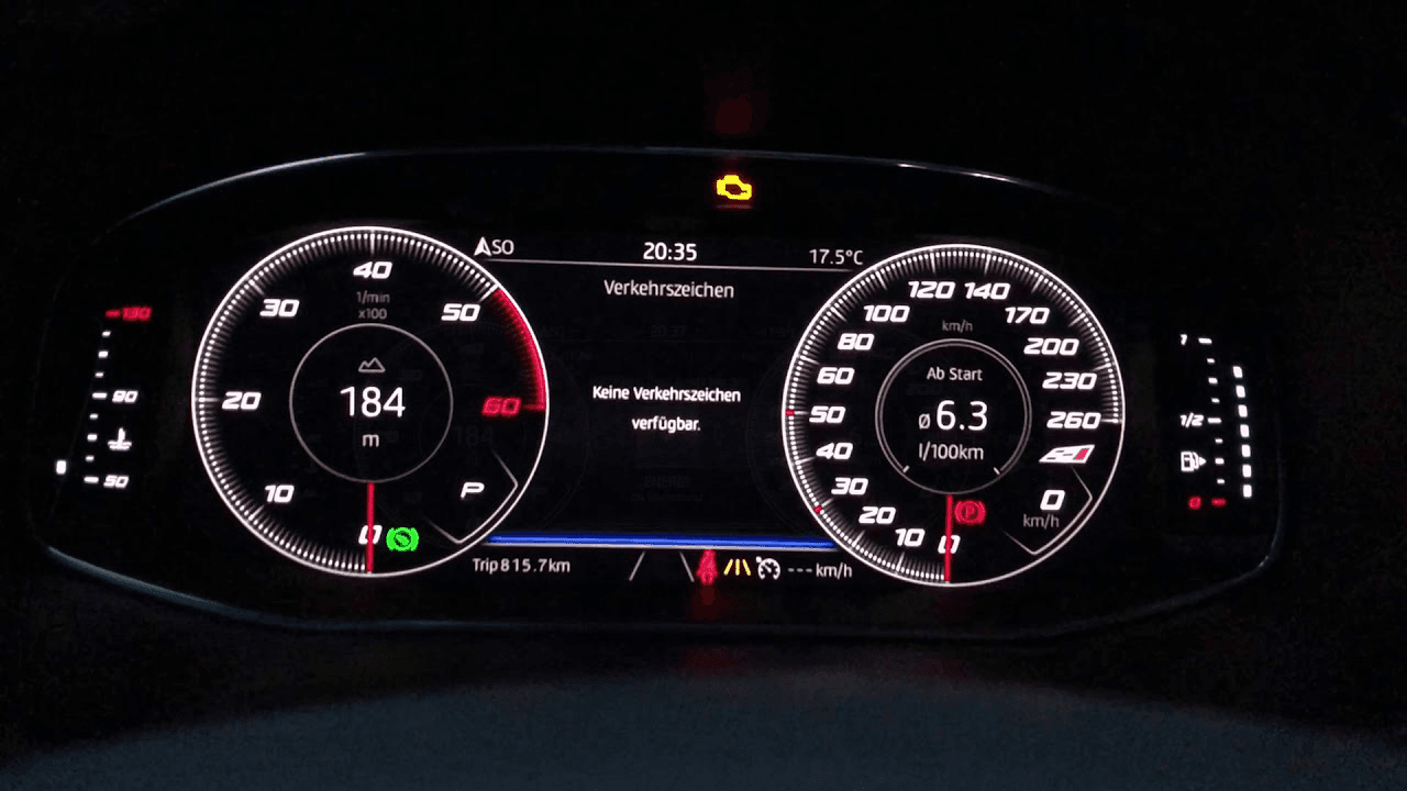

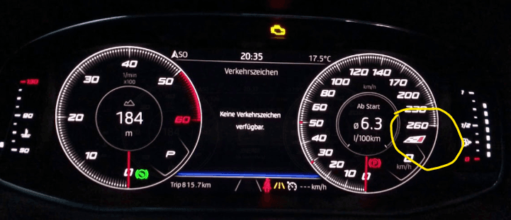

Has anyone with VCDS looked at the enabling the sport mode on the Virtual Cockpit and added the Cupra Flag?
Recently got my VC updated to the newer Rev A unit, but the Cupra flag was missing. Wondering if anyone knows a way of adding it:
Original:
My new Rev A unit now, only photo I have, but missing from all the views.
Other VC:
Actual Cupra:
FR Diesel:
So I'm assuming there must be a way of adding it.

Hi friends! I need a little help. A friend of me has a 2014 Cupra 5door, but in the car menu there is a 5 door Style... Me has a cupra ST, so not the same... Could you please tell me the Bits in the 5F controller, Long coding. I mean who has the same 5door cupra. It would be nice to make a photo about the 1-2-3 Byte, and the actual Bits. Thanks a lot!
Kisszabo
Aug 25, 2015
31
Hungary - Győr
Just another question... What does value mean? Value = bit? How comes out the 5door cupra, in Byte 2?
Byte 2
Value 1 = 0 normal, 8 CUPRA
Value 2 = 0 5dr, 2 2dr, 3 ST, 6 ateca
Which Bits need to click in?
Thanks

Sorry, only just seen your reply. For 5 door Cupra, coding is Byte 2 Bit 1 - set to 8. Byte 2 bit 2 - set to 0. you will need to do a factory reset of the infotainment unit for the changes to take effect
Thanks for your reply - as is saw, at the early 2014 models cannot change.... I restart the main unit, but the car menu can show only a 5door / or a St model. Cannot FR, Cupra, etc.
