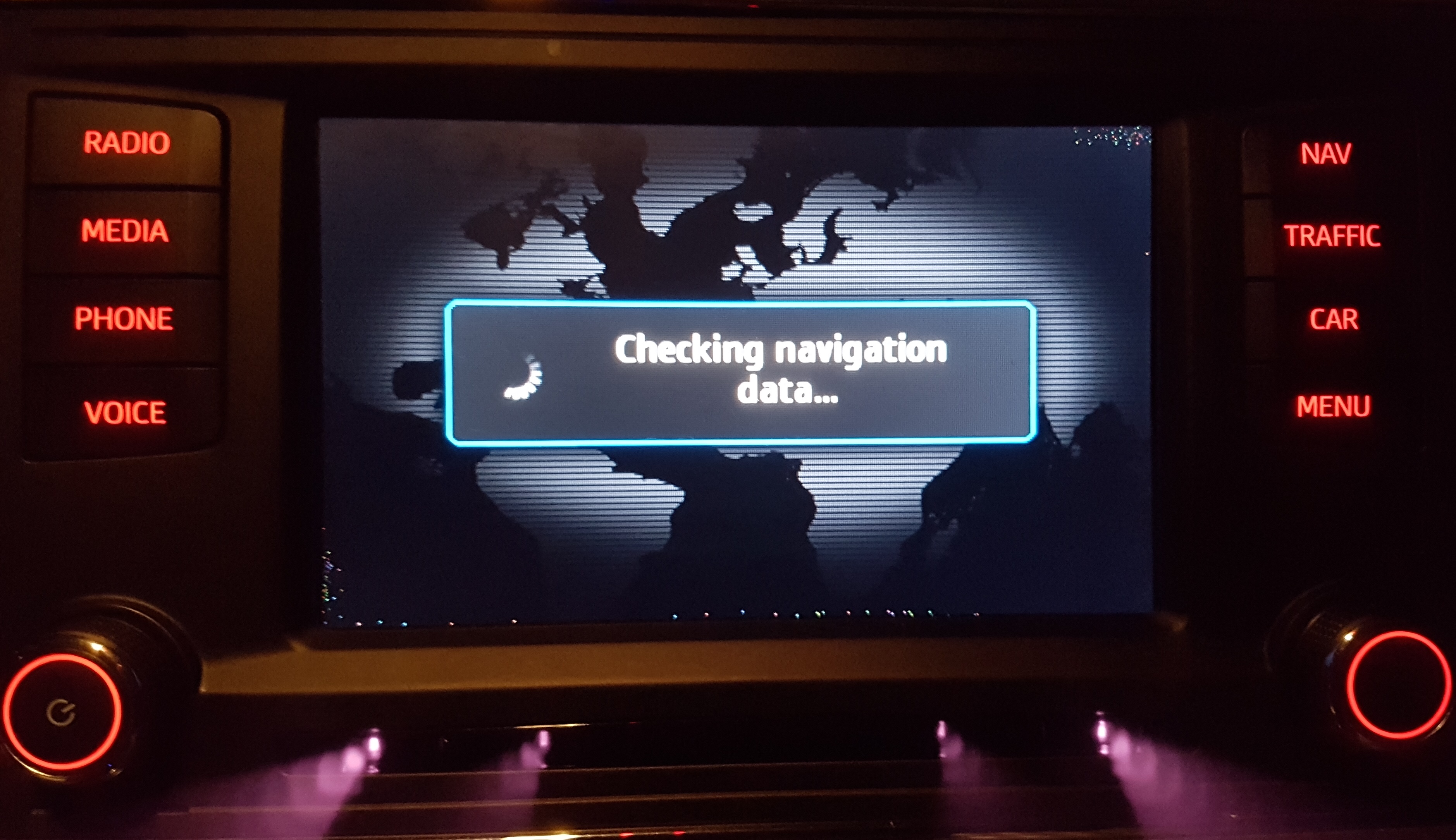

Well I swapped out my old SD Card with this brand new one and got the "checking navigation data" screen for about a minute but when that was complete the Nav data basis remained 0021 ECE 201 as before :doh:
Have emailed SEAT in the hope that someone on their parts team can give me a definitive answer as to which SD Card I should in fact be purchasing for my Mib1 unit.

Did you get an error message saying data not valid or something like that?
Also you need to tell the system to update, I don't think it will update otherwise, but may be wrong.

After I put new SD card in Slot B of glovebox reader unit (where the old card had resided) and switched on ignition, this message popped up for approximately 60 seconds.
Then switched off ignition and put back the old SD Card and same popup appeared again. There’s no instructions inside DVD case that new card came in, so perhaps I’ve overlooked a step.
We are talking about the standard Mib1. To me you got the same card again if Navi still worked.

Settings etc should give you the navigation year it's using.
This is the System Information I get under Settings menu, exactly same for both old and new SD Cards. Maybe I should just leave things as they are, lest my SatNav send me to Wolfsburg too!
