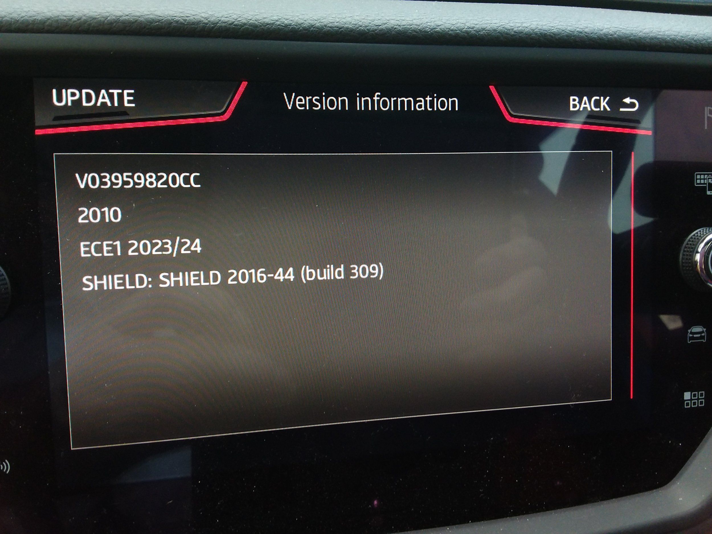

So tried the day one from Skoda, straight replace, Navi booted up fine, Date in software shows 6P0919866 0430 ECE 2015-16.
Tried the DiscoverMedia2 EU1 1910 V16 you posted from June, straight overwrite and into car slot 1. Took a while and booted in, Date on software shows V03959817TG 1910 ECE1 2023. No messing with the NDS file from previous versions.
Success. Thank you.
So now the Nav instead of 6P0 is showing V03. Is this a issue going forward?
Should the shield: shield 2016-44 build 309 be updated at somepoint? If so how?

Ok remember what you did for next time.
The V03 is picked out by the mib2 firmware. It doesn't mean anything. Probably the people who manufactured the release were lazy or not. Within the update file there will be a line in that which allocates Seats to V03. Just shows that on the screen. The original all Europe release always came up as 6Pxxx. Thats the Seat part number of that release. The release includes all part numbers of VAG brands. It just throws up the part number for that release for brand... all one release for all brands.
The Shield business names come from it running Nvidia Tegra chip where they like to use the word "Shield". What I told the last person that asked that. It runs QNX... 😂. I reckon that's where that comes from. Probably the boot loader. Any advance on that welcome.
It would only be the firmware that you could consider updating but I wouldn't if it's working fine.
Makes sense, Nvidia always likes to hold onto a name for ever, geforce anyone.
Thats fine, will be using the navi system today on an extended drive so will see how it performs.
Thanks again. Looks like the spanish board was right, had the weird SD card with map updates. Back today dot and latest maps applied all working nicely.

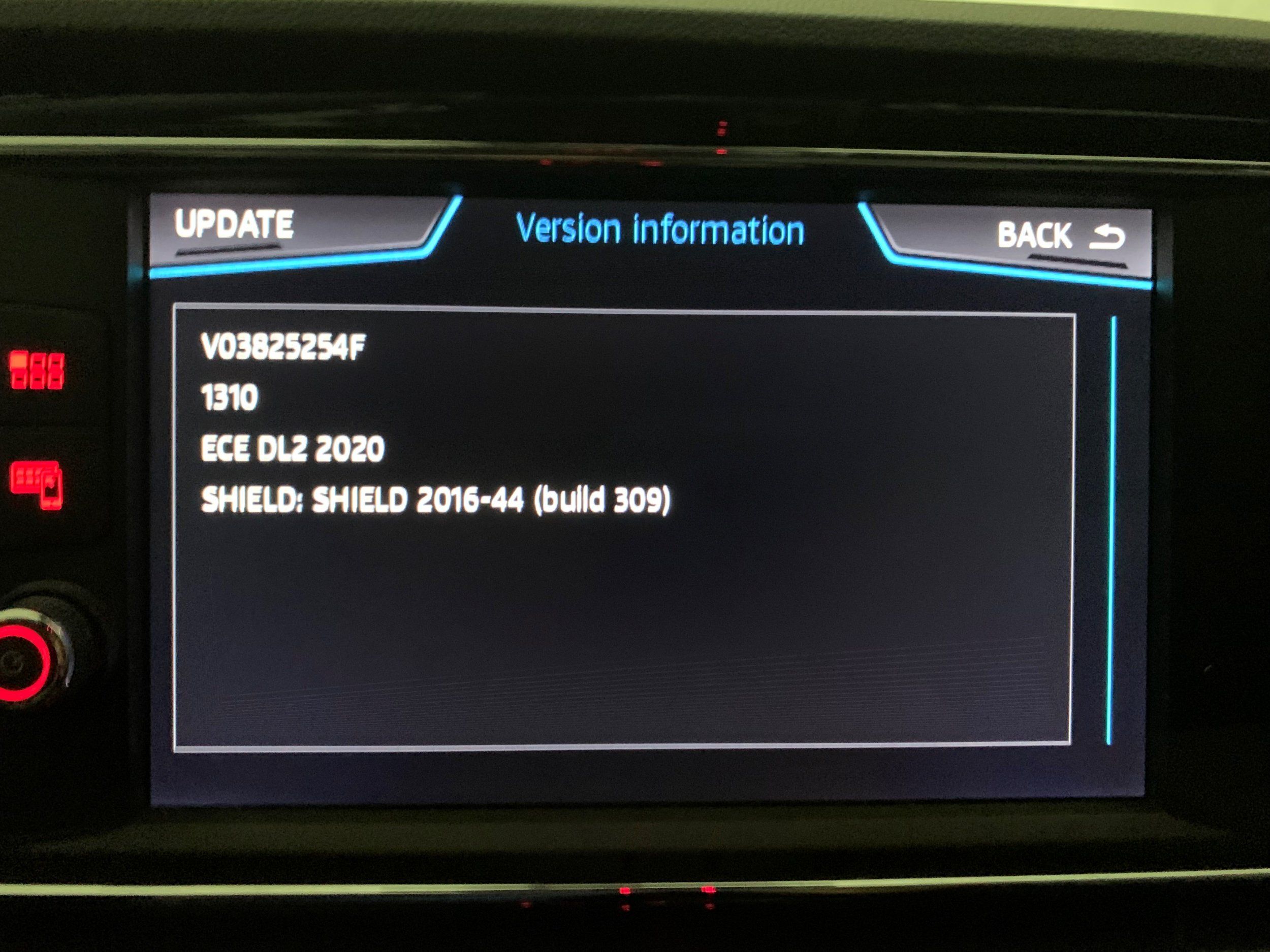

I've a seat leon 2018 FR 5F, navi 6P0, my navi database version as per the screenshot, then I've downloaded the recent maps updates from: https://www.seat.de/kontakt/downloads/map -updates /leon.html
I've followed the steps and updated the original SD Card and it works fine but unfortunately, now I don't see any thing in the Version Information page. any ideas?
Thanks!

Hi All
Thanks!
Two things. I'm wondering whether you have an older release. Seat and Skoda drag their feet and don't put up the most recent releases. In the know we take them off the servers direct not off the wrapped up web pages. 1910 with the year 2023 mentioned is the June 2022 release, released a month early for the mib2 standard. See here a few pages back on the link:
It's a common mistake using the brands own webpage which isn't up to date. The key really is the serial release which should be 1910.
On missing rows of the display these are populated from the files within the release. If when they are produce the files they miss off the title you won't see anything. That one has been reported in other releases in some of the zoned versions. This is just where QA has gone missing during production on the zoned maps. The real test is whether you are seeing the serial release in this case 1910 which is the summer release of these map files.
The titles are user editable in the release but don't bother. In the old days of the work around people would edit the release text to make it look like the old release that is just daft. Moving the overall.nds between your current release and the new one is the only thing that needs to be done (accepting one six month release talked about on the thread) the rest falls into place taking whatever the files are populated with but taken from the servers with the most up to date release. The servers / web pages / brand may not be aligned which is why we take them from the published in the know links. This period are the ones above.
All mib2 standard map release for the Vag brands are interchangeable so we use which ever is published first but direct from their servers not web page wrapped. Same holds true for mib2 high the Seat Plus but the workaround there is to get your FeCs changed.
yep Seat bless them are still posting up old map links use the ones I pointed too unless you like old maps:

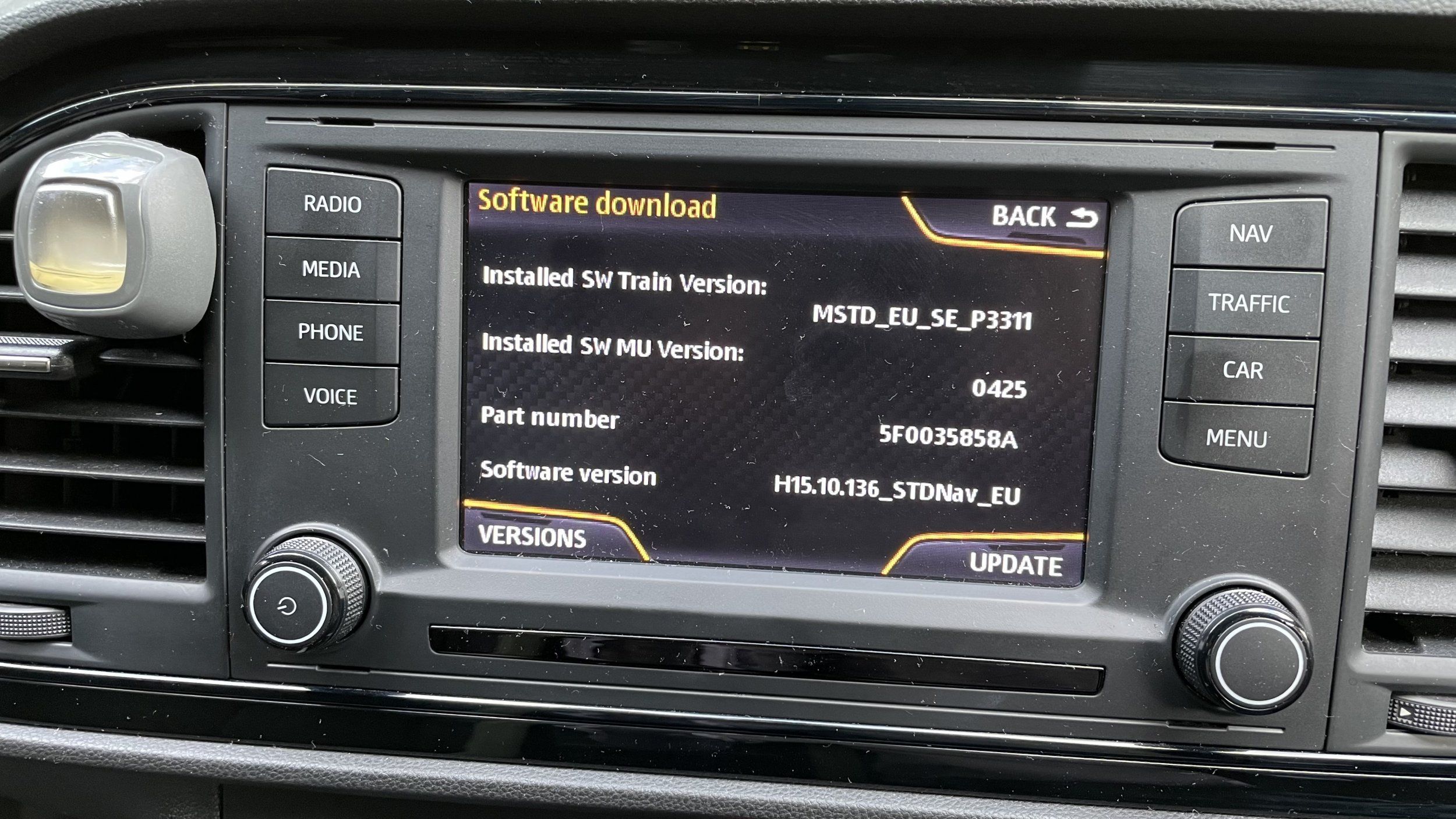

Yours is a mib1. The tell tail sign is the part number is 5F.... , 6P it's a mib2. Software version has STD in it which means it is a mib1 standard. It's a dealer task to update the maps on a mib1. The last updates by Vag were 2020 for mib1. Users never worked out a DIY task for them. When mib2 came out some people ripped out the mib1 and changed to mib2. Some stayed with standard mib2 others upgraded to mib2 high. Threads about on that. All things equal mib2 updates should go on to 2025 following the mib cycle of 5 year hardware refresh plus 5 years map updates.

Thanks 🙏🏼 I’ll ask the dealer for an update when it goes for a service in a month or so. I don’t think it’s worth the money upgrading this to MIB2 or later to be honest. It doesn’t have CarPlay, or USBs or aux under the heater controls. But it does have sat nav, Bluetooth, DAB and park pilot, so can’t complain. Six of one and half a dozen of the other 🤷🏻‍♂️
Probably a task they don't often get asked about. They would probably have to go back to Seat technical support to get the update pack / file / online procedure. VW and Skodas in the UK were sold with unlimited Mapcare which meant you could do it yourself, it was a free perk for those brands. It never got to Seat. DIY procedures were found for mib2 to update if you didn't have it so you could enjoy the same common map update feature. The community did sort out how to replace a lost mib1 card within release period but not how to update it to a different year. That's in the resource section. In the corner of the net somewhere you might find someone who has done it for mib1 and that would be around changing the firmware but inherent risks in that one, if there isn't a body of knowledge on that one.

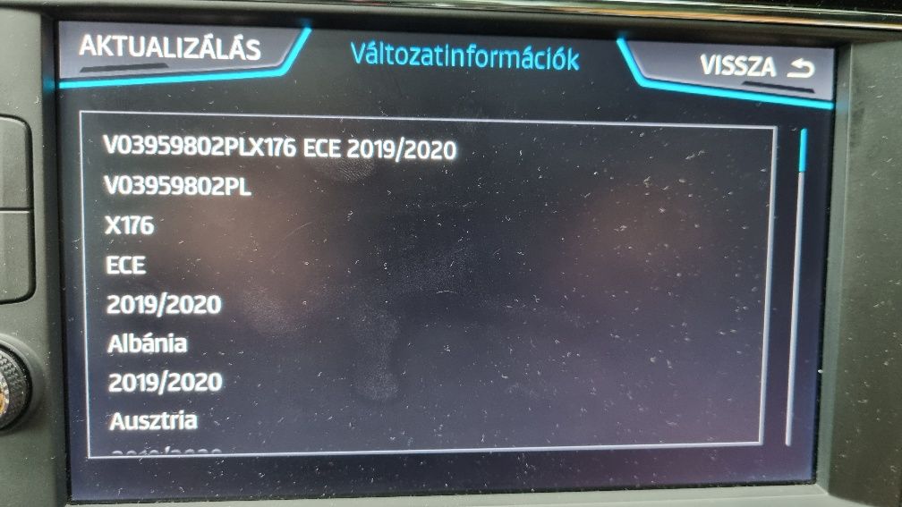

Hi All,
thanks to this forum and the detailed explanation I was able to find out what is the problem with my navi update, the installed FEC code is 07300026 (I bought my car with 3 years Mapce in 2017...), I have Mib2 High with built-in HDD.
Is there any possibility to perform the update without involving the Seat dealer? The local service sad that they can do that but the cost is cca. 200EUR each time when I'd like to update the map (in 2017 the Mapcare for 3 years was less then half price).
Thanks!

Hi All,
Thanks!
A group of hobbyists have generated two techniques for the mib2 high. Either work. One is to update the firmware to the final release with the code 1447 AIO. The AIO means all in one, gives the mapcare FeC boost you need to life time FeCs. The software is resilient so can be used on older Mib2 highs, doesn't seem to be depended on which "train" you were on so some very early mib2 highs have been done this way as well as the latest. The other method uses the mib2 high toolkit, that one can be used with specific mib2 firmware releases. It replaces a piece of code with another piece of code which allows the FeCs to be updated from within the green menu. The toolkit resides in the green menu. It gives retrofitter techniques in the car rather than on a work bench with a laptop and the usb / ethernet dongle. The original method. That one (Toolkit) I used when Seat for one release only of the maps decided not to release them for Seat. Retrofitters and hobbyists knew that they could use Skoda or VW FeCs on these units. The toolkit recognises which firmware you are on and offers up the appropriate module or if it doesnt have one you are invited to send you back up for the group to write the module, that's what I did since 1338 was not supported then. Use a text editor to add the FeC code.
The choice of which to use is up to you. The 1447 AIO method wasn't out when I did mine. 1447 was cumbersome then since some files had been left out so you had to top up with the previous release using the mib2 backend menu. Also you got a black screen and had to change the skin prior to starting and also had to use Mib Tool in anycase for the FeC work. So I stayed put on my firmware release. All of these issues were sorted out in 1447 AIO where they added in the missing files, sorted the screen issue out and built the FeC edit into it. You just sit back and let it run. With the car engine on, suppose to be on battery charger. Main thing is you can't interrupt firmware updates. Reboots several times and job should be done.
The links are on the firmware thread:
How it was before 1447 AIO with just the two options 1447 / Mib Tool:
Link to 1447 AIO:
All of the discussion is on the firmware thread on this. Certainly 1447 AIO has had a lot of reported success from the spring this year. You do need to let it run to the end. One poster answered the question wrong about do you want to use the toolkit. Popped the question up as it progressed. You reply yes and the FeCs get updated. Incorrect answer you get the firmware update but the FeC work isn't done with the updates.
@mykro got it working on a very early mib2 high in early spring followed by success with a number of other people:
The only stumbling block seems to be where people have fiddled with the screen palette colours then have to fiddle again to get it how they want it. Never fiddled with mine and I've got the ambient lights on my car (happy with circa 16 hues). That's covered on the firmware thread tinkering with the display after using 1447 AIO. Might need it on very old mib2 highs without ambient lighting where 1447 assumes ambient lighting or where you have changed the display colour pallete using Obdeleven / VCDS.
Mib Wiki is the self appointed administrator to the mib international hobbyist group... other members of the "collective" as I call them post on the mib2 firmware thread.
