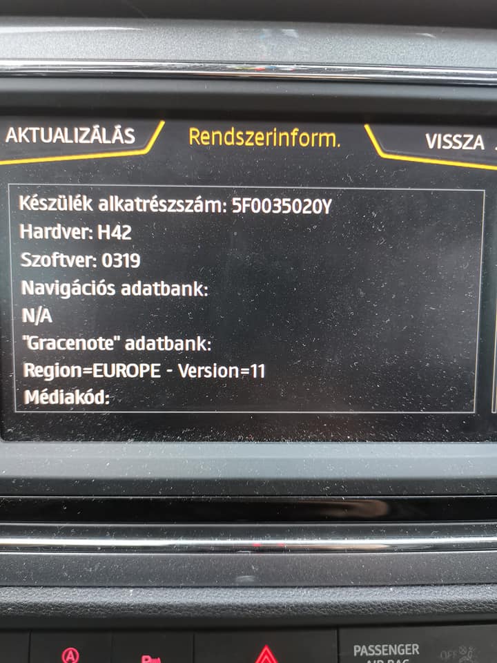

Hi All! A friend of me have a strange problem. He has H42 SW0319, and the service had something set on the head unit, and now he has no bluetooth, no USB, and the Mode button not goes... He went back, but the service can do nothing... Do you have any idea? As i know, for this HW there are some newer SW, example: 674, 818... etc. but i have SWs only for the H24 unit... Could someone help me? Thanks a lot!
Are you saying that a Seat service depot/centre did an update on the head unit, if they did then they are liable unless the unit had been modified previously.
When I had a service recently the dealer was going to do an update on my unit, think it was called 91U4, but I refused to have it done as my unit had been modified.
Sometimes when firmware updates are done certain features get disabled and they have to be 'switched' back on with tools such as VCDS,
I had to enable Android auto / Mirrorlink and TMC after some updates.

As my friend says, they made a factory reset or something like that... (he didn't see) and after than, the Mode button not goes, the BT, and the USB... Thank you for your answer! I have VCDS, maybe i look a save from a simillar car, and try to re-enable the things...
It's in 5F Adaptations I think, do an ADmap first.
