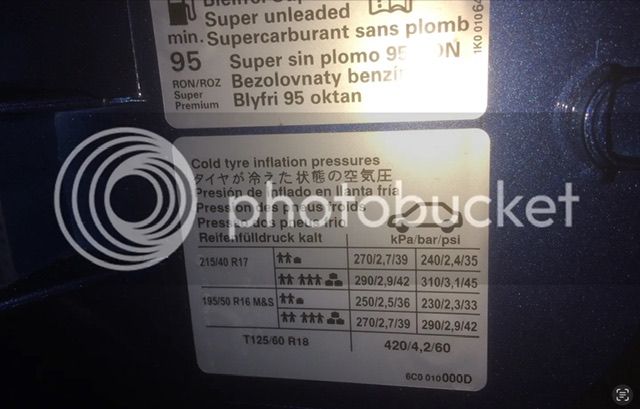

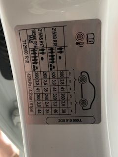

Interestingly, VW don’t have a comfort tyre pressure setting for all wheel / tyre size permutations. I seem to vaguely remember it might be non-performance models do have a comfort setting whereas performance models don’t; maybe Seat and Cupra are the same?
My last VW - a 2016 previous generation Polo GTI - had 7J x 17” alloys and 215/40 R17 tyres and that didn’t have a set of comfort tyre pressures - photo of tyre pressure sticker below;
Here‘s the tyre pressure sticker on my current car (2020 Polo GTI+ with 7.5J x 18” alloys and 215/40 R18 tyres) - no comfort setting. VW’s recommended pressures with up to two occupants + luggage in the car is 41psi front and 38psi rear. For a fully laden car (my car’s rarely, if ever, fully laden), the recommended tyre pressures are 44psi front and 46psi rear! 😮.
