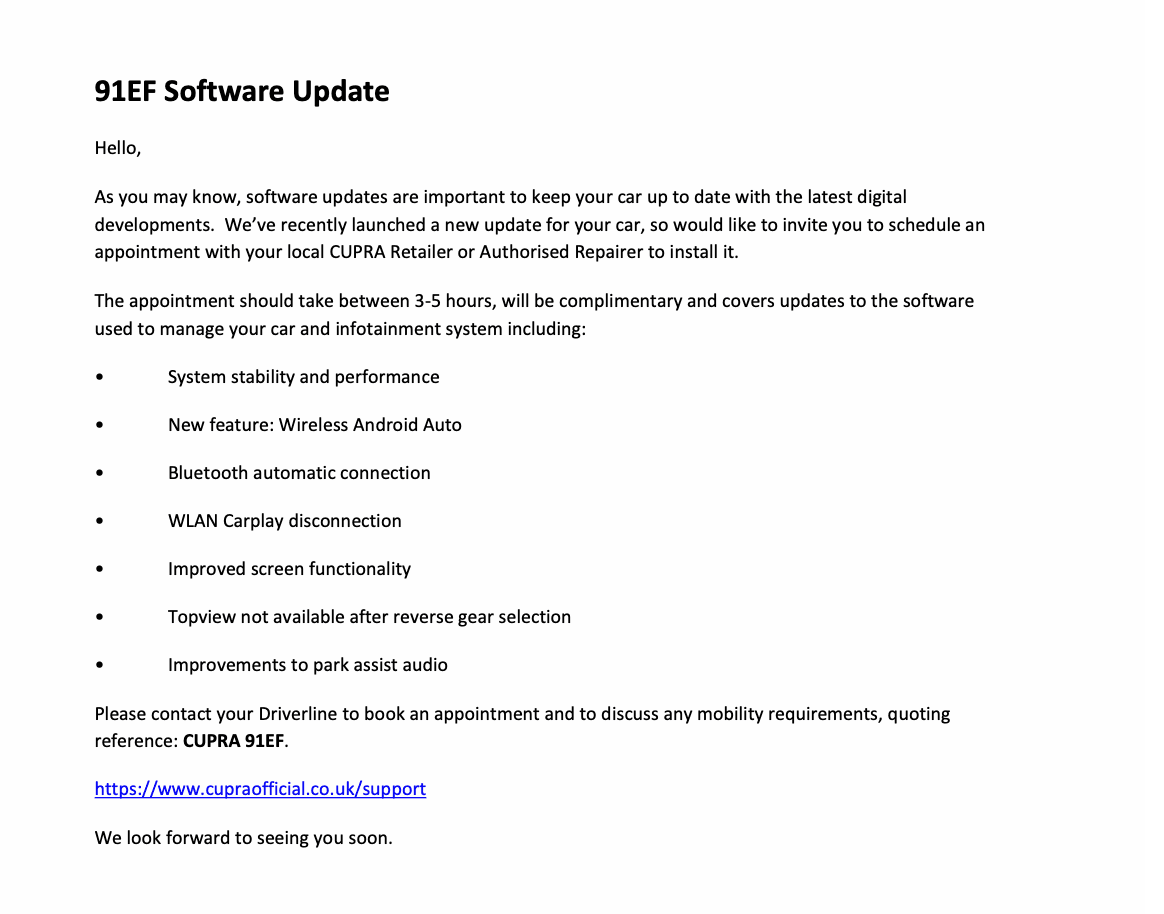

Received this from Cupra, has anyone done it?

Process No. : 2068196/1
Reprogramming MIB3 OI Cupra Leon/Formentor VRD-VRE
Affected vehicles:
VSS___KL_MR002675-102593
VSS___KL_NR000077 - 038734
VSS___KM_MR005886 - 038803
VSS___KM_NR000093 - 031919
Release date : 27.10.2022
Affected steering wheel : MIB
For certain vehicles Leon and Formentor, within the mentioned vehicle number range, the MIB must be reprogrammed to improve functions.
Help
The MIB control device needs to be reprogrammed on the affected vehicles.
Not all vehicles are affected by this service measure.
All affected vehicles must be repaired within a workshop visit.
Ensure that all vehicles affected are inspected and serviced as part of the workshop visit.
If this measure was not carried out during a workshop visit, inform the customer immediately.
Reprogram the affected control device in the affected vehicles.
The field action is valid until 31.12.2027 and will be closed on the specified date.
I had the same texted link from CUPRAUK and had the update done just this Monday. I have a Formenter PHEV and I'm now on version 1899. Here's the link to my post:
Had my software updated last week and I’m 99% confident it’s fixed. No more pops from the stereo and no more SOS errors. Wasn’t done as part of this bulletin but the newest updates for infotainment and telematics module seem solid (other than the random reboot issue on startup but that’s rare). The wife’s phone connects up over wireless AA now as well.
