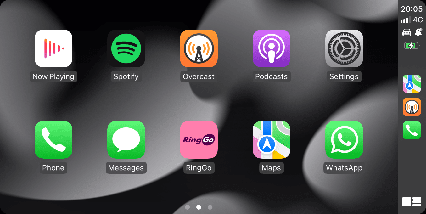

Had my car updated today. Too early to know how stable it is. But they put it on a newer version than I’ve others post on here V1940.
Oddly, the main difference is in CarPlay. The UI scaling has changed. Items are all far smaller. It’s necessarily bad. More information viewable at once. But an odd change none the less.

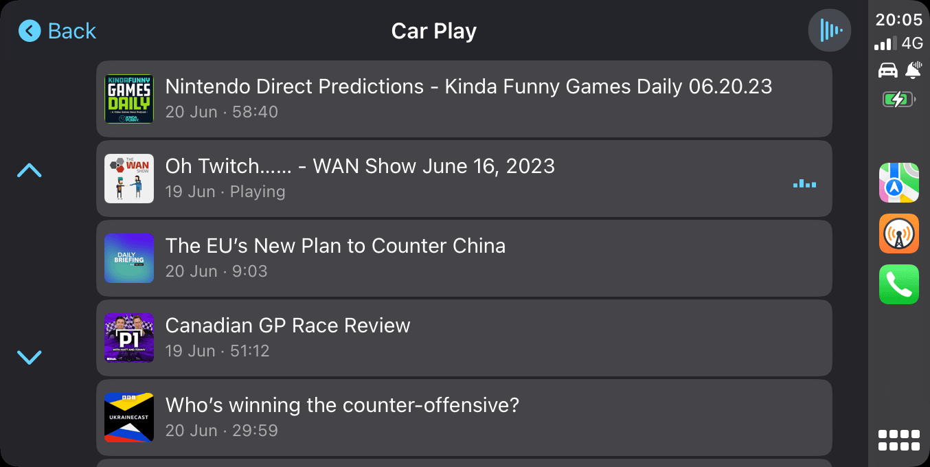

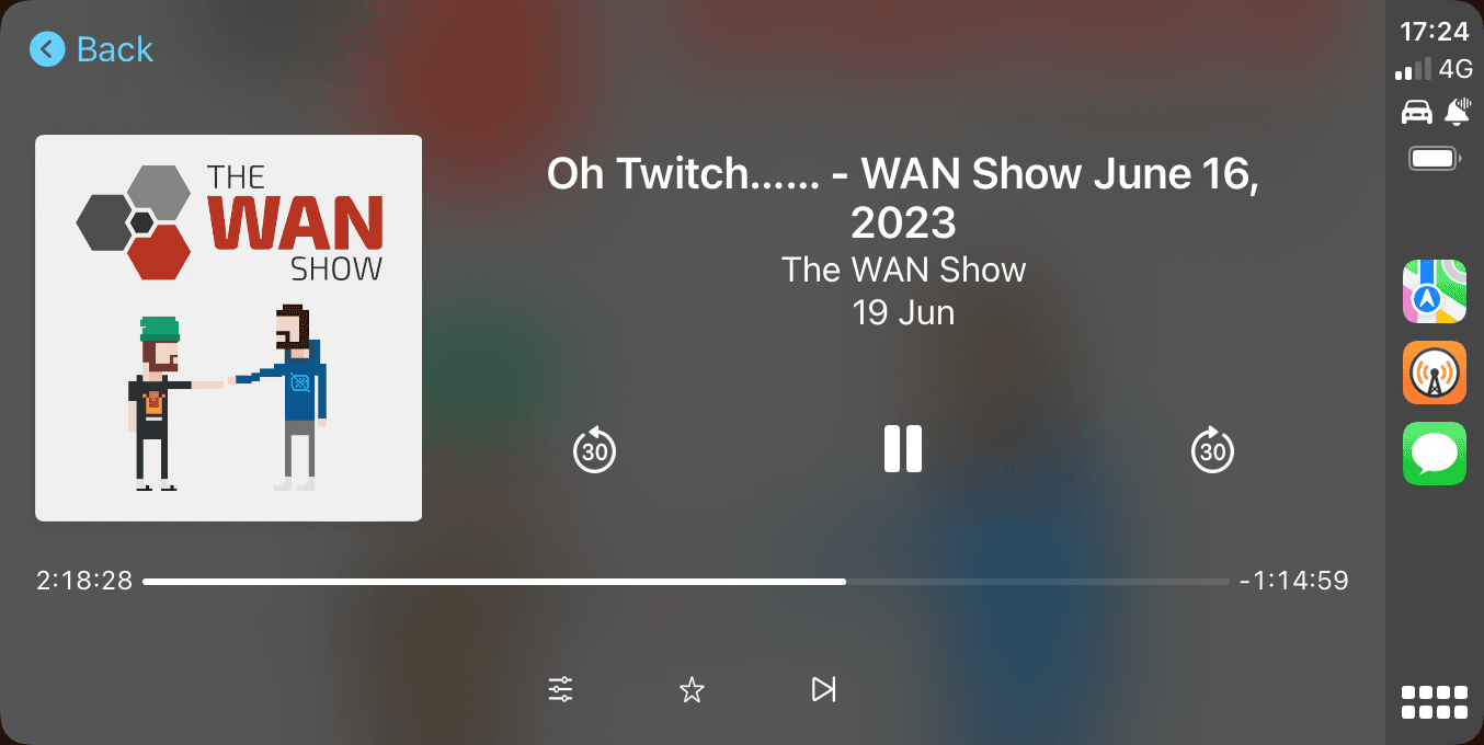

I was also pleasantly surprised by this. It’s made situational awareness a lot better when using google maps.
Nice to see I’m not the only one catching WAN show on the move!
yeah I can see maps being a lot better. & the Split View on the main screen is far more useable.
watched the WAN show for years. But with it now reaching 3+ hours an episode, I don’t get time to watch it live or on YouTube. 3x speed on Overcast is the only way. Lol
