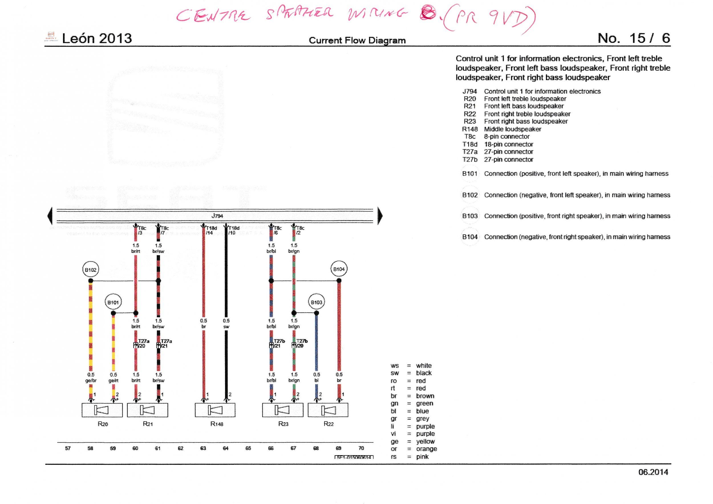

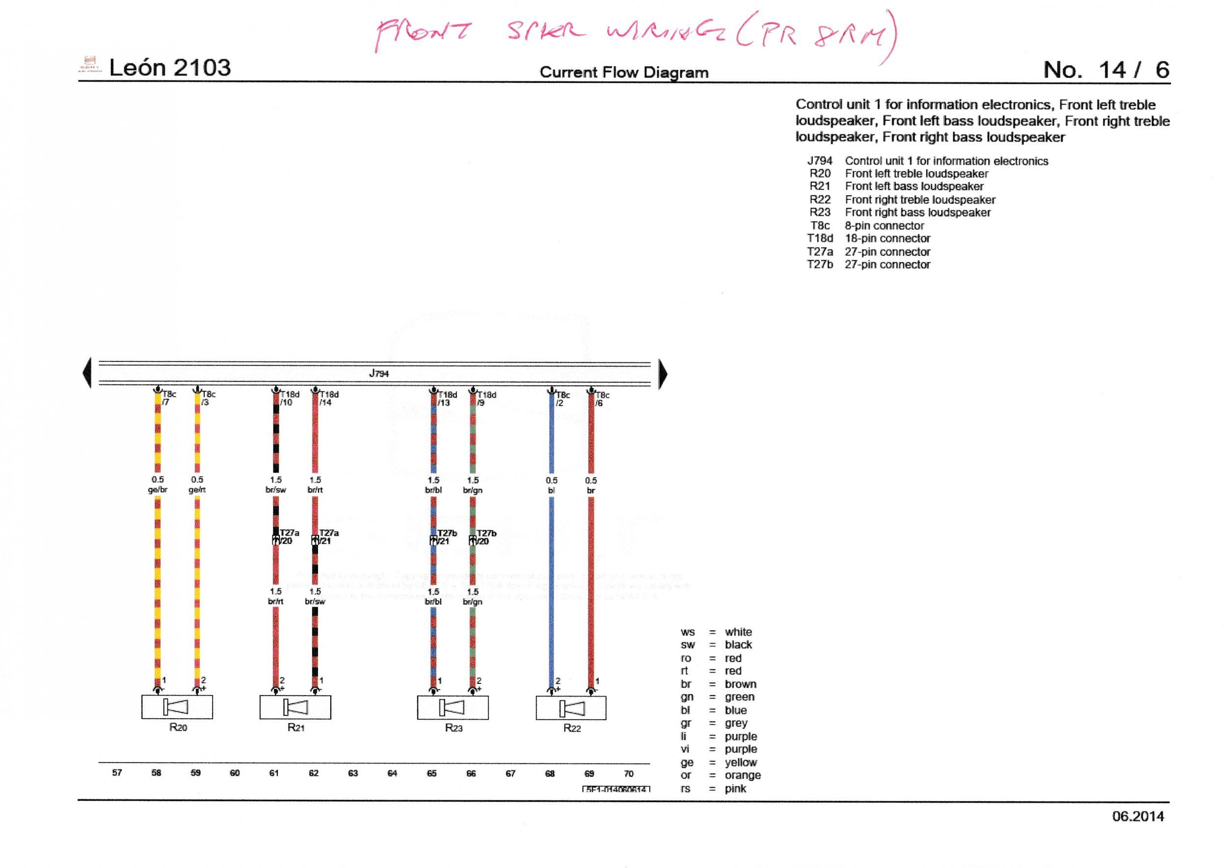

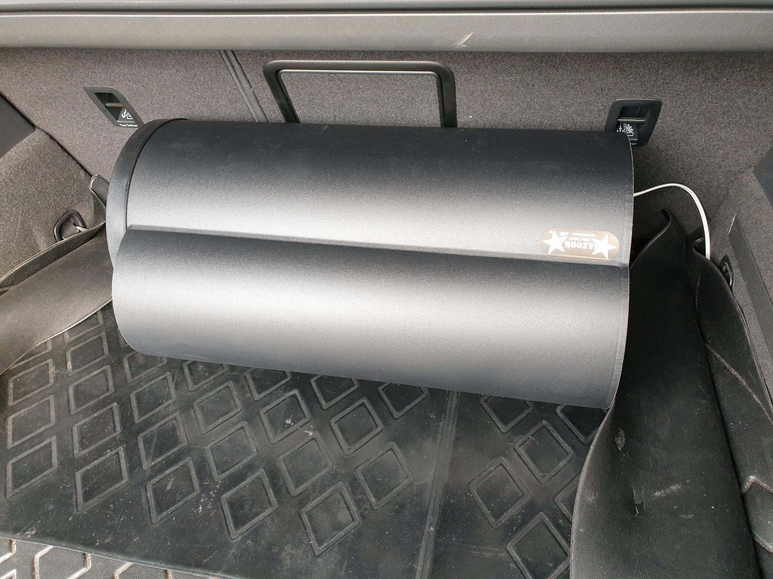

I finally got round to retrofitting Seat Sound to my car, I have MIB2 High unit which had the PR-9VD option added about a year ago!
I followed the guide from the Spanish forum but I'm sure I found a few errors in the wiring instructions, I have amended the PDF text in Red where I think it is wrong, I also attach the Seat diagrams for the front speaker wiring with the standard PR-8RM system (8 speakers) and the diagram for the centre speaker wiring for Seat Sound PR-9VD, if you look carefully at the PR-8RM diagram you will see that the colours of the wires from the front left Bass (door) speaker change on route to the quadlock pins, which IMO is mad! I checked to make sure that this is correct on the car and it was. I also as a temporary try-out fitted an unused Bass tube that I've had for many years. Front speaker wiring (PR-8RM).jpg Centre speaker wiring (PR-9VD).jpg 20200716_164825.jpg

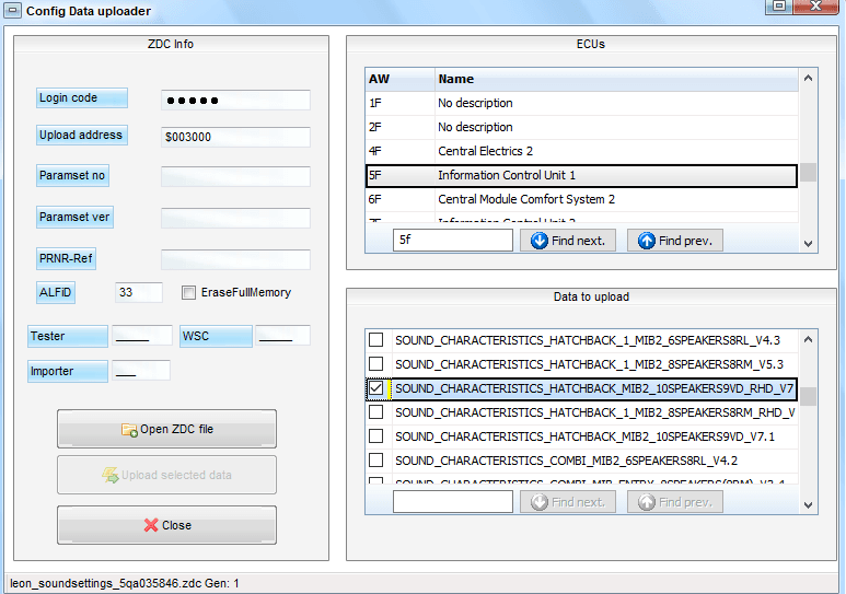

Figured I would share my experience of re-enabling SEAT Sound after upgrading from MIB1 to MIB2 which broke the subwoofer and front door speakers
Unit wasn't coded correctly for SEAT Sound, so this thread lead me to VCP and zdc files
Decided to splash out on a genuine VCP cable to make sure I didn't break anything further and also to get the zdc files
Following the coding instructions in this post did not work for me, kept getting out of range errors when trying to write the zdc file.
Part number of my MIB2 unit is 5QA035858
The ZDC file used was leon_soundsettings_5qa035846.zdc
I WILL NOT PROVIDE THIS FILE - VCP is an expensive and powerful tool, buy the legit software yourself or pay a professional with it for their time and expertise
I then uploaded the dataset - SOUND_CHARACTERISTICS_HATCHBACK_MIB2_10SPEAKERS9VD_RHD_V7.1
Restarted MMI and SEAT Sound is now working, subwoofer option is available under Media Settings > Sound and the subwoofer and front door speakers are working again
