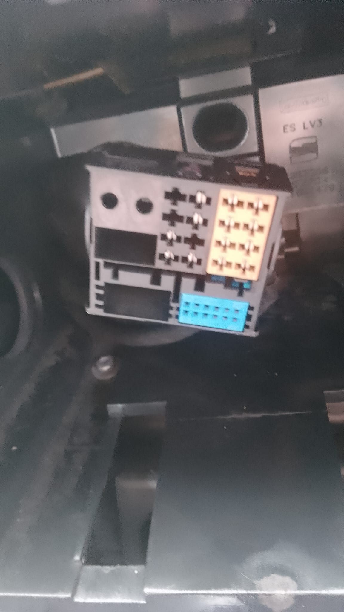

Has anyone had success (or failure) fitting a 2 din HU to a mk2 Leon. Looking at the quad block on the power side it SHOULD be simple enough :oops:I've never had any problems before in two Renaults, a Ford & a Citroen.
The first problem I encountered was when I removed the OEM CD player. I decided to try the head unit I had in my previous car. It didn't work. Needs a custom wiring loom I thought. Reconnected the OEM unit. It had stopped working now.
Got my multimeter out. I had power coming to both CAN+ & CAN-. Can't remember if I got anything on the two + pins at the bottom of the block.
Tested all fuses and they were fine. Tried another HU I have but it wasn't working.
Can't imagine that all three have gone faulty all of a sudden. I'm no electronics engineer . But as there's power to the quadblock. I can't think of what the problem could be. And I don't want to have to buy another HU if I can help it.
