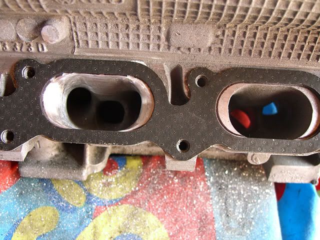

Looking good, you doing supertech springs and retainers too? Headwork looks good, can really see why you would get gains there, How do you know how much to take off it? You going to do rods while you have the head off?
RobDon
Pro Detailer
I'm fitting Supertech inconel exhaust valves, that's it, to eliminate the weak 2-piece OE valves.
All I'm doing is shaping and smoothing the inlet ports in so the air flows smoothly in from the SEM manifold without having to use the big transition spacer plate. Exhaust ports will be smoothed and polished, not enlarging them as this will only cause lag, inlets left slightly rough but not polished, to promote atomisation.
Yes I am doing rods, IE rods and OE rod bearings on order.
I have decided to do new piston rings too as the bores look like they need a bit of a hone. I have found a UK supplier of the FlexHone tool so have ordered one.

Danny - yes dremel bits such as carbide burr, carbon steel brush, abrasive wheels and polishing wheels etc., I'm using the flexi attachment too as it's alot smaller so can get into the ports easier.
I'm almost finished cleaning out all the ports and smoothing them, waiting on a new carbide bit to finish the inlet ports, lots of shiny metal!

Rob how did you know where the coolant gallerlies were?
Are you just going on that a large port head is just a small port but bored out theory?
