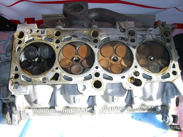

I am going to post all updates on my rebuild here from now on. Long story short - burning oil, fouled plugs, valve stem oil seals shot (still made 317bhp though!) - head off, IE rods ordered, working on the head just now.
Success - my home-made valve tool worked perfectly and I removed all the inlet valves no problem this morning. If anyone wants to borrow it once I'm done with it just let me know. :D
Full set of inlet and exhaust valves:
http://i312.photobucket.com/albums/ll330/SonicBlueLeon/hd10.jpg
Empty cylinder head:
http://i312.photobucket.com/albums/ll330/SonicBlueLeon/hd11.jpg
I started to clean up the head and get rid of all the carbon/coke build up:
http://i312.photobucket.com/albums/ll330/SonicBlueLeon/hd12.jpg
I found a machining company locally who will skim the head for £30 + VAT so I think I'll get this done once I'm finished cleaning up and porting the head.
