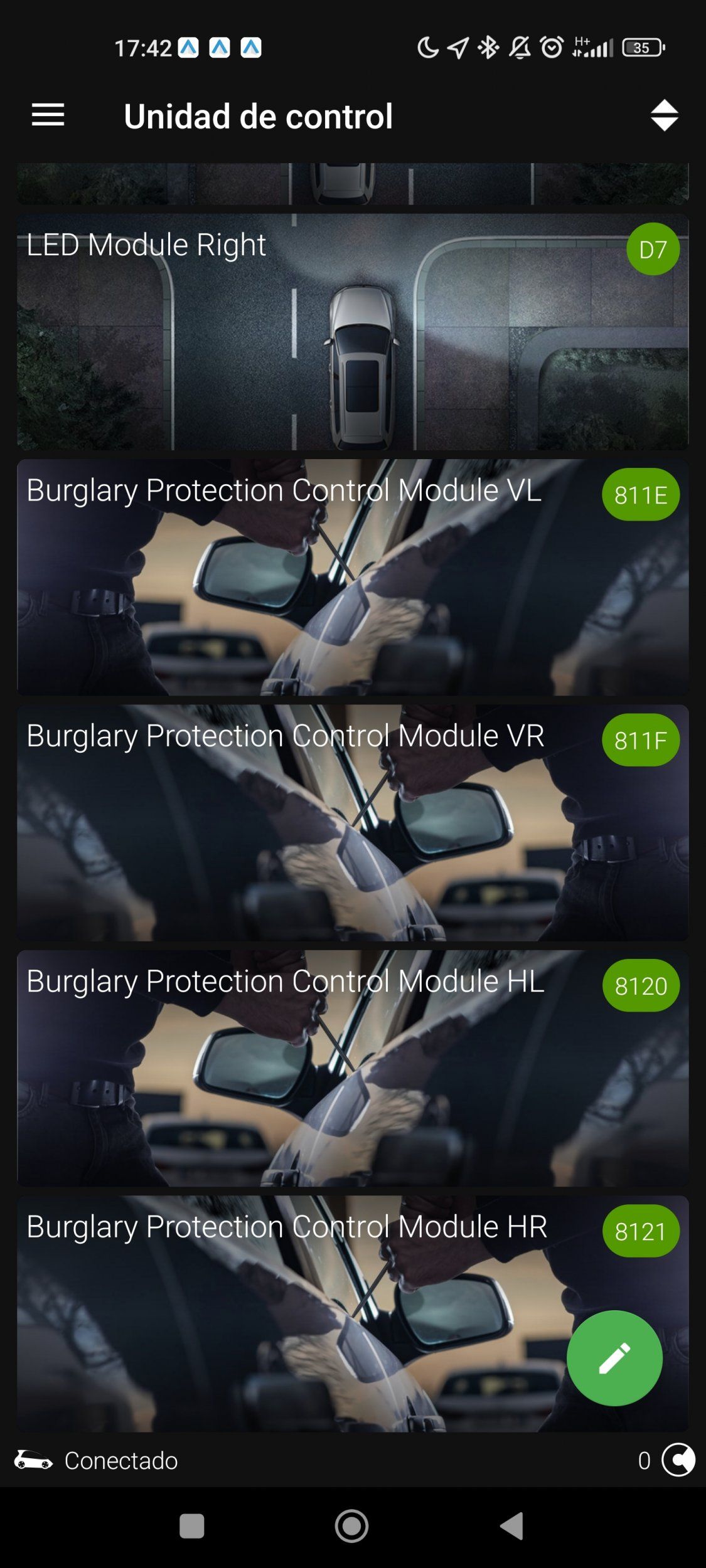

I just got my obdeleven yesterday and when I connected it I saw I have the modules in the photo. I ordered my car without alarm so does this mean the hardware is there but the alarm function is not activated?
No, if you go into them, you'll see that the pre-requirements are that you have an alarm.
