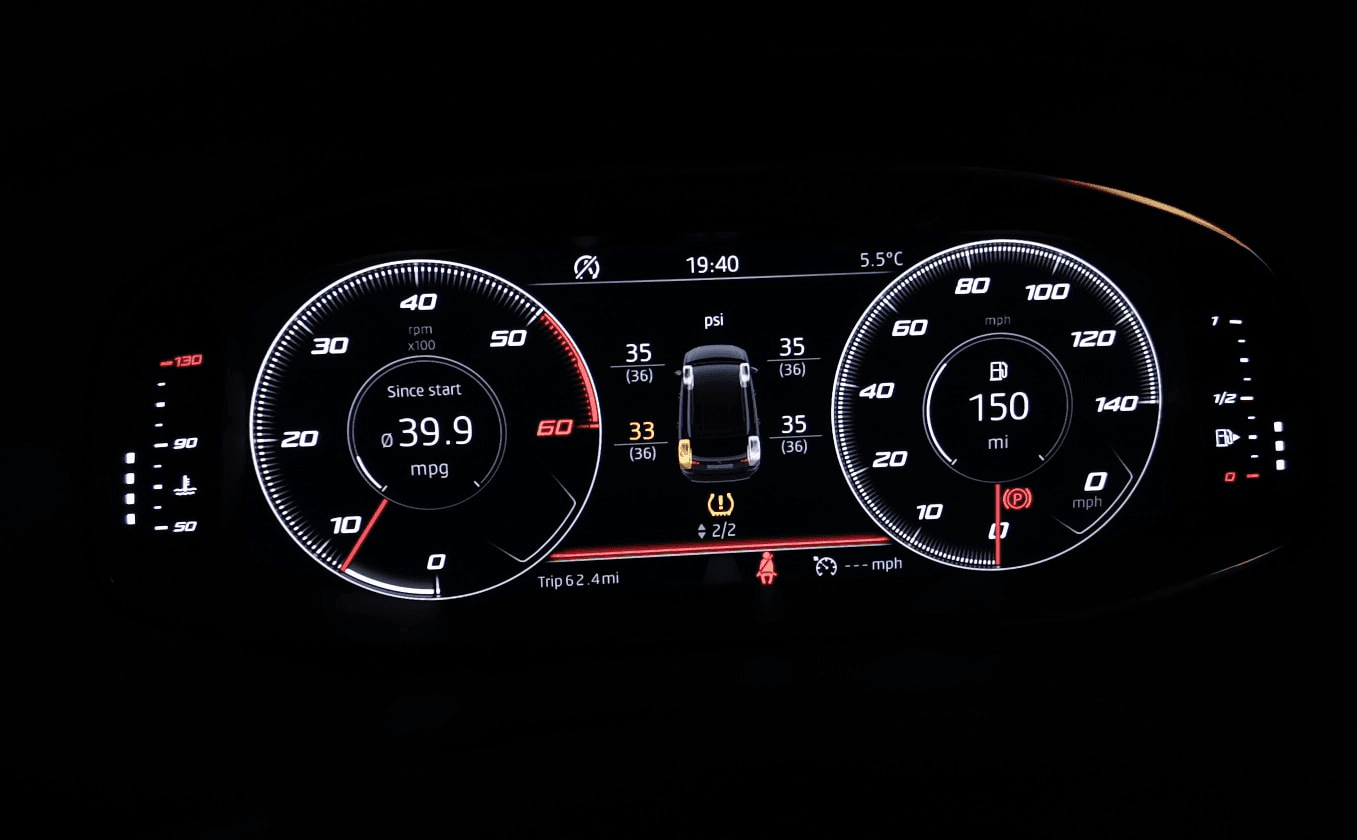

Sorry guys, don't think I have been clear on this. I know it has the TPMS as standard, I meant being able to see individual tyre pressures for each wheel. Such as the this screenshot...

That requires active TPMS sensors in the tires. The system used in the Leon just use the ABS system (I think) to monitor the difference between tires.
If you install active sensors in the valves, I think you can code it, but I'm not sure it's worth it.
FalconTech
Jun 8, 2021
84
29
Yes, Leon use ABS to determine pressure lost.
Sensor in valves isn’t enough, signal receiver is needed.

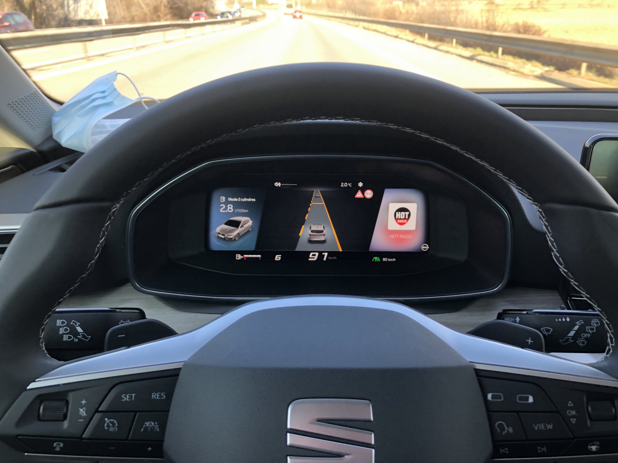

Did you have ACC before you got the new steering wheel?
I had the drive assist pack L with ACC, so yes :)
from other forums, it appears people with the drive pack M also got it to work but without 360° awareness as they didnt have full radar coverage of the vehicle. The travel assist view couldnt show vehicle coming from the back.

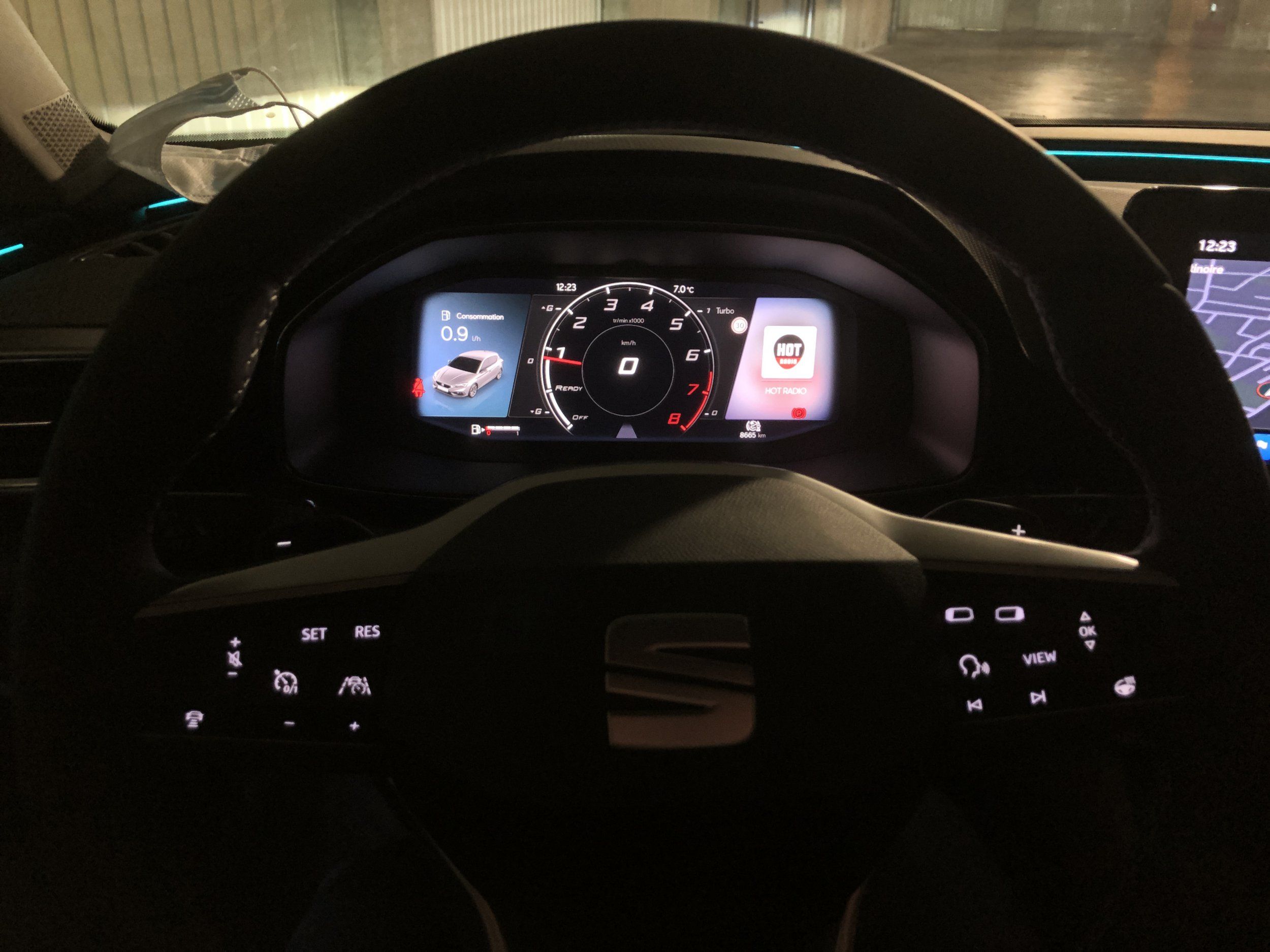

Hi, for the roof that closes when it rains I can't help you by not having it, while for the rest you ask you have to follow these codes:
- Select Control Unit 17
- Select Vehicle variant - this is mandatory otherwise the subsequent encodings will not work
- Set to Derivative 6 (For Sporturer)
- Set to Derivative 4 (For Hachback)
- Select Adaptation
- Select Configuration of displayable contents
- Select Engine power
- Set to Active
- Select Engine torque
- Set to Active
- Select G-meter
- Set to Active
Do you know what the original derivative is for an FR Sport? I’ve changed to cupra view but need to change back
Hi, just keep the vehicle in sight on the virtual cockpit and start from 1 and you will see the car change in front of your eyes in real time.
Hi,
I have Leon MK4 KL - 1.5 eTSI FR with (technology and FR plus pack) also including "automatic 360 ° parking + cruise control + lane assist + wrap light". Am i need any additional hardware to enable ACC and blind spot information? Do you have any idea?

Not possible because off missing hardware
hi, thank you for information. so what about TSR (traffic sign recognition), do i still need hardware?
i found this post, and said the system uses image recognition from the high definition camera which is part of lane assist.
