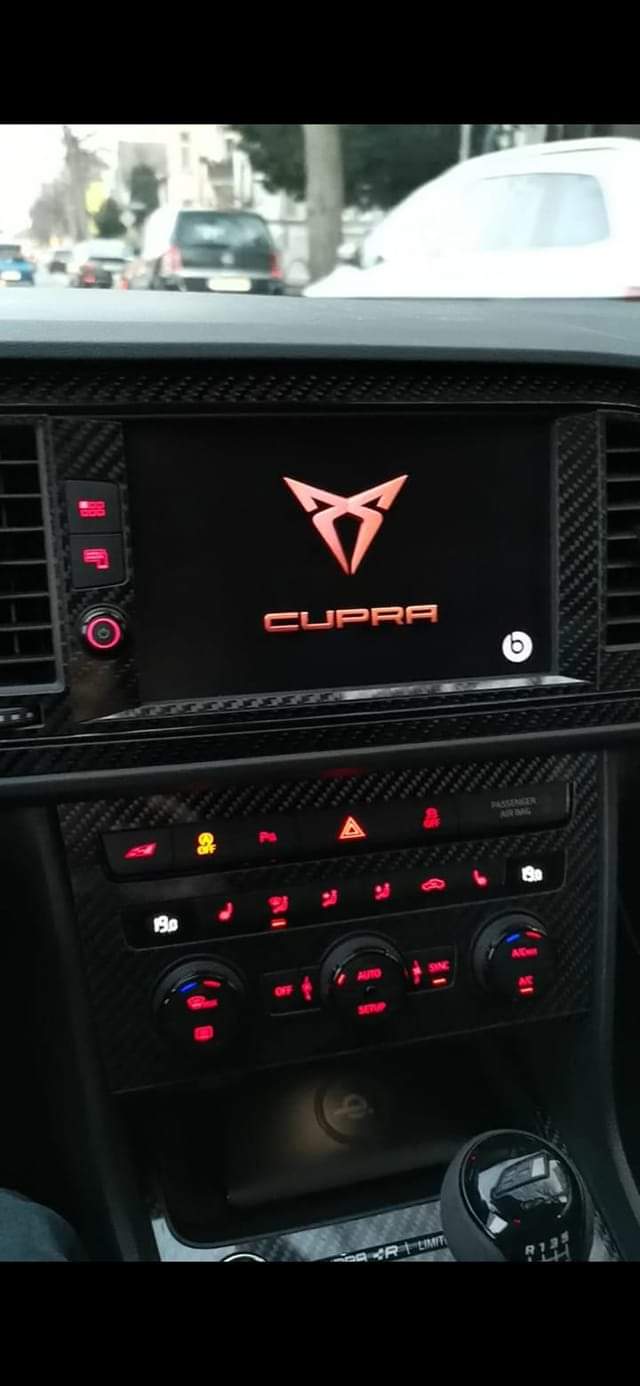

Mine is a BW45 290. Seems a bit of inconsistency with the software being put on them on the production lines.Are those Cupra start screens on 290s or 300 STs?
I have a week 46 Copra 300 ST and it doesn't have that. It has a silver SEAT logo with (I think) a Cupra flag.
Must be something they did when updating the non High Navs. Poor form Seat.No thank god!
Hmmmm wonder if this is something I could pay someone to do. I’d happily pay £10 to get my own custom loading screenI seem to recall this is the sort of stuff you could do using VCP https://vcpsystem.com/ but may be wrong.
It'll cost him £10 - seeing as he's happy to payGet @paddy6789 to put his OBD11 On it and see if there are any options.

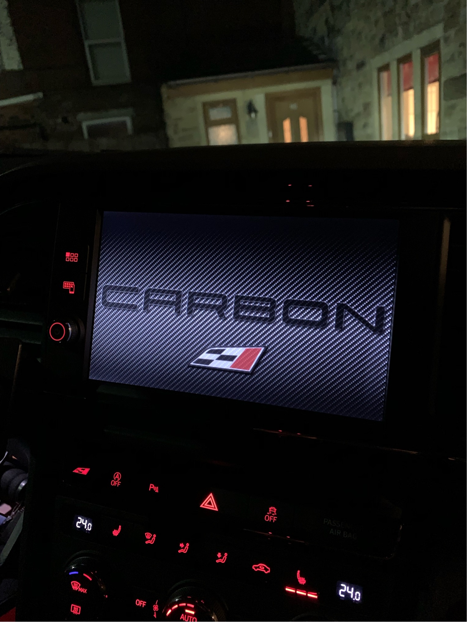

Here is the old coding might be worth a look to see what options you have in your new setup.
Change logo radio (FR, Cupra, Ecomotive)
With this mod, you can change the initial logo.
1 - Module 5F - Information Electronics 1. Code (20103)
2 - Adaptation
3 - Byte 18 Screenings
Value in 0 - Seat Normal
Value in 1 - Seat FR
Value in 2 - Seat Cupra
Value in 3 - Seat Ecomotive
Value in 5 - Seat Xperience
Value in 6 - Seat FR Line
Read more: http://forum.obdeleven.com/thread/764/coding-adaptations#ixzz5cgmxDy1A

I have tried that with my carista, and can change the screen, but the copper Cupra is not in there.. it obviously wasnt uploaded..You can changed the start screen on the older cars with VCDS / OBD11 Is that not possible with the newer cars.
On the Carista, there are those options, but the '2 - Cupra' is the old Cupra flag and the word SeatGet @paddy6789 to put his OBD11 On it and see if there are any options.
