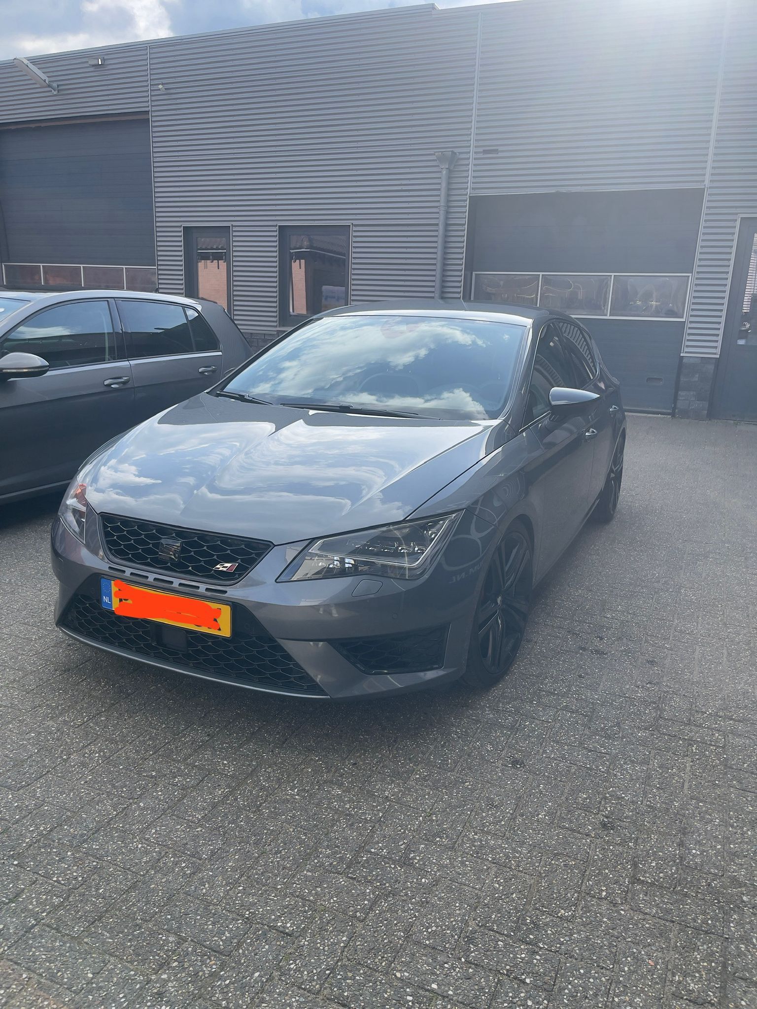

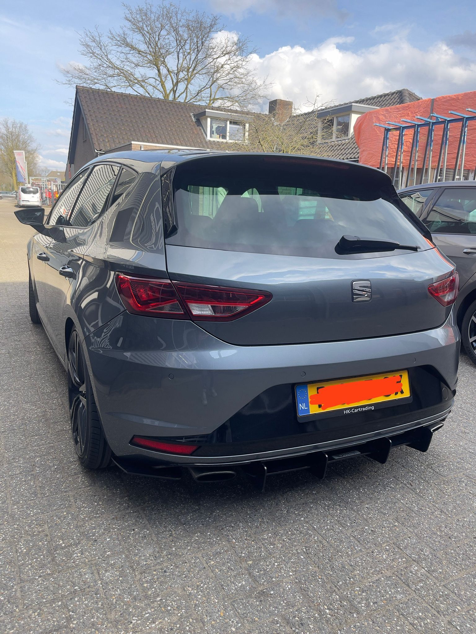

Hello,
My name is Joao and I'm from the Netherlands. I recently bought a Seat Leon Cupra 280.
Future mods:
  • Double Exhaust Tips (carbon)
  • Front Lip (tbd which one)
  • 8inch navigation radio with carplay
  • Carbon + Alcantara steering wheel
  • Carbon knob (DSG)
  • Cupra badges in the trunk
  • Spacers in wheels (something small to fit the bodywork)
  • Stage 3 ECU repro
  • Dark tinted windows (in the back)
  • More to come...
If something have some suggestions, please let me know! (y)
