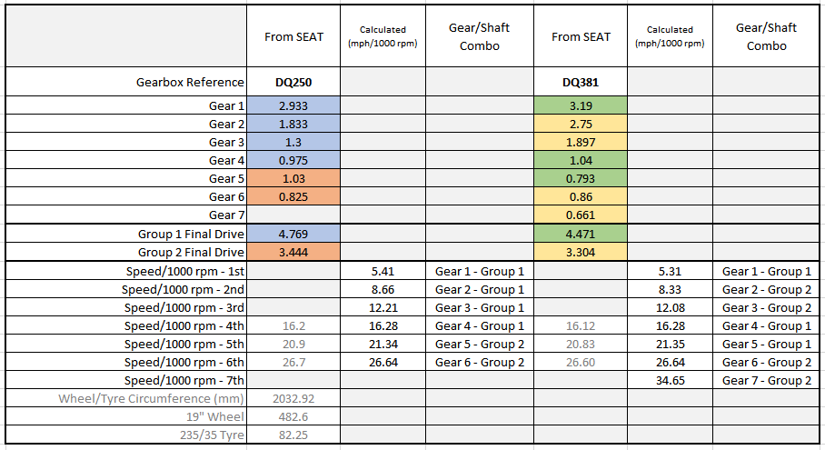

As I was bored earlier (and using information in the link from Matt_taylor) I did some research into the gearboxes and how it might affect performance. On balance I don't think it will at all, the 7th gear is an overdrive based on my data.
I have made quite a few assumptions (based on which gear uses which shaft in the gearbox) but it kind of checks out (roughly).

I was just expecting it to provide lower revs on the Mway and slightly better MPG.
Are the clutch plates any bigger/stronger can it hold more torque than the 6spd version?
