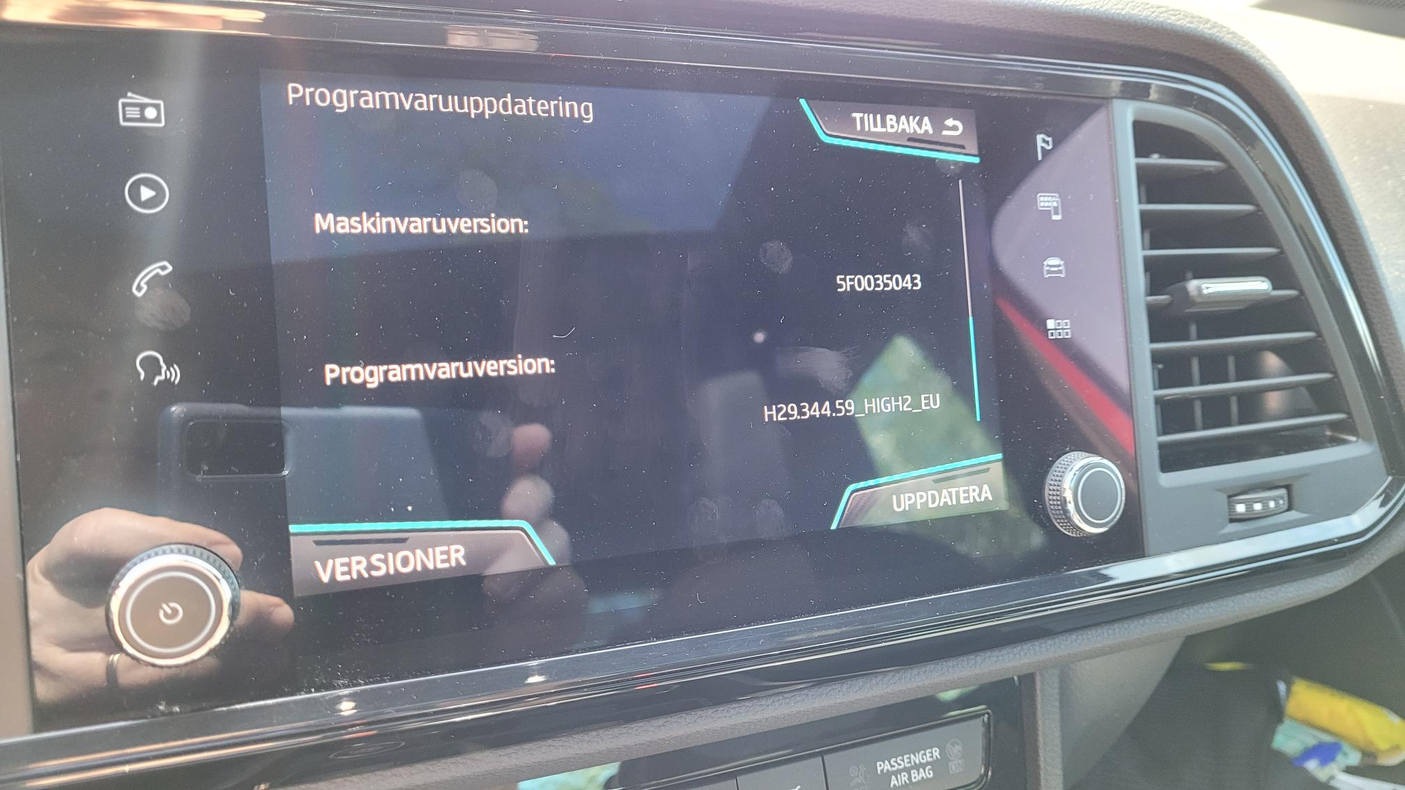

HI !
Is this usable for such a unit?
BR Tommy
Tell
That's a mib2 high. It depends whether your navigation FeC allows it or whether it needs upgrading. Late mib2 highs came with the life time FeC, circa 2019. You can do a check in the section "Mib2 High / Seat Plus Map Update"
The table shows you what it's dated to by reading off the FeC. Failing that you find a retrofitter that can update the navigation FeC or use the Mib2 high toolbox:

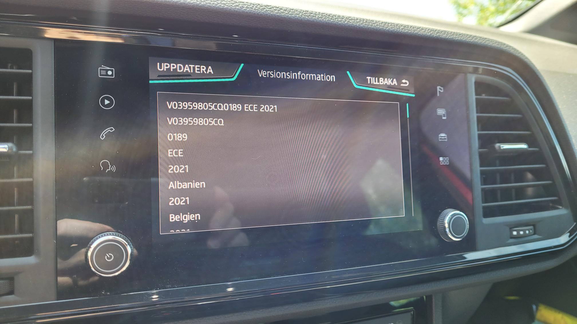

HI! Thanks for a fast reply, it is VERY appreciated.
I can see I have the code below. So that should be a so called lifetime access according to your information. Then it should only be a matter of finding the correct file to downlod. I hope it's correctly understood?
Secondly - I'm very impressed of the level of knowledge here.....;), wauv! 👍
BR Tommy
073000EEDB_EU_MIB2_HIGH_SEAT_Lifetime_Mapcare

HI @Tell ! Off course it worked - slow download, fast unpacking with 7-zip and into the car for installation. I must admit - no spectacular procedures done before, just started the vehicle, inserted the SD card and went into navigation, setting and "version information", tapping update - and after 6-8 seconds the miracle happened :) . Thanks for your help!
