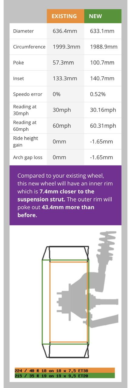

Youve not said what your existing wheel / tyre set up is. Assuming your existing set up is 7.5J x 18 ET38 on 225/40 R18 tyres, the difference between old and new (using the calculator on www.will they fit.com) will be as per the summary below.

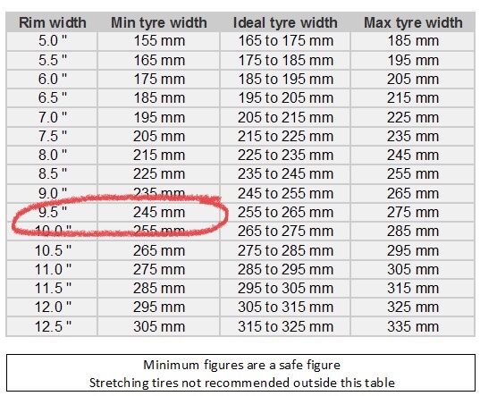

I think you may well have issues with the face of the wheels extending out beyond the wheel arches; that would be illegal in the UK. Also, with ‘skinny’ 215 width tyres on a 9.5J wheel, those tyres will be stretched quite a lot. The minimum safe width of tyre recommended by many tyre organisations is 245 on a 9.5J wheel.

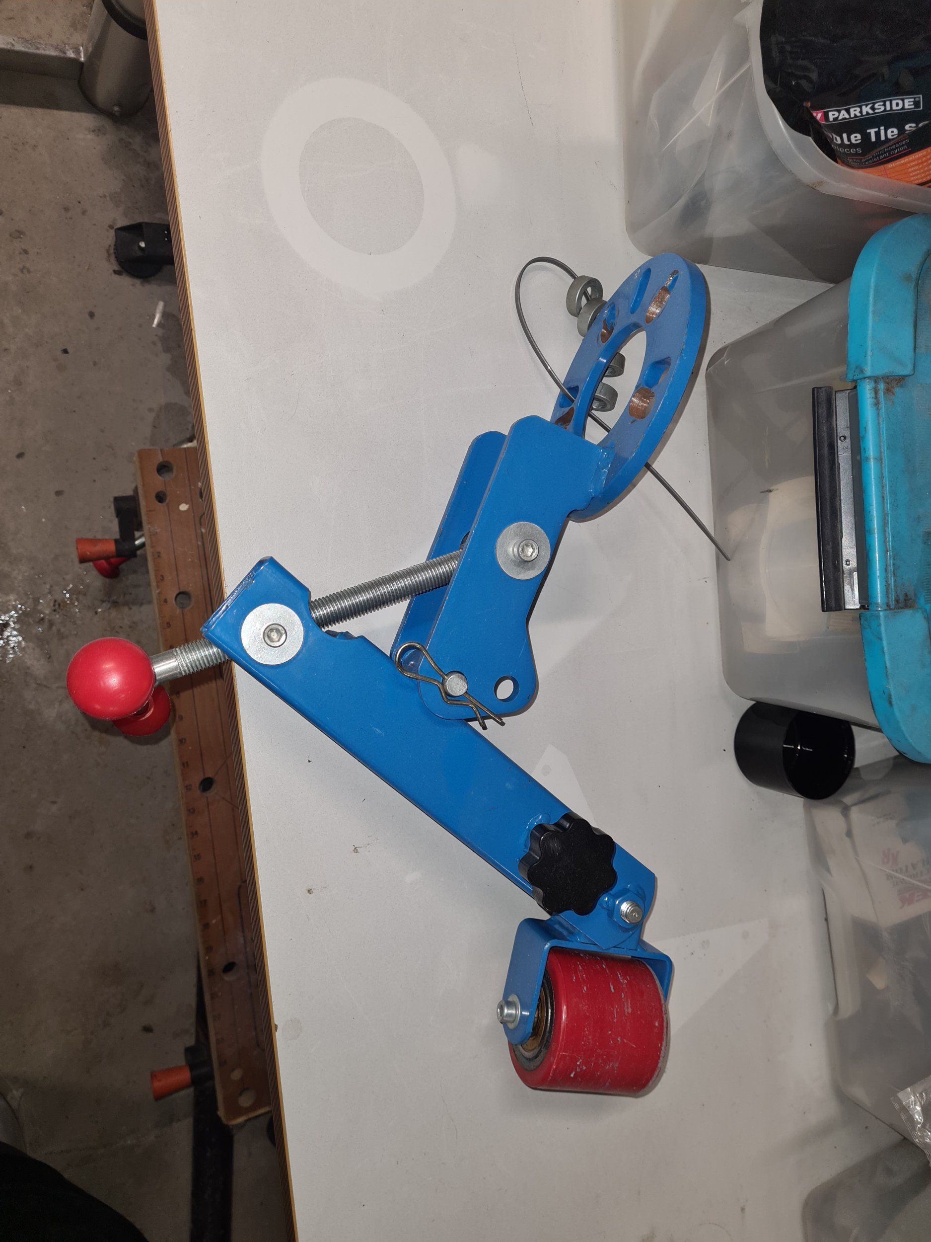

Looks a nice piece of kit. Ive seen a few home made rollers over the years but never a genuine manufactured item.
