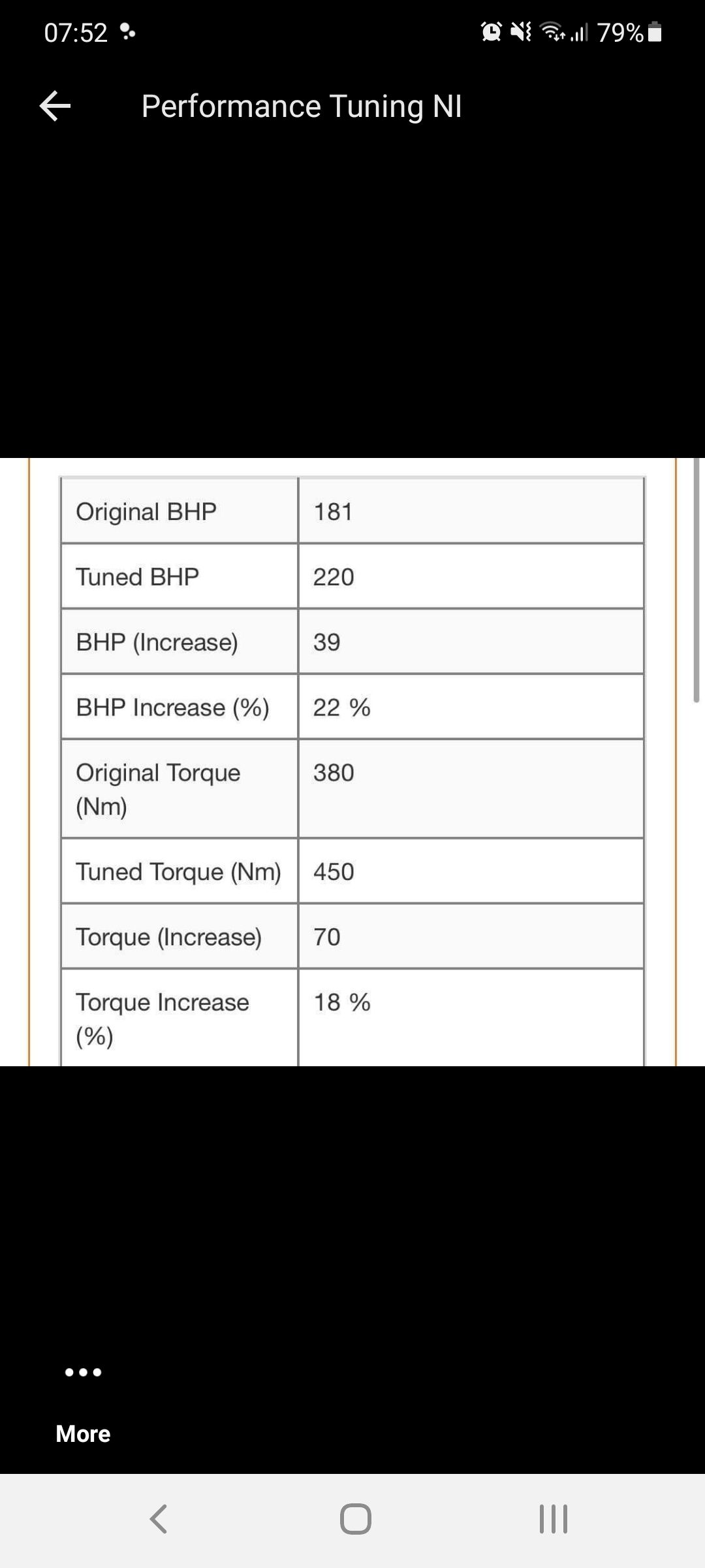

Basically I think my main concern is - will stage 1 remap allow it to still run OK with its factory parts? As its only around 40 months old with 29k miles? Or am I getting a potentially very expensive modification done here that's gonna cause many headaches over the next 1-2 years?
Screenshot below of expected gains

It's not so much that, it was more the case that the stock turbo and fuel pump can't be pushed much harder before they start running out of headroom. Like Wayne said though, probably worth letting them getting it onto a rolling road and sorting out and optimising the mapping. I'm sure they could make some decent improvements, just not a ton of extra power as such.

The 184 TDI is quite a torque restricted engine as stock and the torque curve improves well with a remap, not so good for max power which is limited by the air flowing capability of the smaller efficient turbo and cross flow cylinder head design - again done for emissions and efficiency.
So it would 'feel' faster due to the large increase in torque which means gear selection is less important - but probably not much quicker against a stop watch.
For ANY remap/tuning on this engine I would be asking the tuner questions on how it effects the life of the DPF - very expensive part if it needs replacing.

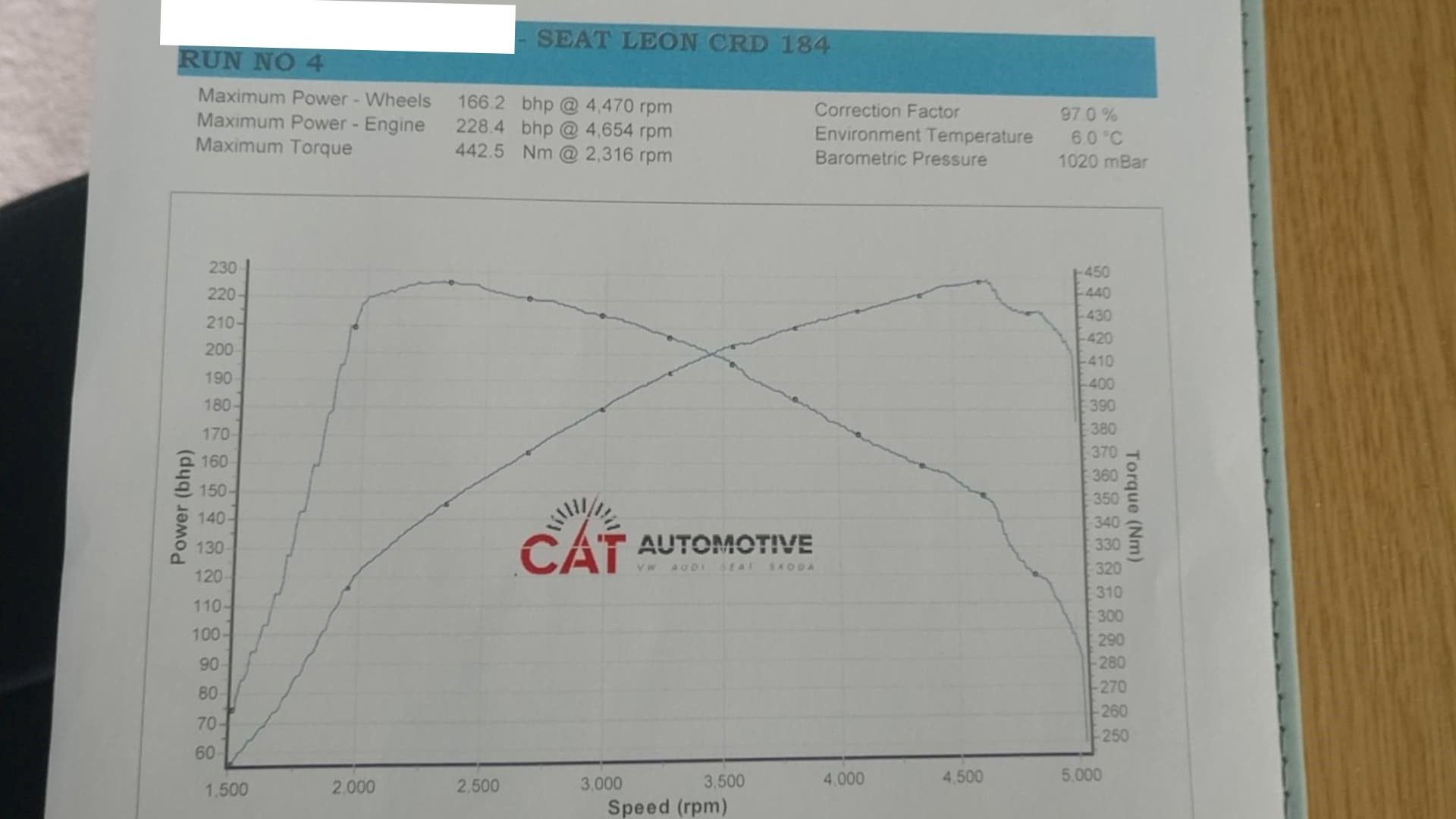

Was this a reputable tuner or a backstreet garage? This is a revo stage 1 if anyone interested in the graph.

Unsure what that graph represents lol... Like I said I've no clue about this stuff and just wanted a bit of extra power without the cost of changing to a cupra/golf R.
