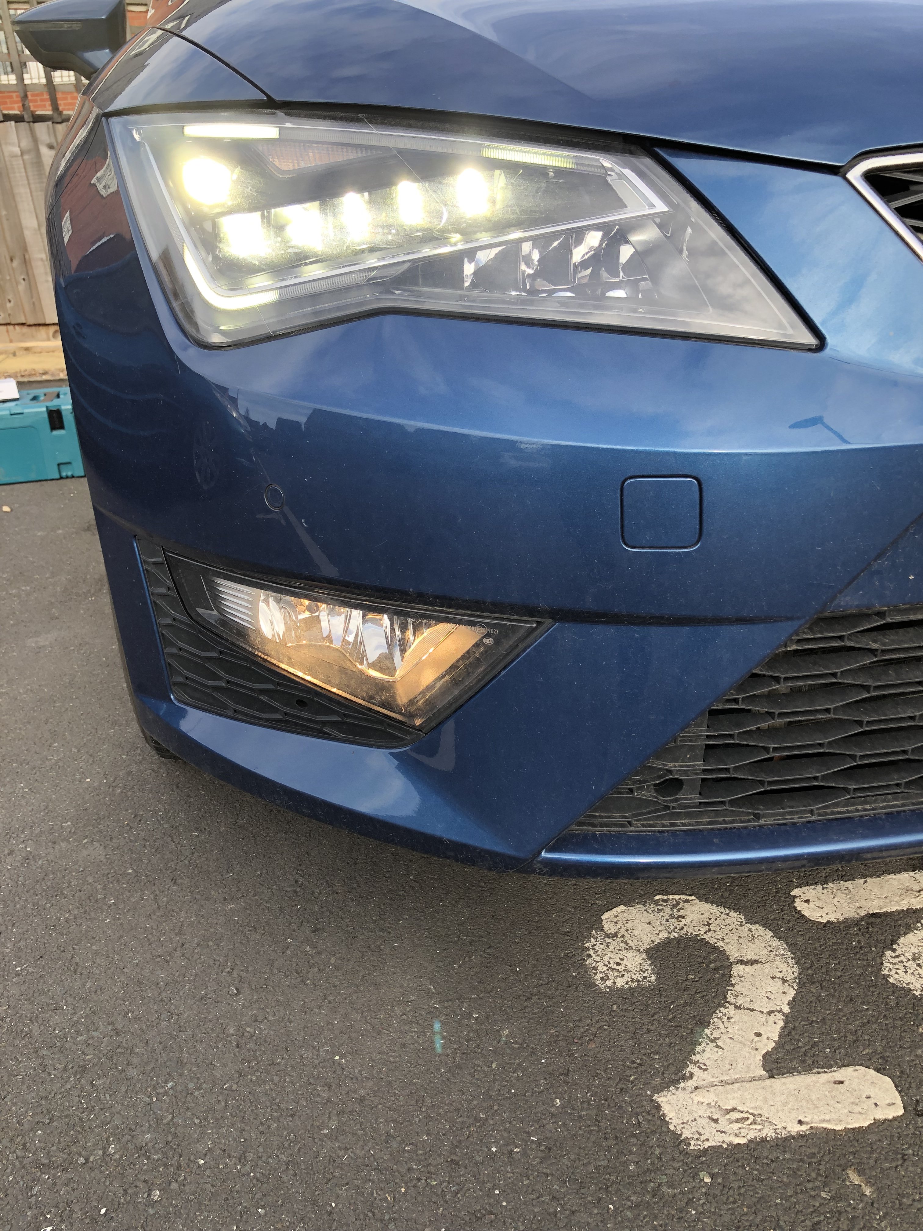

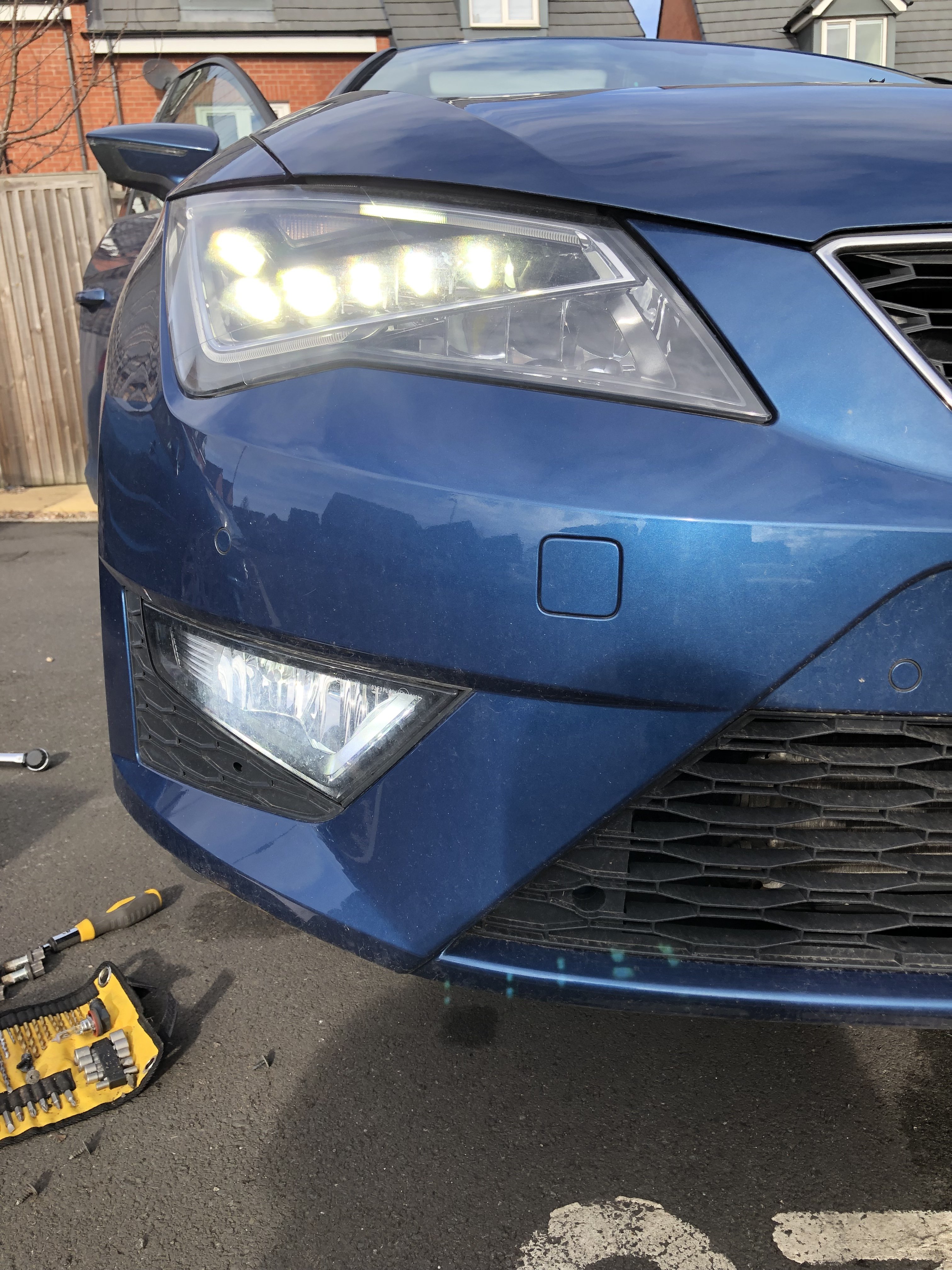

Ash82
Aug 19, 2018
148
37
Manchester
Reactions: Spuddy01

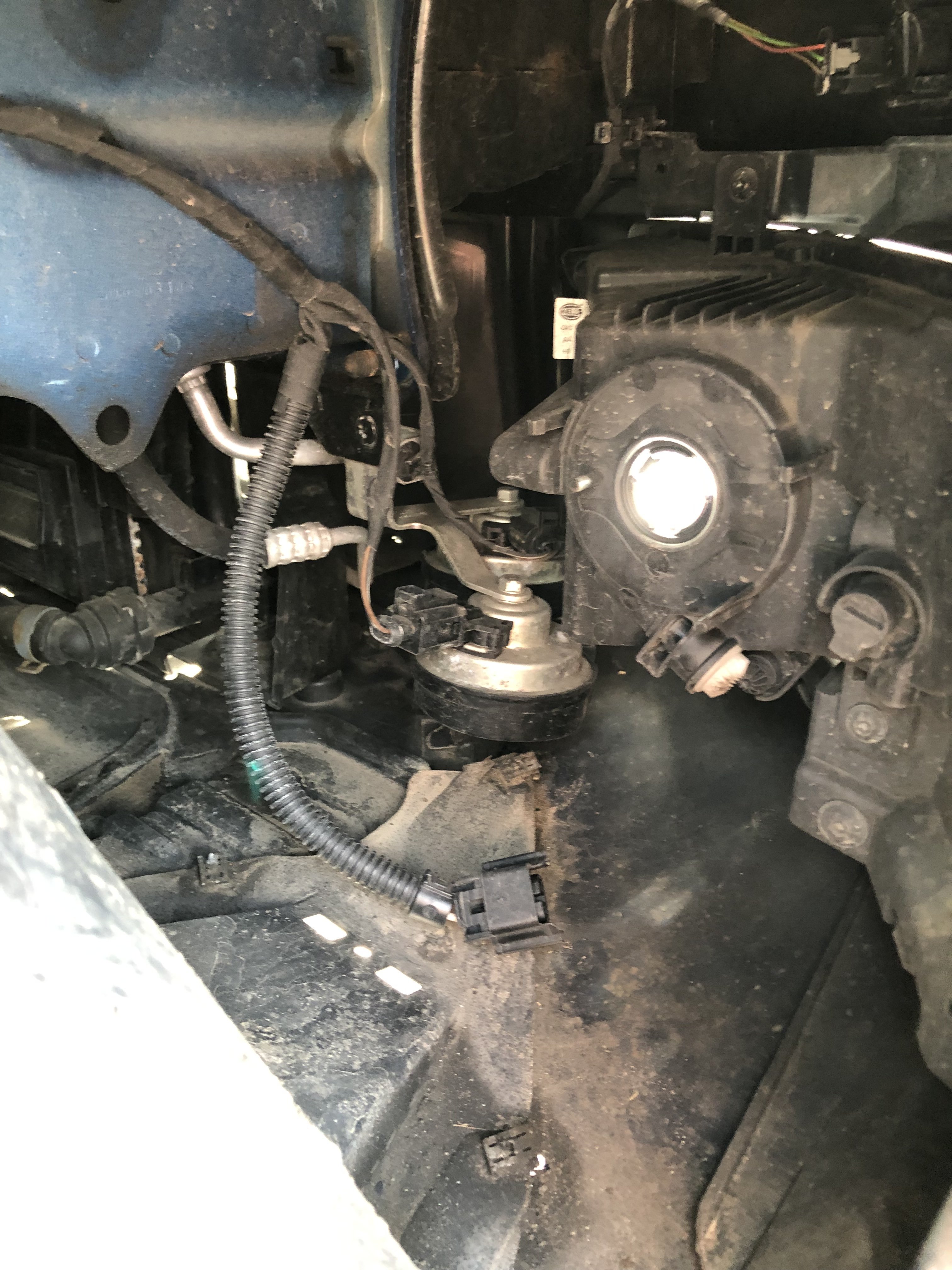

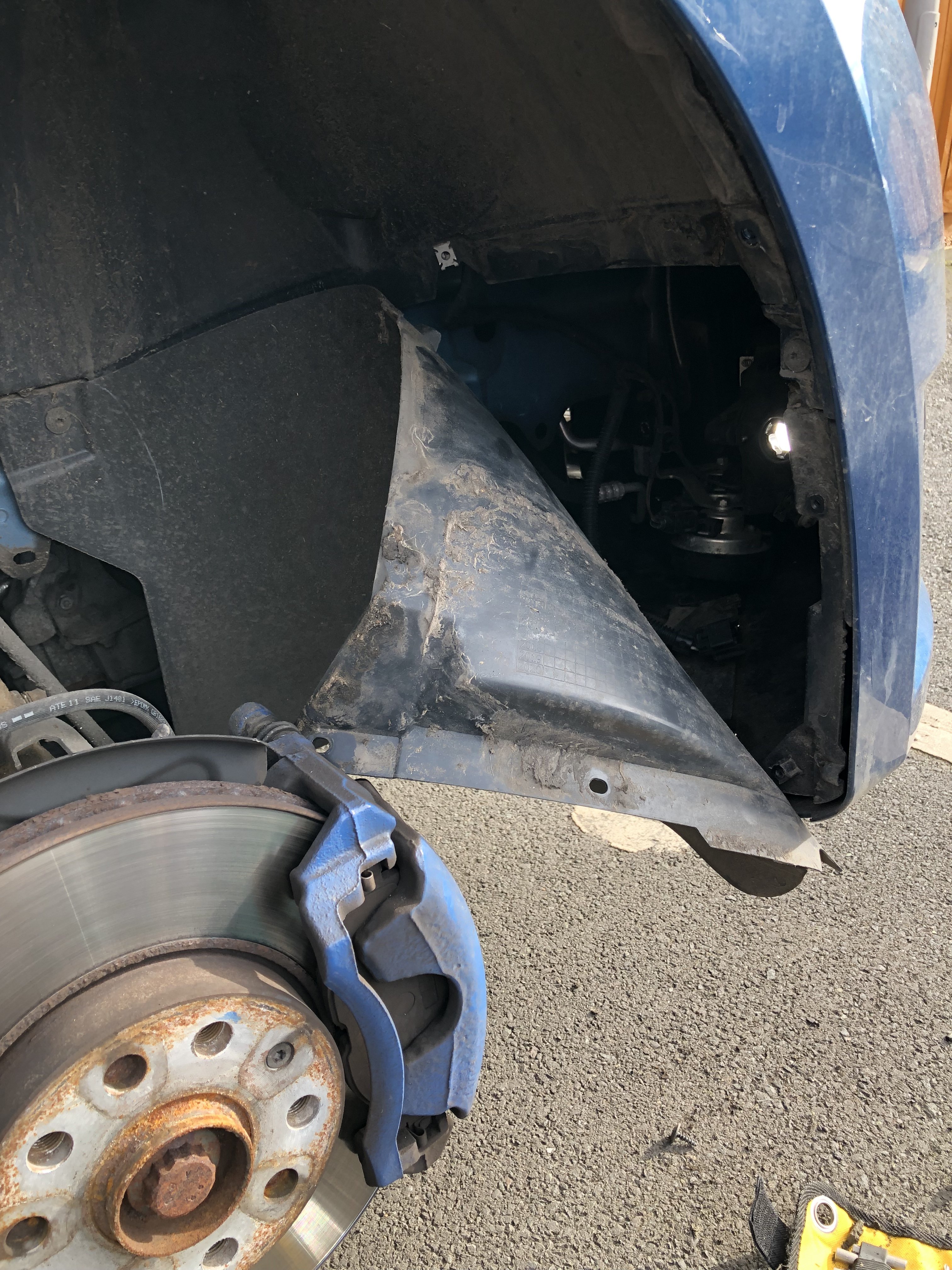

Spuddy01
Aug 30, 2018
20
10
Upgrade mine now , they look brill I will take a picture in the dark. Getting around the water tank was a problem , I had the remove the arch casing but I was taking off my winter tyres anyway
Looks like a bit of work involved would you say it's easier to remove the wheels to get the bulbs in?
