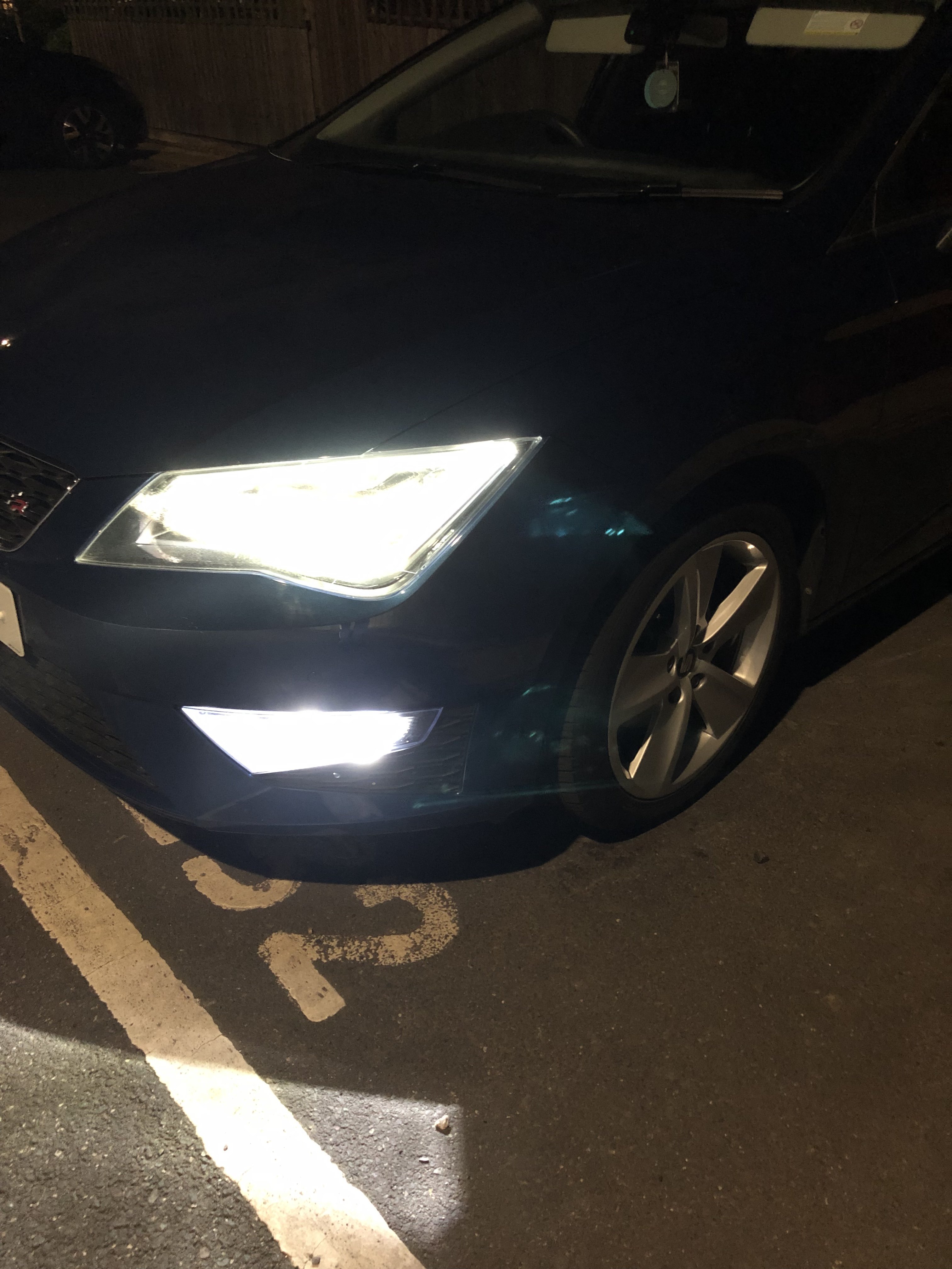

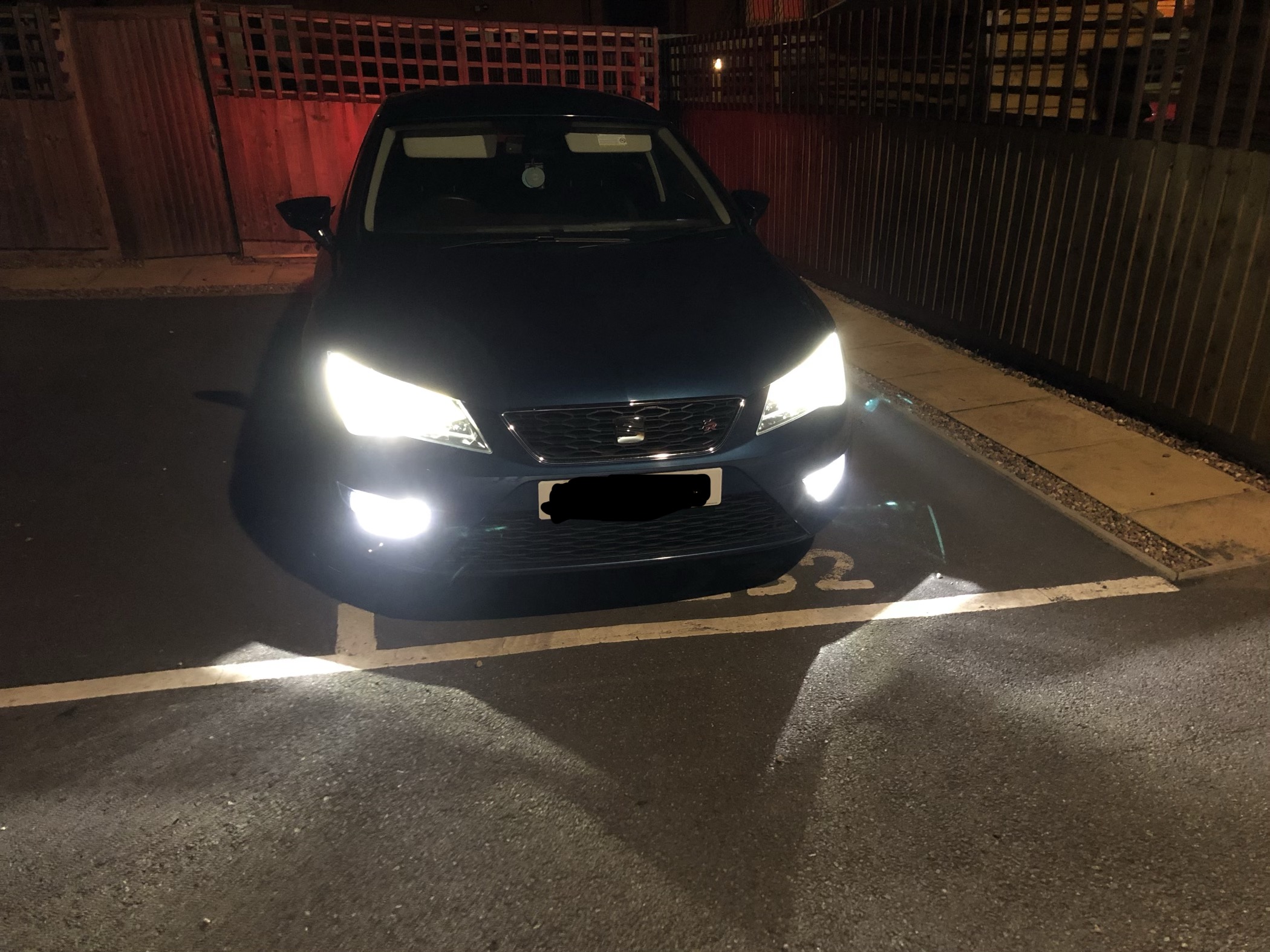

Here are the bulbs installed on my car ! They finish it off perfect

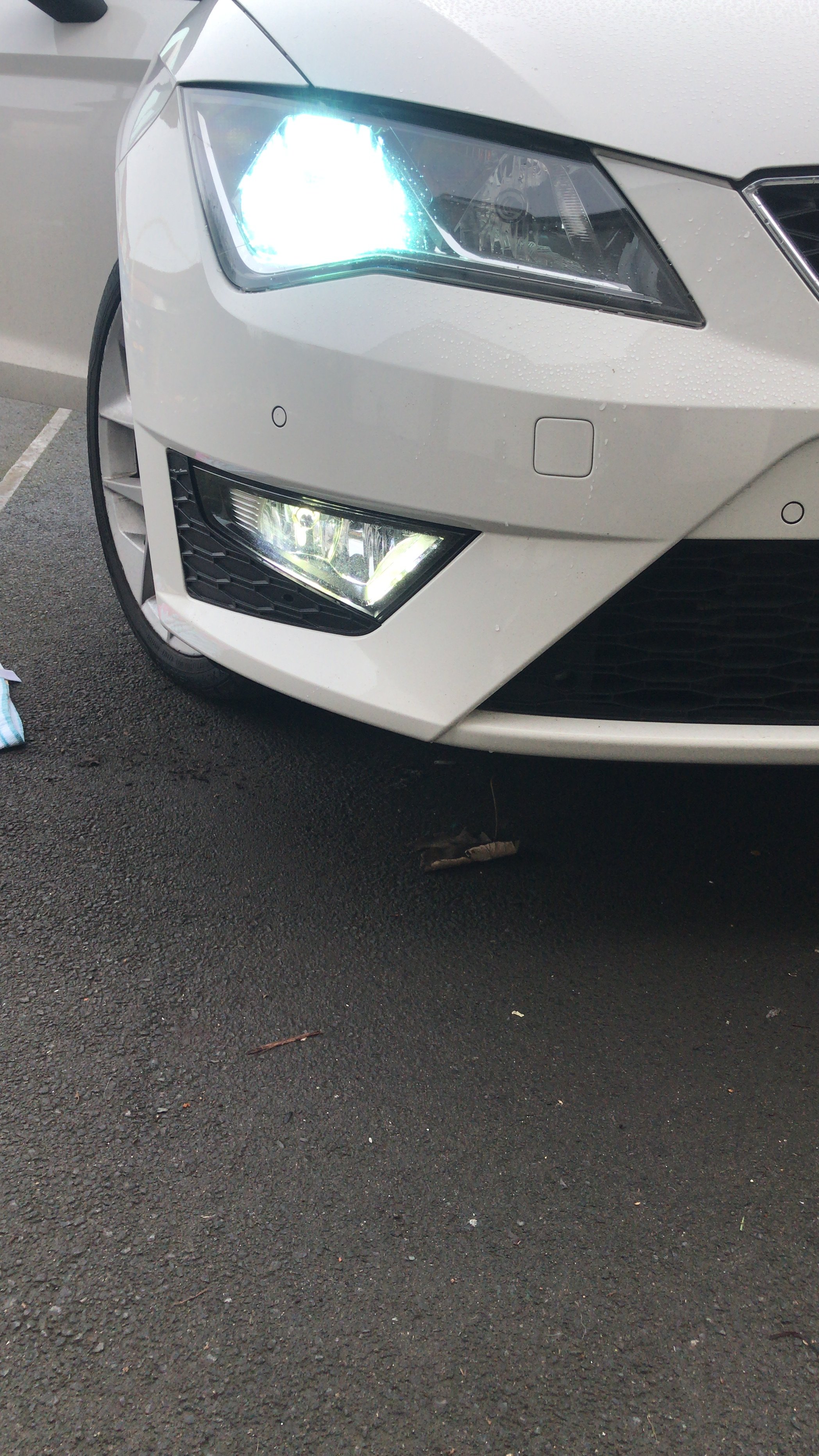

Managed to get both bulbs in but passenger was a nightmare to get behind water bottle but not impossible
I used h8 led bulbs
