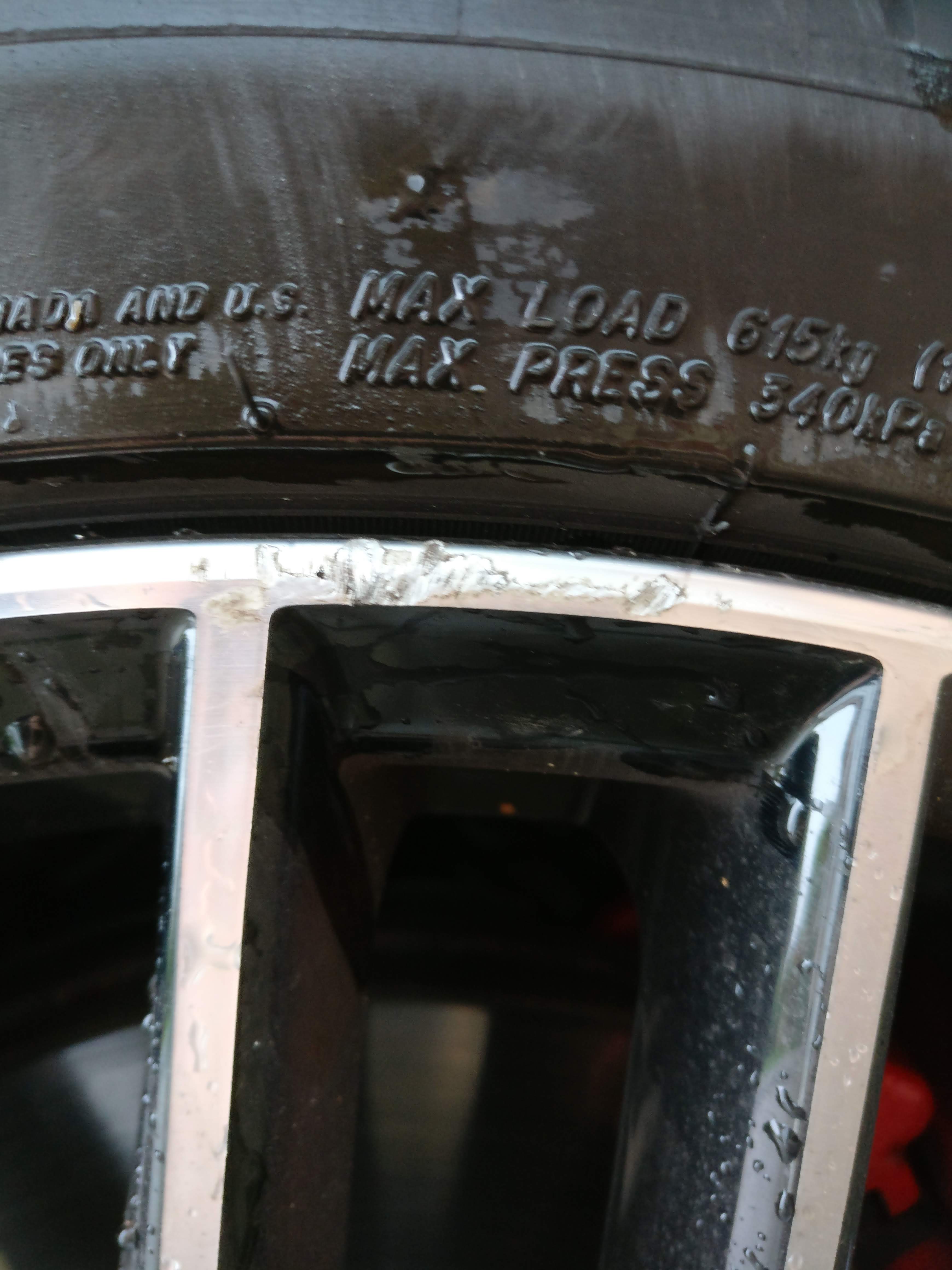

Did this this morning on the way to Park run, I knew the rain was a sign I should have stayed in bed. So gutted, just a split second of impatience in a car park is going to cost me.
Looking for decent wheel repair in south Leicestershire now anyone know any where? People have recommended wheel specialist, their site quoted £150 for a 19" diamond cut wheel. I'll give them a ring instead.
That's easily repairable with some polishing stones and clear lacquer, I damaged the same area but longer and you couldn't tell after
Really? Sounds like the kind of thing where I'd end up making it worse Do you have links to the materials you used? I've never used polishing stones, is it hand polished? What lacquer?

I got them from work unfortunately, it's really easy to do, you just need a few in different grades starting with the roughest working down the smoothest, as for the lacquer I just used the one that came with the touch up pen for the paint on the car, £10 max I'd say
because there are 2 faces on the lip there is only 2 ways 2 to get the double profile back, either fill it and blow a little silver paint in (quite effective as well) or have it welded/diamond cut and then refinished. if you simply flat it down through various grades you won't get that double profile back.
these are not the easiest of wheels to keep mint, I dread the day if I ever kerb one of my copper R wheels! I just avoid parking next to kerbs or park on them.

Plus is by some miracle you did make it worse you could just get the refurb done anyways
I'd love to know more about the technique, you might think it's dead straight forward . What polishing stone? I've never used them before.
