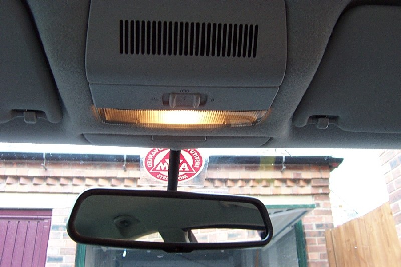

Amm...I didn't know there were Leon models without an alarm! :blink: Let me connect my VCDS to see if there is a feature in the 09 Central Electric module. Also, if you connect the cable, you should see an alar Module..
Anyway, the volumetric sensors are installed on the little plastic grill on the top console where the sonroof controls are:

I checked and I do have the plastic grill on the top console. But could that just be an empty plastic housing? (with no actual sensors inside?)
