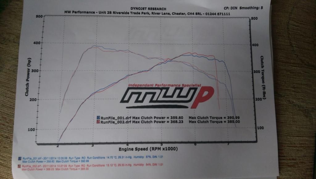

I've found this on the golfmk5 forum whilst doing some research, haven't found anything that compares the pressure drop on them though
