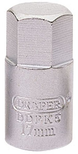

Also dont think i have an allen key that big, would this do the trick?
http://www.amazon.co.uk/Cars-Draper-38323-Drain-Plug-17mm/dp/B0001K9U28
Cheers

Yeh but it must have the hole in the middle, some don't have it, just get that one of ebay
