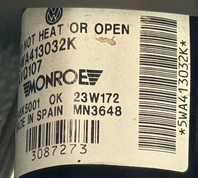

My Formentor is made in 05.2023 and have Monroe shock absorbers 5WA413032K, AVQ107, E46K5001, 23W172. Same DCC shock absorbers are used in Golf 8 R and they also make that same clunk noise. But some cars do not clunk or maybe the owners just can't hear it.
