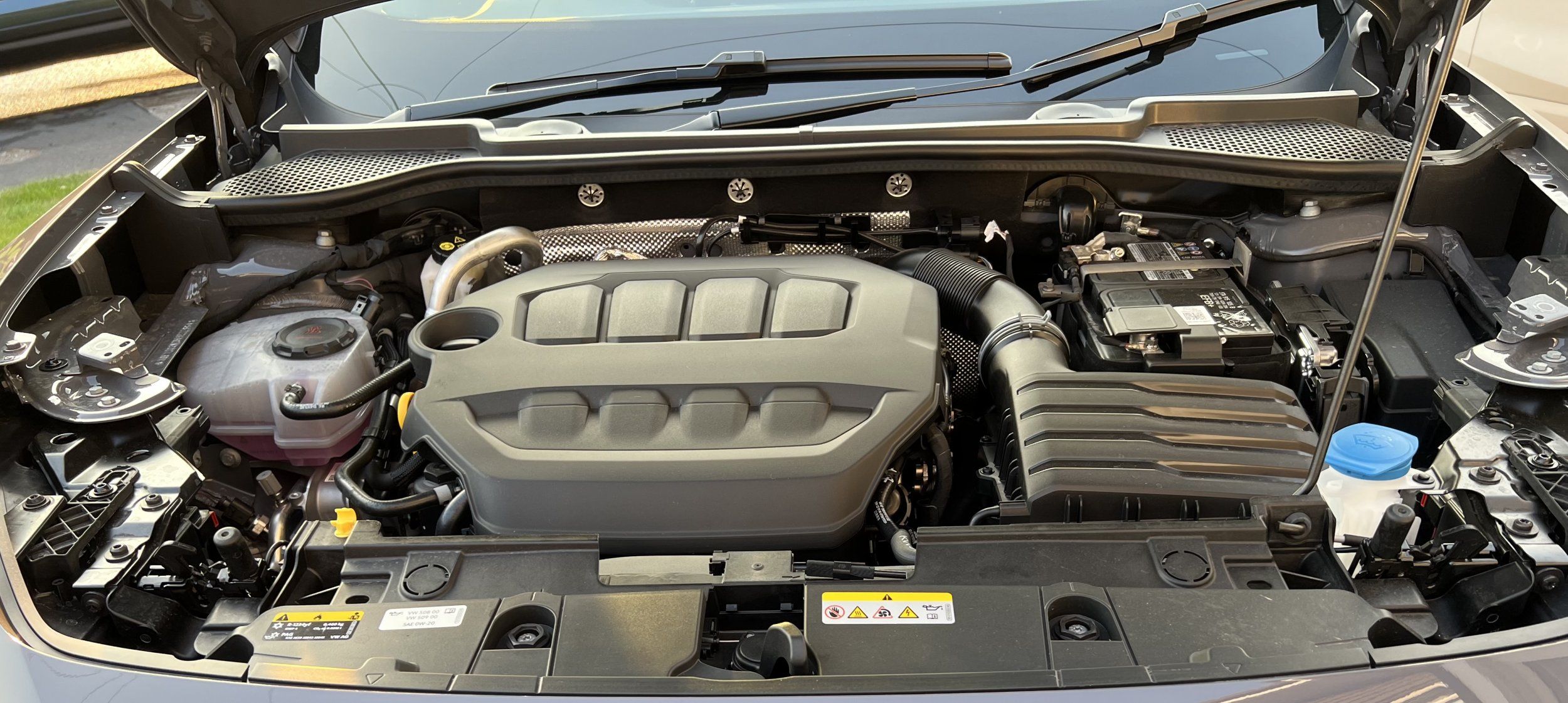

Picked up my new Formentor 190 V2 today and having a poke around when I got home lifted the bonnet and was shocked to see…an engine cover!
Are they providing new covers now? Mine was PDI’d end of June but not sure on its build date. Is the 2.0 190 affected by this problem?

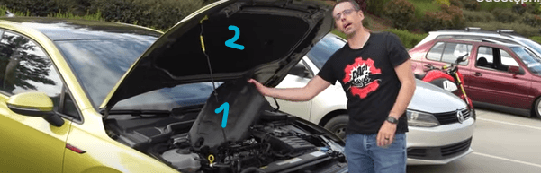

Let's just be clear the recall is on the plastic cover having only eye-pleasing function, anyone missing actual sound insulation cover under the bonnet is definitely dealing with different problem!
aguy
Jul 6, 2021
35
12
this guy is holding the engine cover, which is being taken by the dealer, where number 2 is attached to the bonnet and acting as a sound deadening material.

No.1 is the actual engine cover which is identical to the ones removed and serves also mainly as a sound deadener, this piece is abt 5 cm thick and made of thick/dense foam material, its quite flexible that's why it comes undone easily as they say, its not the usual thinner abs plastic engine cover we are used to see on most cars, even on my previous Q3. The no. 2 hood sound deadener is still on all Formentors, or so I think as it is on my 310.

I wonder if mine is a new one then. I’ll try and grab a part number off it shortly.

Part number on mine, 06Q 103 925 L
Edit: Just seen on the VWROC forum that the new cover has white plastic inserts. I didn’t pay that close attention so will have another look, but I think you might be able to see one in the above photo.
My part number certainly lines up with the new part number posted on VWROC.
